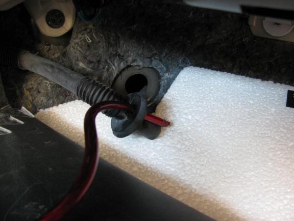

I drilled a hole in the rubber grommet and then angle cut the wire and put a little grease on it to help get it through the hole.  Very snug and does not impact the vent tube.
