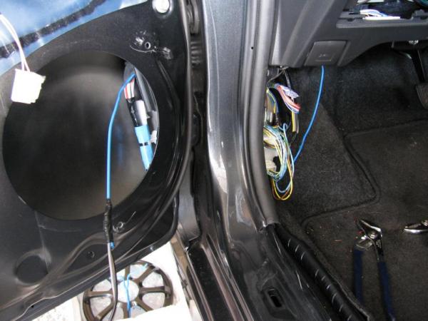

Coat hanger with speaker wire taped to it.  This one failed.  Re-tapped and applied some Vasoline - success!
