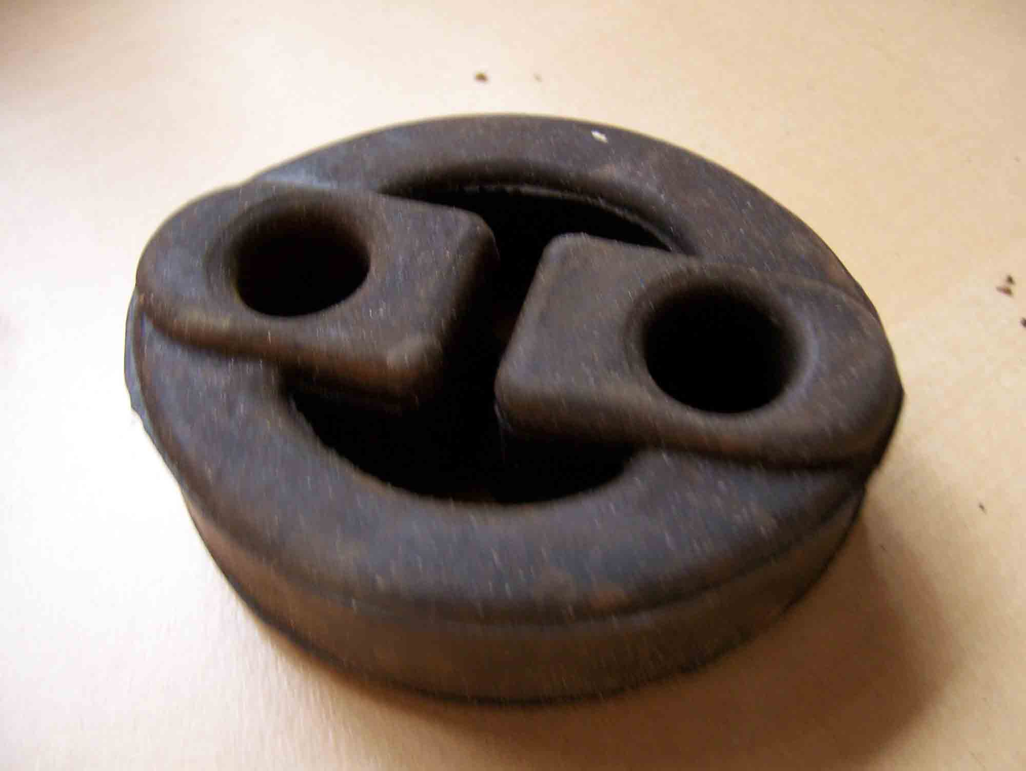

Old 10-27-2008, 02:21 PM   #4
By the muffler, bent shape like a "s" or "l" with a rubber stopper/grommet on the end between both of them. can't miss it if you look under the rear.

+1 on rubber grommet ...
this could have came loose or tore . This stretches so exhaust can move some with the road conditions ( bumps , etc. ) . It slips on two metal rods , 1 attached ( welded ) to undercarriage and the other welded to muffler itself . This was an issue with our 2000 Chevy PRIZM ( Corolla ) . Overtime the rubber grommmet weakens from the elements and stretches from the torture of pour roads . The grommet had weakened so much that the muffler would move up and down from rough surfaces or bumps , thus the tailpipe would hit on the rear plastic bumper . To test this , grab tailpipe and move up and down to see the play in it , if hits the bumper , that could be the culprit . This is a very expensive item , think I was quoted at about $150 ! So , we decided to just deal with it . GOOD LUCK

ROFL the rubber gromet cost 150?!?! YOu can buy it a kragens for like 15 dollars. Or any other parts store.
through CHEVY or TOYOTA parts department . I don't believe this part is available at your KRAGENS , A.A.P. , PEPBOYS , etc.. It's not very common part .
Its a universal part. You dont ahve to get a exact dealer part. Or you could go to any muffler shop they have all different sorts. I changed one on a ford mustang The guy brough his own part he got it at kragens for like 8 bucks. Didnt look like th eone that broke but it worked.
Are you thinking of the same part?
Should be something similar to that. Its really cheap to obtain.

Posts: 643
same part , as above . Maybe they were trying to screw me . Just trying to help . Seems like a majority of TOYOTA employees have crappy attitudes as well . Is that part of the crudentials ? Or do you get training for that ? Just called CHEVY parts department and the rubber grommet costs $52 and the brackets are $99 , so apparently the parts person a few years back was trying to sell both parts which would be > $150 with tax . They are special order items .
