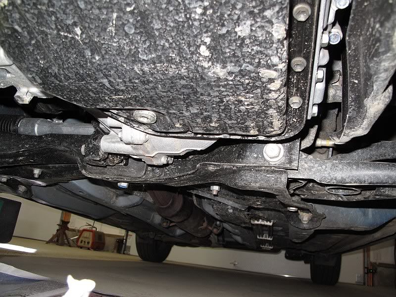

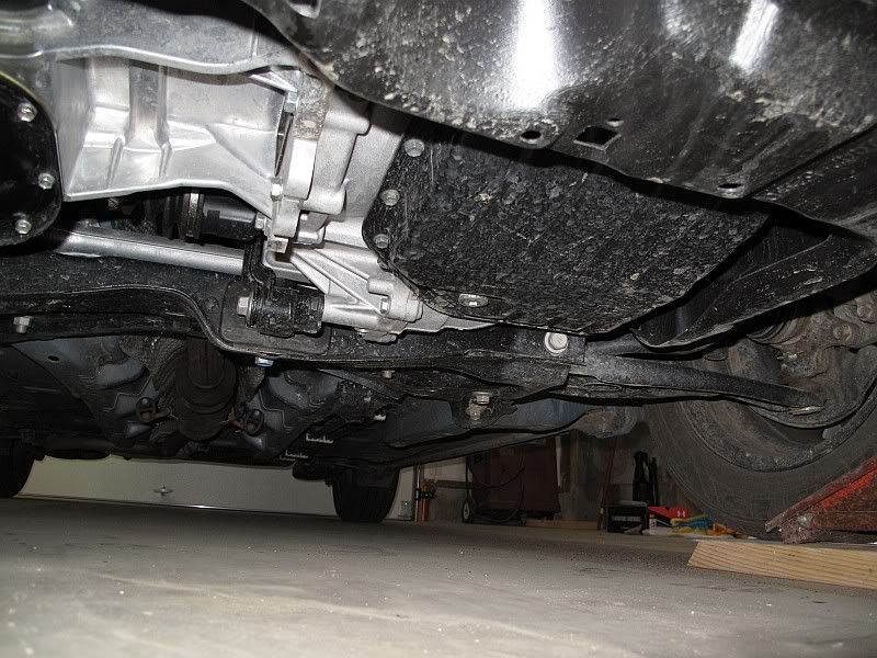

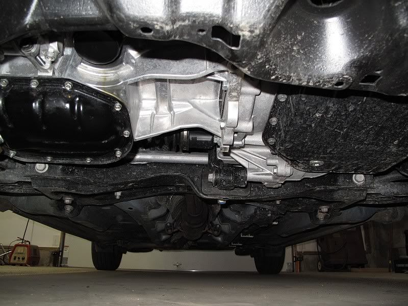

CTScott
ULTIMATE
CTScott's Avatar
Drives: 09 5dr LB, 2x 08 3dr LB
Location: USA, CT
Posts: 13,460
Here you go - I took some while I was changing the oil this past weekend...
The salt spray makes it a little difficult to see the details, but hopefully it helps...
CTScott is offline   Reply With Quote
Old 02-18-2009, 04:02 PM   #11
detroiter
detroiter's Avatar
Drives: 2008 Polar White LB Auto
Location: Metro Detroit
Posts: 1,238
It definately helps, ALOT. Thanks for the picture. Like my assumption was, my trans pan is totally caved in, upwards :( That black plastic shield under the car that is just in front of the pans...that things completely gone lol.
It's not leaking any fluid and the trans is still shifting fine, plus no cels so I'm just going to leave it alone until spring or I can spend the $80 for a new trans pan and gasket.
Thanks again for everyones help.
