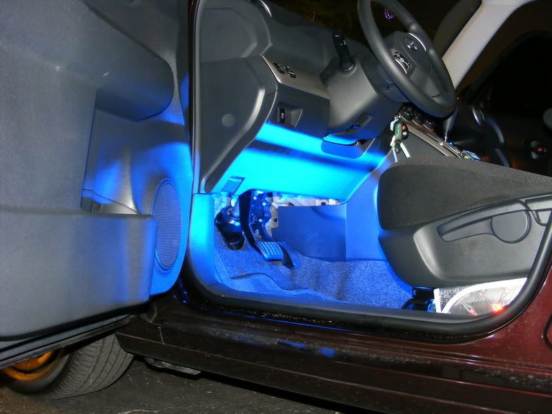

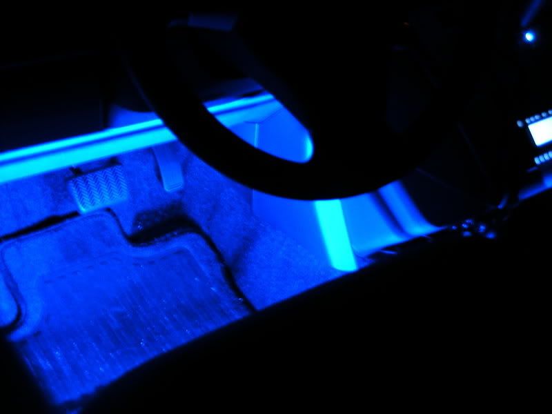

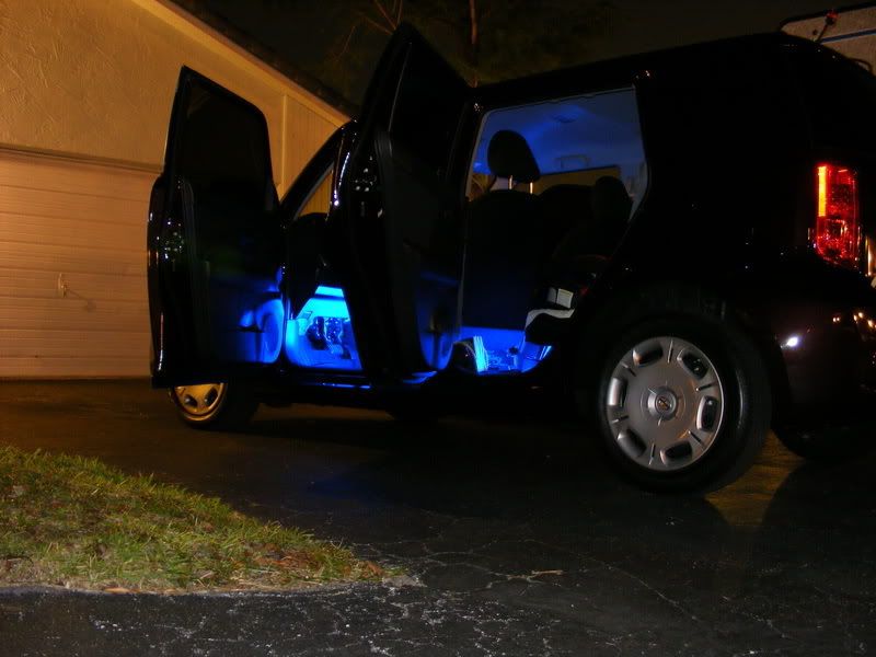

I will be doing something similar to my Yaris soon. This is my wifes 2008 xB:
I will be doing Red in my Black Sand Pearl Sedan......
I used the following kit:
http://www.ledunderbody.com/led_inte...underdash.aspx

The best way to mount the LED's is to use the clips that come with the kit, line them up and make sure they fit properly first. Then clean the area with the wipes that come with the kit.
I then added tie-wraps to hold the clips in place, just in case.
With the seats being similar to the XB, this is easy. Just mount the LED's under the seats using one the the bars under the seat (like the bar that allows the seats to move forward and back).
