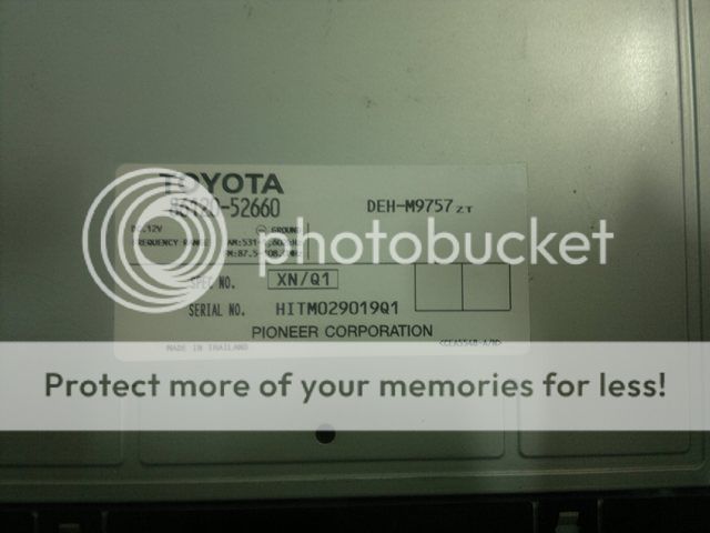

This is my deck so I'm not even sure how I would go about upgrading it.
That and the cost is the only reason I would want to stay away from upgrading the deck and I don't mind the bluetooth dongle that much.
http://home.comcast.net/~srobertsfsj/Yaris/Yaris4.jpg
I also double checked and have 6.5 speakers in the door and 6x9 speakers behind the back headrests
