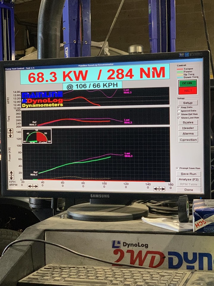

I've installed some innermotive (JUN Replica) cams and springs and it pretty much made the same power. My thinking is the (blitz) supercharger is only limited on what it can put out on top end? I have to find my original dyno paper to compare the curve..maybe it has more mid range. Maybe the supercharger is tired? It has always made around 5psi. Pretty disappointed nonetheless. Here is a pic of the little nugget!

looking at your AFR the car is stinky lean.......we shoot for about 11.2-11.5
I think your car is retarding the timing because it's too lean.........
and maybe I'm doing the conversion wrong but 284nm works out to be 209 ft/lbs of torque, I don't think this is possible with our setup........
