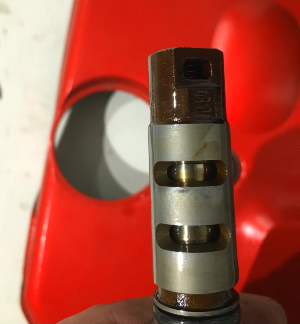

Was reading the "all motor yaris" post and read about the different vvti solenoid valves and maf sensors. The standard 1nzfe Solenoid valve turns vvti on at 4000rpm but the RS solenoid turns it on at 2500rpm (The thread said it was confirmed by tuner on the dyno)
So being in nz I whipped out to the wreckers and took one off a 2009 90k km crashed RS. $120 nzd later and these little mods are adding up!
Rs Mark 2/3 solenoid
Turns out I already had the "C" labeled maf sensor but the new one looked cleaner so that got installed too. Car should be happy as after the ecu reset. Will test it over the next few days to see if i notice the vvti kicking in earlier.
Another day another mod! I think im kinda addicted to looking for yaris parts at this point.

Yes they are completly different units, the thai people do this to any 1nz-fe they hot up as a base upgrade, same with the C maf sensor and the coil packs from the RS also which are beefer apparently. Check out the hole in the end, beefer last slot and also how the oil flows around it, it has a step down to allow it. This is way different.
I could nab more if needed theres a few more RS motors around.

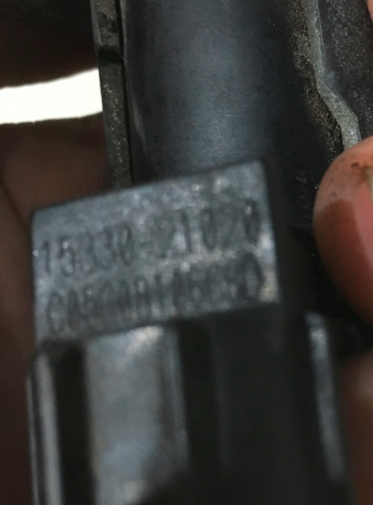

see if you can get us part numbers from both the maf and the vvt....im sure shipping to the states would make it cheeper "new" but i need some part numbers to verify what im hunting for
knowing toyota.....id bet that vvt unit is probably used on something else? ditto for the maf
part numbers i need part numbers!!!!!

I will get you guys the parts numbers in the morning with the light, been busy during the day and forgot to when I installed them.

Got the numbers for you and its 15330-21020 for the solenoid, so appears some of your USA motors got this one. ( I just researched and USA were sold the RS yaris, which came with this solenoid, thats why you have it listed in usdm)
maf sensor number is "c" 22204-22010

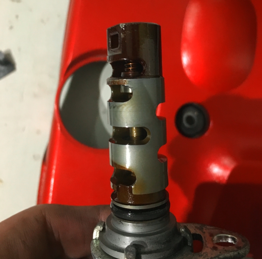

And just looking at it, its going to have a LOT more oil flow to the vvti assembly, I just looked up that stock european one and and it only has two small slots, so way less oil flow.
Considering the vvti assembly is a known failure point for the engines I think I like the idea of more oil flow, as for performance is does feel like vvti is coming on sooner.

Check out this on the after market "rs" one, it has a peg to turn it in the housing. The real RS one has that step down on the side so that angle would not matter and is essentially ported.
The Non rs ones have sometimes only 2 holes for the euro one.
Now this is how it works, So we are compltetly changing the oil flow to the vvti and the vvti unit is operated by oil pressure, so just looking at the viens and step down this would drastically increase the oil flow and you would think allow for great control of the timing??.
This rs solenoid increases the oil flow too and from the VVTI cam unit allowing it to change the timing faster on the fly, thats what the step down is for, just to increase flow out of and into the unit, this design is all about increases flow rate so the VVTI can react quicker. The tuner has said the vvti was responging better and thats what it feels like, this is for sure an upgrade.
PS: don't get a cheap one, get a real one I will change the link to the correct one with step down for flow. I have looked tho only RS ones have the step down. This is genuine toyota RS only, this is why the Thai guys said only rs.

You will have to learn Thai and join their forums all I was going off the e85 all motor post from this forum where they have dyno tuned a 1nzfe with a few mods. https://yarisworld.com/forums/showthread.php?t=55835
But I just looked up other toyota "performance" engine variants and they have the same design for example here is the 2zz-ge's unit. It also has the step down and the extra outlet holes.
