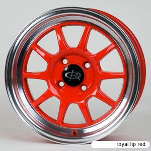

Do you guys think the offset of these rims are good, first time ever buyinh aftermarket rims and kinda want the car to drive perfect.
This is the exact rim size also ill be gettin 16 x 7.0 +40 4h x 100
wanted to confirm what the bolt setup is also?
Thank you guys

I assume they should be fine. My old MR7 Motegis were a +40 and were 17x7, had no problems except for a lil rub at full lock...
Depends on the tires you throw on. 205/45/16 should be ok, along with 205/50/16.

I prefer a little higher offset on the Yaris to get a hint of a tuck up front, but if you don't drop the car, then 16x7, 4on100, ET40 should be just fine with 205/50's.

if you want 2 inch drop or so I say go 195/45/16

205/40's would probably work well with ET40 and that drop.

yes, would probably be fine, little less side wall than my option, I would go for more side wall on the rota's I'm sure florida roads are no better than what I'm driving on

I like a little more sidewall as well, but he states he wants to drop his car "very low", so... what do you think?

I think 195/45/16 and a 2 inch drop will be problem free
