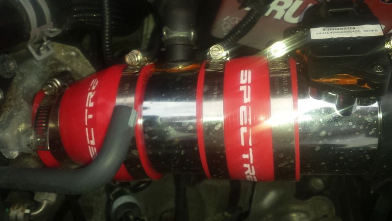

added CAI
COST FROM PEPBOY'S, CUSTOM MADE $87
seat of the pant test, good gain in pickup an hp, MPG improved.
Using a Spectre Cone filter, 6.5"w x 7.5"l
removed all stock parts except oil breather line & MAF sensor which is new.
Removed battery for 5 min to reset ECM.
Check engine light will come on if I rev it sitting still, but as of now, has not done while driving. The throttle mech seems to be almost completely electric..??
MAYBE TOO much air??

What size MAF tube did you get? Possibly i am mistaken but did you say you bought a new MAF? From the threads on here, too large a MAF tube will throw a code, that's possibly what's causing yours.
3" vs a 2.5 in I think...

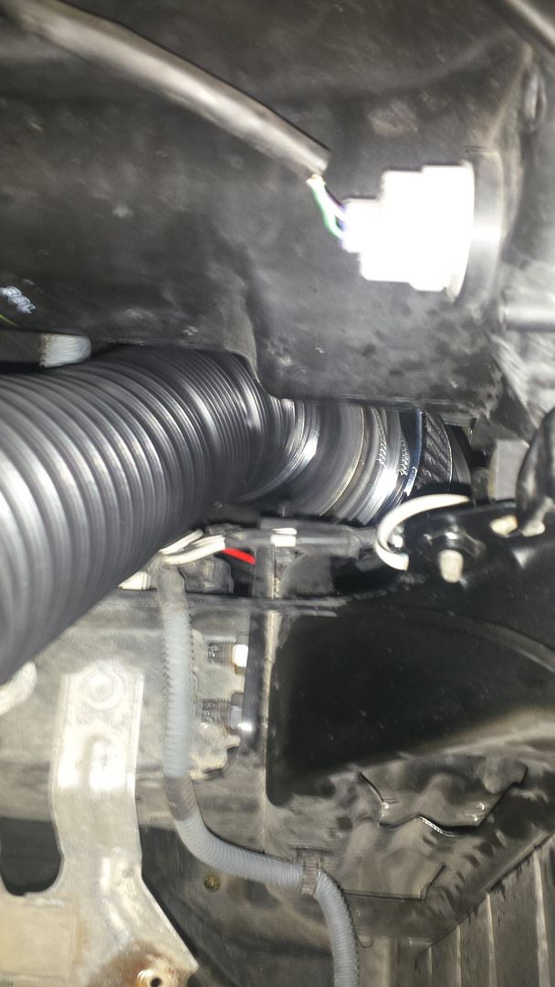

updated setup and pic...
