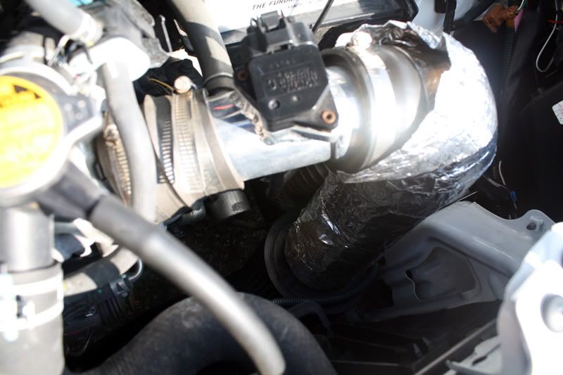

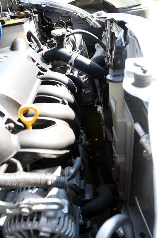

so i have been wanting to play around with with some pipe and air delivery for a while now and finally got off my butt.
end result, i run around 12-18 degrees cooler over all intake air temp
no lights
sounds like a monster
cooler temps
lots of fun :)

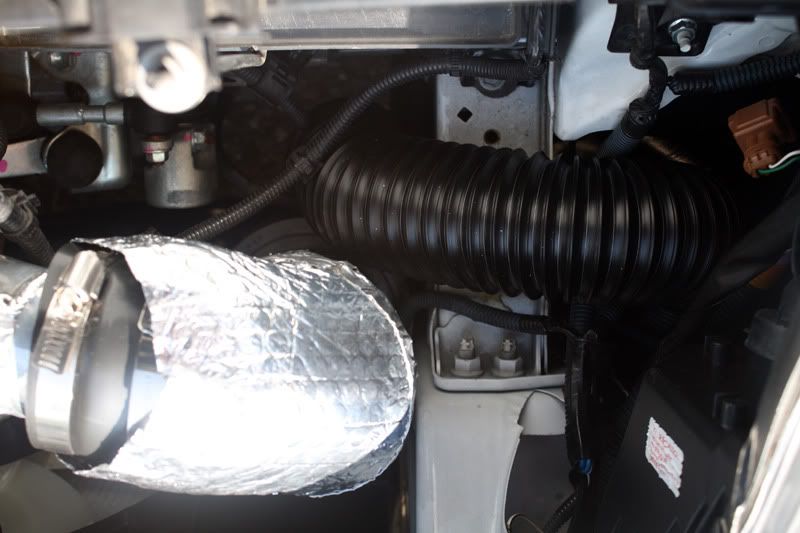

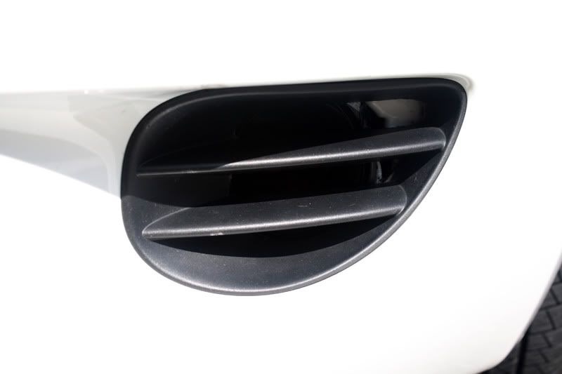

i should have gone into more detail about what i did lol
i cut out the inner slats of the fog light housing to run a flexible plastic pipe to the intake filter
i used a universal extension and bend pipe piece to run the intake downwards then insulated the intake pipe.
i want to get a hydroshield to make it complete

oh i am :)
the intake is from the ground about 1 foot up
the hydroshield is being ordered today :)
