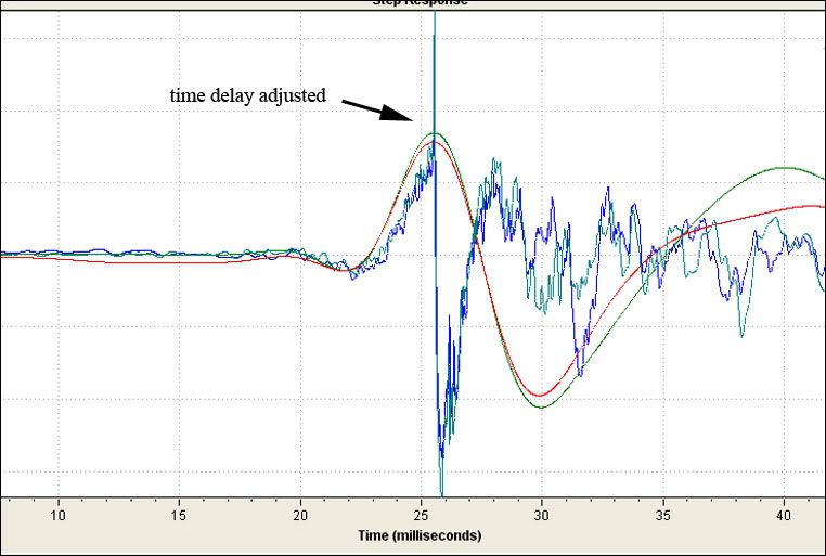

Time delay in the digital domain is the best way to adjust impulse response, but $$$$.
Phase is related to impulse response but if you only have a 0 and 180 degree switch, then it's not much help.
As mentioned before, group delay caused by badly design ported boxes are the usual culprit, sealed boxes are usually never a problem.
It can also be attributed to the type of amps used, configuration that the woofers are wired in, the impulse response of the woofer and the crossovers used.
Passive eq will also cause phase shifts and can play havoc with crossover points.
Below is a pic of a mate's impulse response, using phl mids and and 18" phl bass driver. Note the much slower impulse response of the bass driver compared to the mid and then the brilliant impulse response of the ribbon tweeter (this is a pair of active speakers for home that I helped him make).
And after correction:
But really, you need to find out what the problem is before taking steps to correct it. Whack a mic in you seat, load up REW or some other program and take measurements. It's easier than turboing a car!
