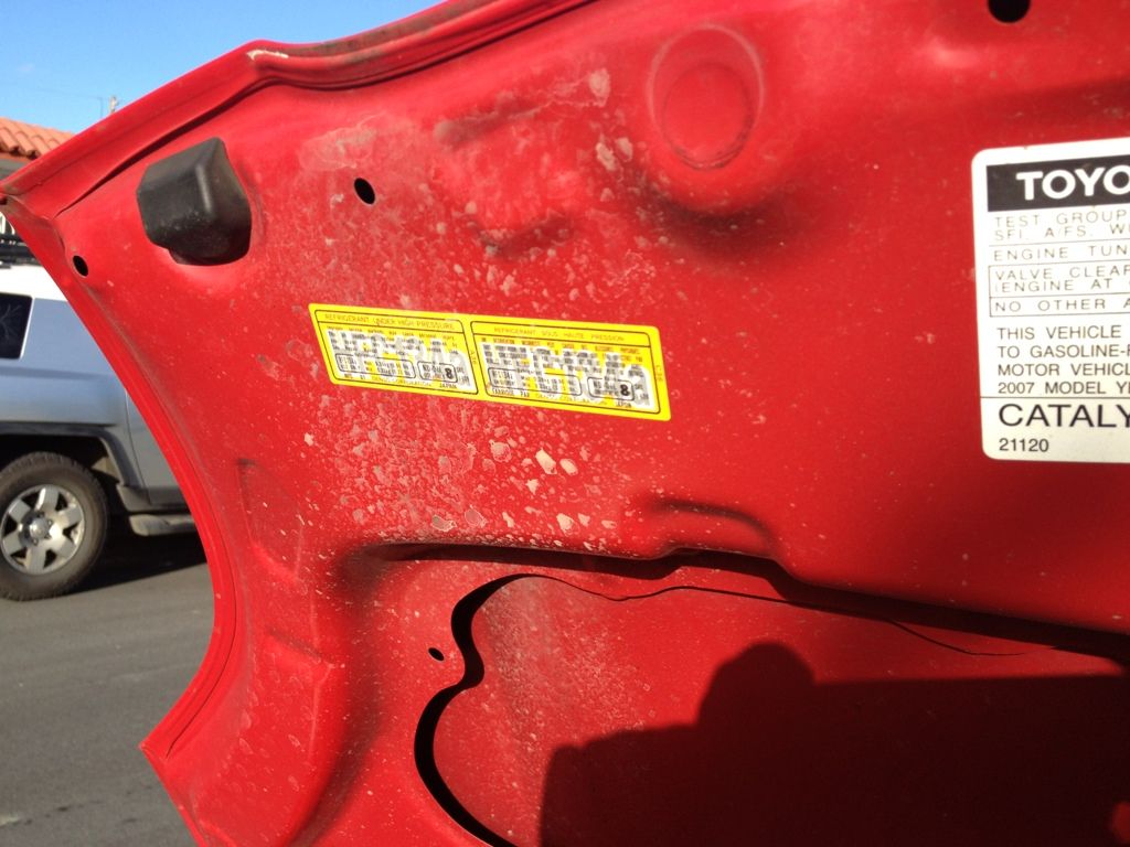

Posts: 238
I had my yaris for over a year and the coolant level never budged then all of a sudden the same thing you experienced. I talked to the dealer and no leaks or problems found-it was just a pocket that filled in. Topped it up and it never happened again. So first thing is to top it up with the proper 50/50 toyota pink coolant-dealer might do it for you for free since it won't be much. Then wipe the underside of the hood-that looks like water splash up from the road hitting your belt/pullys and flinging up under the hood. If it were coolant it would have a distinct line and be very pink. Give it a shot, the cooling system on this car has pockets-I've noticed new ones on the lot are always over full of coolant to compensate for this.

Posts: 2,897
I've been watching the coolant level dropping in the '08 sedan . Here are some pictures taken of the coolant level little over the past 6 months . The last picture of the level near the low mark , the pattern on the hood , and mileage were done this evening ( 2/27/12 ) . The black marks are where the coolant level was and all pictures were done when the coolant was cold . Thought we heard a swoosh / swish noise from the front of the car during a drive this past Sunday . Could this be the same issue ? Hope not .

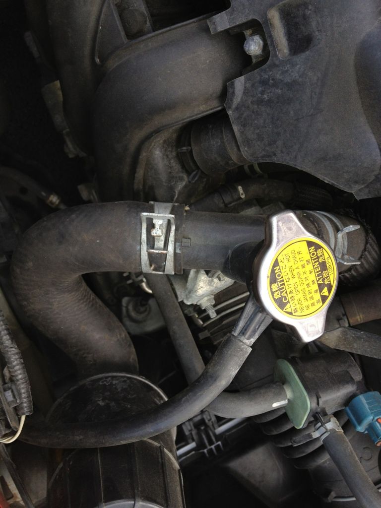

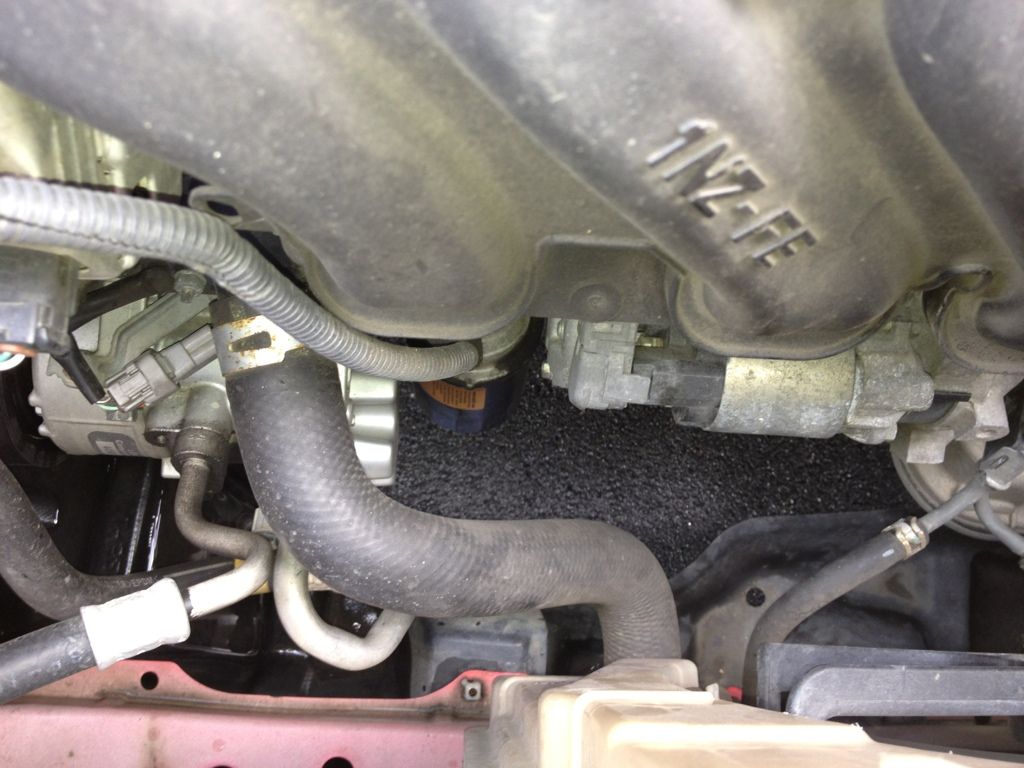

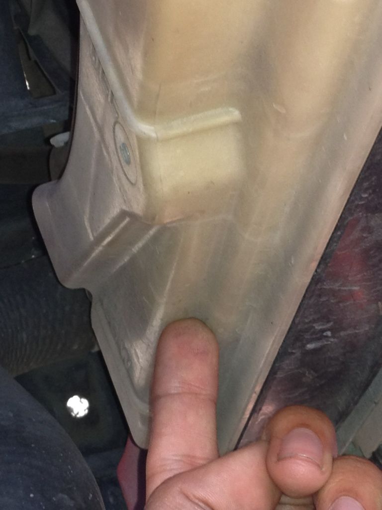

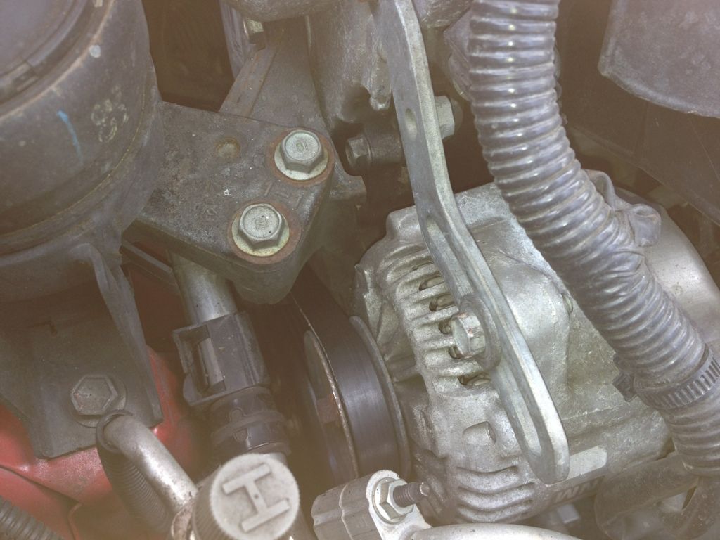

Old 02-28-2012, 10:27 AM   #10
gabriel2012
Drives: 2011 Base Sedan
Location: Puerto Rico / Miami FL
Posts: 146
Here azre a few pics I took, I cant see any of the pink stuff around the engine like in another thread I saw.
http://db.tt/QIWZ2E2 Click to signup for dropbox, and get bonous space, I do too!

Posts: 2,897
Cleaned the underside of the hood and will keep eye on it . Before / after pics .

Toyota had a batch of lousy Aisin water pumps that sometimes don't last all that long. My '08 RAV4 started leaking at 24K miles. My '08 yaris started showing signs of leakage at 66K miles-but has since stopped leaking-fingers crossed as I'm out of warranty and it will be a couple hundred dollars from a local shop. Dealer wants $319 to replace.
Anyway, I've done some research on this pump and have found that the shaft is sealed by a mechanical type seal and that "a small amount of coolant leakage is normal" Sounds strange, but the research indicates the pump can get debris in the shaft/seal ring area and leak a little bit and then clear itself. There is actually a pocket built into the pump to hold normal leakage. Only excessive weep hole leakage indicates the pump may be failing. Your pictures do not indicate any pink leakage on the pulleys. A Toyota mechanic told me it is normal for the vehicle to use some coolant from time to time-and I have read supporting evidence of this on Alldata as well.
