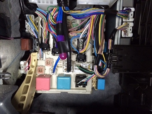

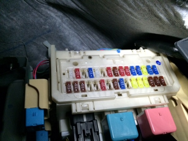

Thanks again, been looking everywhere around the fuse box, where is the JB1 fuse location actually located? My panel is fuse layout is similar to this picture but I cant find the fuse locations ACC2, WIP-S at the top.

Old 11-16-2014, 12:03 PM   #7
aeromarkuk
Drives: Yaris TR VVT-1
Join Date: Nov 2014
Location: United Kingdom
Posts: 6
aeromarkuk is offline   Reply With Quote
Old 11-16-2014, 12:03 PM   #8
aeromarkuk
Join Date: Nov 2014
Posts: 6

Can you get at the connector for the clock to measure the voltage on the wires to it?
