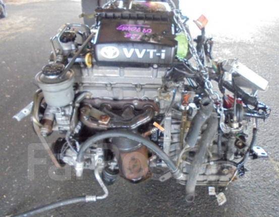

Hi! I got the check engine light with error codes P0130 (o2 sensor circuit bank1 sensor 1) and P0133 (o2 sensor slow response) So I would like to test the sensor and perhaps change it.
However, I haven't found any good info on my models engine and oxygen sensors so I'm a bit unsure where it is located. What confuses me is that most of what I found mentiones two pre- catalytic converter sensors (sensor 1) But I belive my car only has one sensor 1 and one sensor 2. Is this correct?
My VIN is JTDKV123703021353 and looking at this site: http://www.toyodiy.com/parts/q?vin=jtdkv123703021353,
my engine is model 1SZFE.
Any help is really appreciated, as well as tips on where/how I can find more information on this.

Thanks for the link! I looked at that video but that is the sensor 2, after the catalytic converter. I (think I) found that sensor, but I'm a bit unsure if the other sensor I've found is the sensor 1 bank 1 or if there is another one hidden somewhere :-)

The front oxygen sensor one is in the engine bay by the exhaust manifold towards the right side.

It looks like you have to remove the heat shield for the exhaust manifold.

Thanks for the pics! Here's how mine looks, I guess I don't have a heat shield? Anyway, It's not that hard to get to that sensor, though it is stuck really good so I'm gonna soak it in wd-40 for a day.
Also after searching the web a bit, I think this engine is a 4 cylinder single manifold motor? And that means there is only one sensor 1 and one sensor 2. (no sensor 1 bank 2) (Sorry I'm a total beginner on this car engine stuff :-) )
