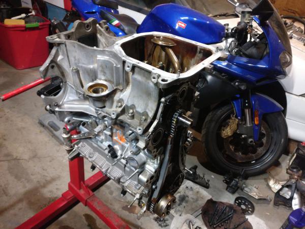

this thread is a conglomerate from my postings on other forums, one of those is basically dead, and the other is non-public. also i have taken a fair amount of info from yarisworld. so you guys may find this stuff useful. long story short, i aquired an XB with a bad engine.
put in a junkyard yaris engine that did not live long. but i got to drive it about 2 weeks.

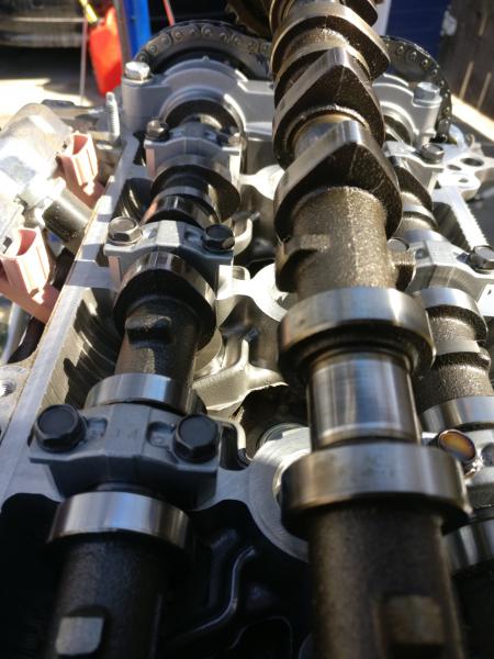

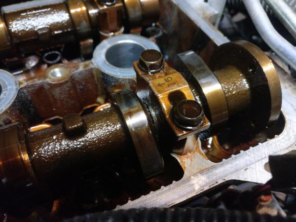

rebuilt the original engine with prius c pistons and stuff but the original Cams must have been fractured from before i got it. they broke when i went to start that engine and before i figured out what happened it pushed metal through the second rebuild ruining it. instead of having the thing crushed, i stumbled upon a 200$ 3822 mile prius c engine. (now that you are caught up, continue)
the installed cam in the prius c 1nzfxe is atkins cycle, the lobe is much more rounded and longer duration. the yaris cams will be going in. the springs are a different part number, but visually quite similar so i am going to leave the prius springs in place. i suspect the prius springs may have a slightly lower spring weight to them but i am not building a race car and theres only about 1000 RPM difference in the redline of the 2 engines so i am going to run it and see. (typically i would change the springs out, but i am getting tired of tossing money into this pit so this is getting a try it or take it to the crusher last ditch effort)
other minor differences like no waterpump, no alternator bracket (it would have been on the waterpump mount) and watercooled EGR, as well as slight differences in the belhousing mount. nothing that i think cant be remedied. (the prius C engine was dumb cheap, if i can sell the prius c waterpump the engine will have been free.)

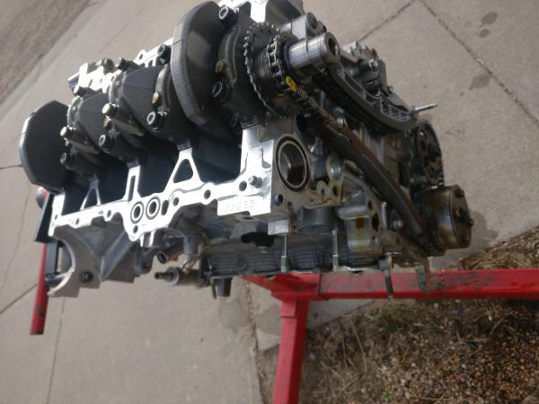

benefits: this prius c engine had 3822 miles, comparatively the yaris and other 1nz junk yard engines are 100k plus. My last rebuild was hampered by used cams and i do not want to do a real full rebuild for a 2500$ vehicle. the electric waterpump should free up some horse power, i can not use the toyota one as it is connected to the prius ECU. debating how to handle power steering and alternator. at a casual glance it looks like the power steering pump will bolt up, alternator will need a little work. rebuilt and went to start the engine:

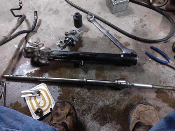

power steering pump does not bolt up with out custom bracket. (not an issue for yaris people) i gutted it and made the xb rack manual. could have used an echo rack, or a MR2 electric pump, or converted to a yaris rack and electric motor assist, however i am a cheap bastid.
alternator needs custom bracket.
had to swap the lower case to accommodate starter location, A/C, and help make it easier to bolt the transmission up.
waterpump = davies craig aftermarket EWP.

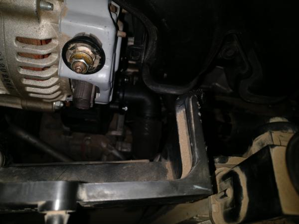

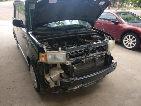

Prius C motor mounted in the 1st gen XB with the scion xb transmission.
2012 Prius C engine. 2006 Scion XB.

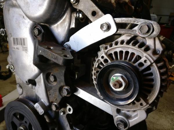

i do have the alternator mounted (NOT where it is sitting in the pic) , for some reason it may need slight shimming. just eyballing the belt path and it seems to stick forward about 3 MM. unsure shy, as the bracket i made follows the line from the front engine case. nothing a washer can't fix.
i also have the Davies Craig EWP mocked up. it will basically go where the Prius C EWP was and i really only had to cut up the OEM hose to make things line up. i did have to add a section of 1/2" return coolant line to go from the heater core back into the pump. i am hoping to be doing final install on the Davies Craig EWP this weekend so i will finally have some more pictures. once that part is done it will be on to test fire.
(crappy update i know, more to come though, sorry)

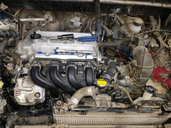

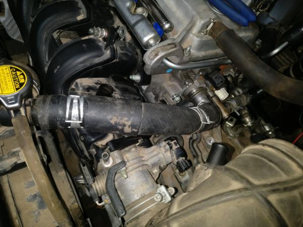

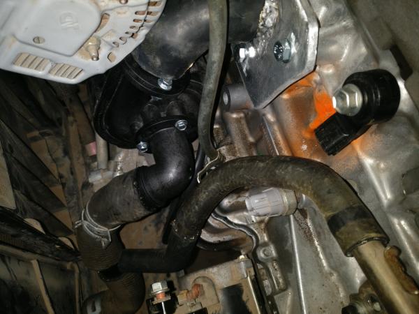

davies craig EWP test fit.
intake test fit with alternator and ewp.
a look down in
and the top
just have to hook up all the sensors, the wiring for the EWP is partially complete, getn close!

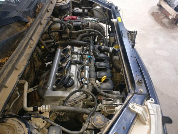

engine install:

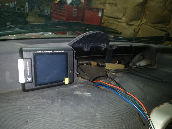

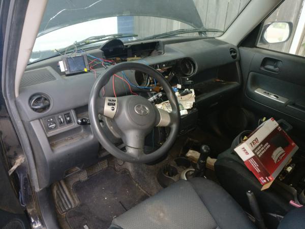

Dash pod for EWP:

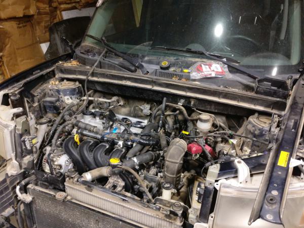

i drove it around last night at midnight. Prius C engine with Yaris cam, there is a NOTICEABLE seat of the pants power increase. i think i could easily keep up with the local civic kids. Also, as i had hoped, loosing the power steering is unnoticeable at all but a dead stop.
just another engine bay image. the plastic cover that is included with the scion XB would fit perfectly in its OEM location. i do not like the plastic cover and i think the engine with the aluminum valve cover and COP ignition looks better with out the cover.

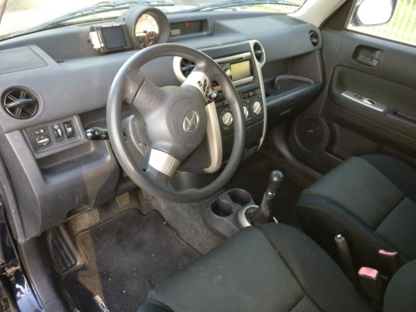

interior still needs work. i have a alpine head unit out of a late model Scion to mount. yes, the EWP controller wires are just stuck into the stereo harness at the moment. like i said, it was midnight and i wanted to drive it for proof of concept last night.
While this seems like it is all but done, i did run into an issue. my home made flange has a pinhole leak in the weld when the engine heats up. so i need to yank the intake and my flange and get that fixed. still, this is a success.

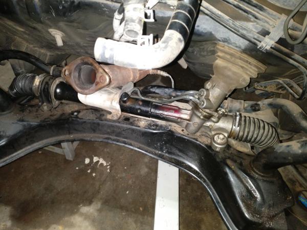

Did you consider an electric power steering assist from a current gen Yaris? You'd have to add the wiring to power it and possibly fabricobble the mounts, as well as spoof the speedo sensor to deal with the speed-based assist level. On second thought, that seems like more hassle than it's worth. =)

i did, and went through that same thought process. really, an MR2 electric pump could be added too the Scion XB system and be nearly bolt on. however even that is more work than needed.

i spent a day buffing and detailing, and i dropped the newer head unit in. i wish this site supported bigger pics, but still if you look at the reflections and headlights it is pretty obvious. i still need to get the USB port and bluetooth installed, and sub and amp. but still progress.
shiny on the outside.
not gross on the inside. EWP controller looks like it belongs there.

the American alternator tensioner bracket just does not work in this configuration. i tried 3 times to turn it into a vertical and linear adjuster. while mechanically, it is possible. the strength of the item makes it not work long term. i broke it 3 times and even after welding in added strength, it would just break somewhere else.
so i replaced it with the world spec part, it is listed on this forum as a alternator bracket https://www.yarisworld.com/forums/sh...ad.php?t=25758 and i modded it slightly to add vertical tension. so far it is working fine. time will tell.

and last note, i was correct in assuming that losing power steering would be a non issue. while it is noticeable when in a parking lot, it is not much of a difference even then. The mechanic i had do the alignment even said he only noticed when he was at a dead stop trying to turn the wheels.
