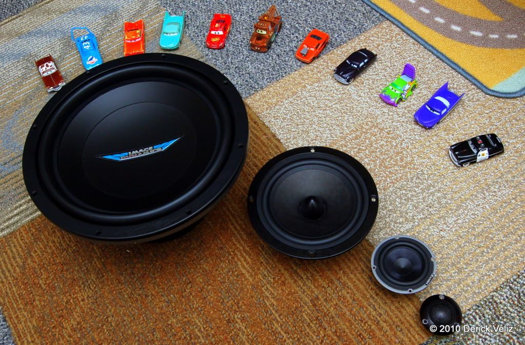

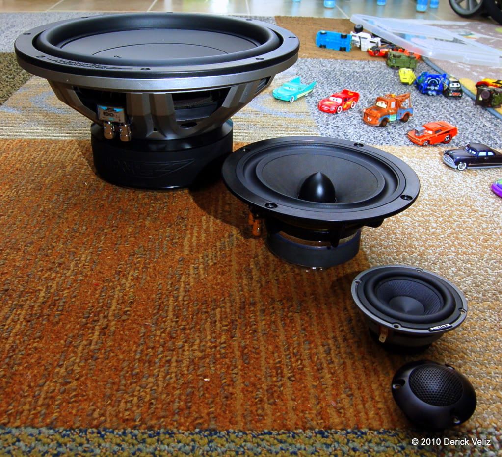

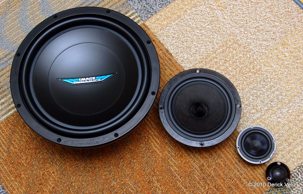

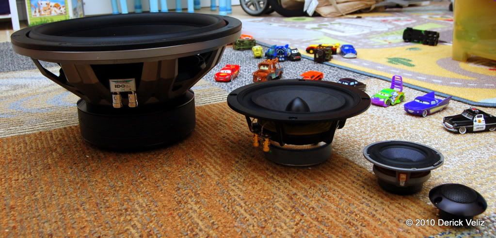

Derick, those are some really nice electroacoustic transducers you got there!

LOL, stealing your kids toys for the sake of a photo shoot,lol shame on you dad!

Thanks AM! I like that terminology
sickpuppy1... It's all about toys
