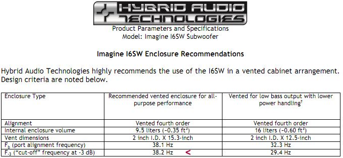

Now, to you Derick.
Why don't you simply glass the floor? You've got everything taped...
Also, D...I'm thinking that our resonant frequency is at 42 Hz. See if you can find a 42 Hz tone and run it through. You now combine that frequency and combine it with the tuning frequency for your enclosure of, oh let's say 38 Hz. Then that extends the response of the enclosure to fit your vehicle's response more accurately.
Yeah! I'm still in "thinking" mode, you know how designers work, think think think, then get it done. (sort of).
Yes, 38 Hz it's my target according to the enclosure Design Criteria...
D.

I realize what your saying about bass being omni directional, that makes sense. What I was thinking of was the amount of volume from a smaller speaker hes using. Course I also realize the enclosure it's in will affect it just as much. But you feel the sound from the back of the speaker will do as well as what comes out front? Thinking of it going into carpet vs what enclosure under your trunk mounted set up.
2 different enclosures,
Sqcomp has a sealed enclosure with the woofer upsidedown, yes the back of the woofer is what creates the bass, it doesn't matter.
I'm doing a ported box (vented) and yes the back of the woofer is what produces the bass, but with a little help from the port, bass increases a little more and bass goes out through the vented port that will be facing towards the fire wall.
Here are a couple of diagrams with different types of enclosures:
D.
