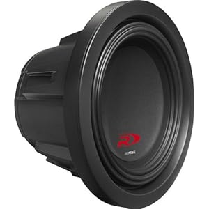

That peerless works in almost the same enclosure of one of my Kicker Solo-baric 10" in a sealed box of 0.66 cf But you need a lot of power to make them come alive!
There is an Alpine SWR-843D Type-R 8" Subwoofer with a big reputation in the DIYMA that looks very promising in a small box, from $100 to $150 it's not bad either.
TOO MANY OPTIONS!!!!
