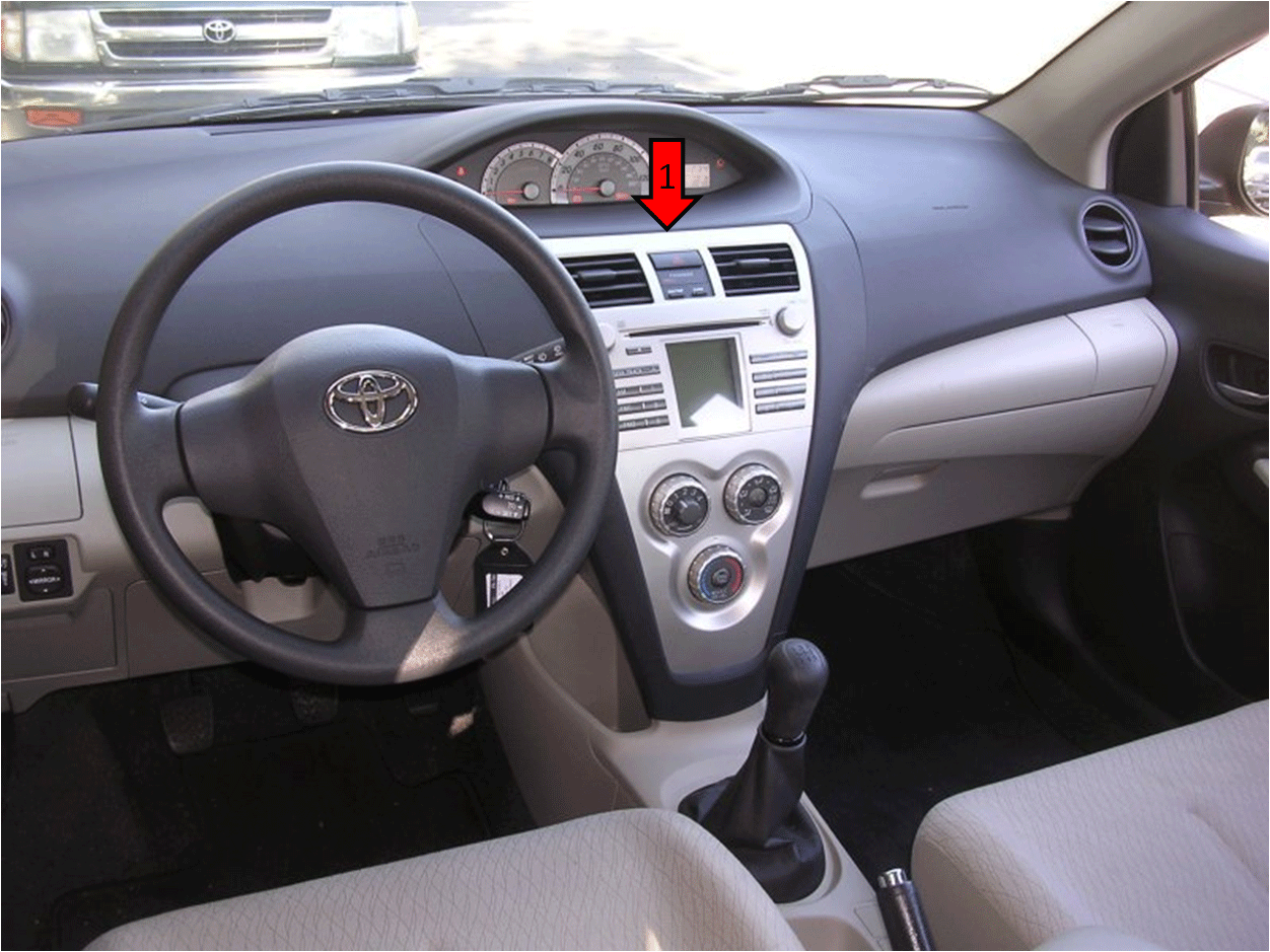

Ok today I found an awesome way to adjust my center image:
I had my cellphone right in front of the instrument panel (arrow 1) with the GPS rolling and telling me what was my next turn. When... I just realized that...
While listening to a track with a very solid center image I noticed the voice of the singer was behind my cellphone's voice, a little bit to the left, so...
I moved my phone above the instrument panel (arrow 2) now playing a song... Still my center image was behind so...
I moved my phone behind the instrument cluster (arrow 3) in the center of the dashboard where the windshield meets... (Note that this position is about 5 feet from my right ear)
My center image was some how next to the phone's (playing another song in speaker voice) so...
I proceed to adjust my Time Alignment (T/A) to mach the position of my cellphone playing a different song, since it's mono gives me the feedback of a center channel where I can match my center image.
End result while experimenting with this was really good and makes sense to me, what do you think?
Conclusion: a new way of Tuning may be accomplish using my cellphone with one speaker and placing the speaker on arrow 3 (see image below) adjusting Left and Right EQ and T/A to match my center image. I got to try this over my lunch time this week.
