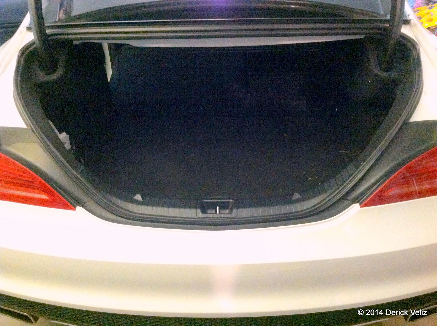

Guess what this is? a piece of foam laying down in my living room?

I've done many subwoofer boxes, with good tuning and instal I had great results, and sometimes really bad experiences, but that's the learning process.

Posts: 2,722
Yes this foam is my guide for the baffle, I thought about how to trim and fit, and how to cut it, but never really thought about how to put it in place; with the same angle of the rear seats, it's almost impossible to get it in position, I may have to cut it smaller then work around to seal the edges partially isolating the trunk from the cabin and most important is to get a strong mechanically support(s).
