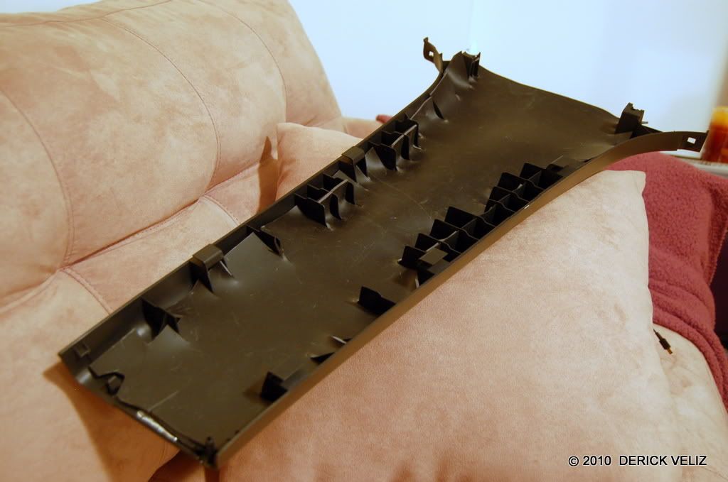

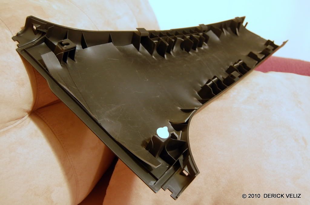

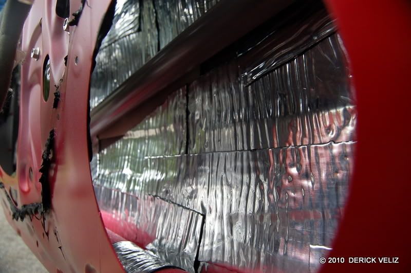

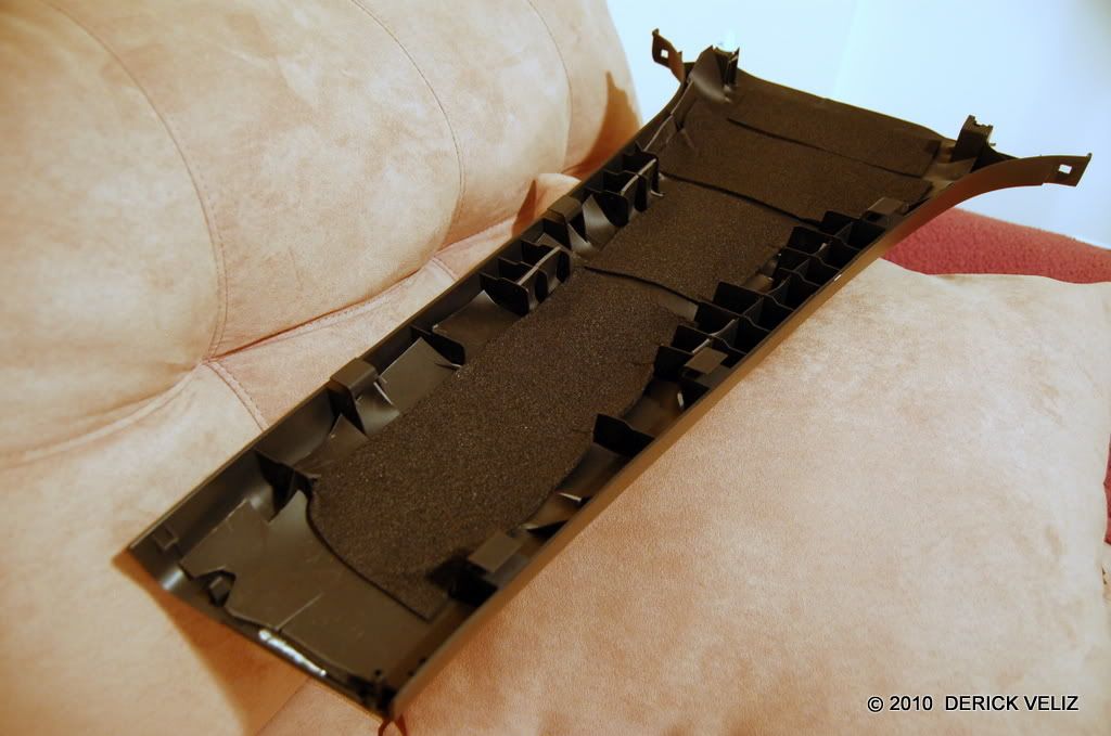

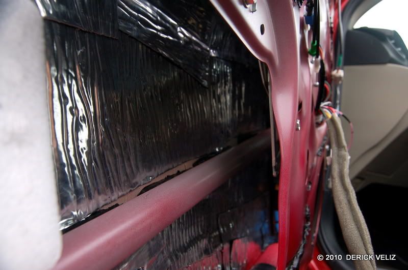

Ok, back into my car, even though we had some celebrations at home over the weekend I did the other side of the A pillar (the one that holds the front seat belts)
This is how it looks when you take the panel out...

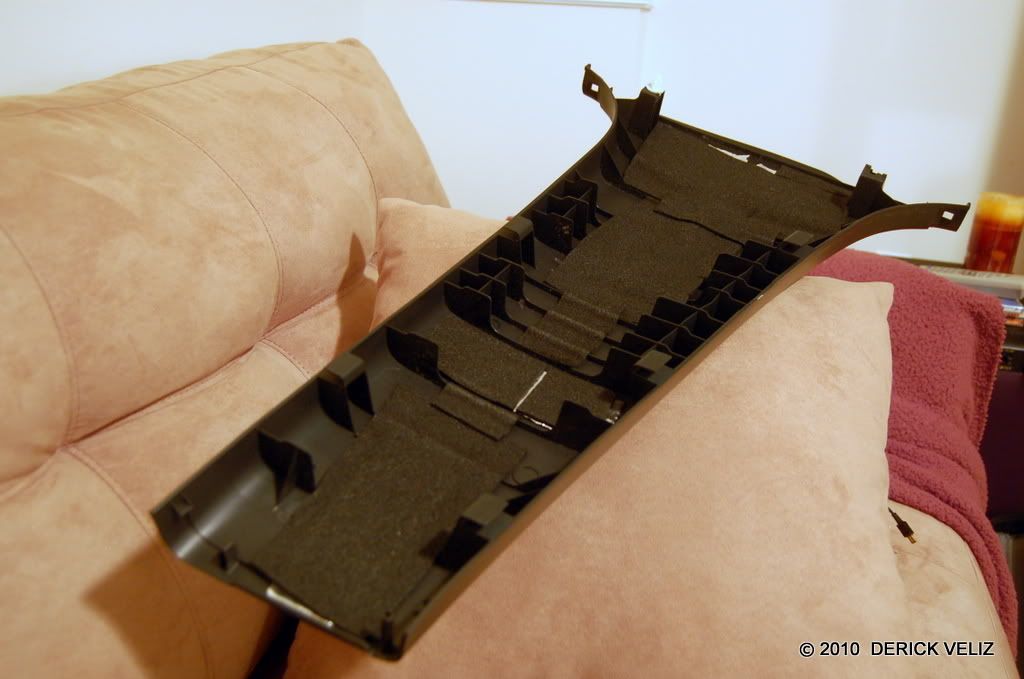

After some CLD Tiles and Pink insulation material stuck all the way inside...
The panel with some Mat and some Ensolite on top...
The panel with a full layer of MLV...
Some ensolite on top of the MLV to finish the treatment... BTW I didn't put it on a scale but the trim panel at least double it's weight!
Next is the left front door and the floor area right under pilot's area and fire wall, followed by the Hood and front fenders (I have no idea how I'm going to accomplish these)

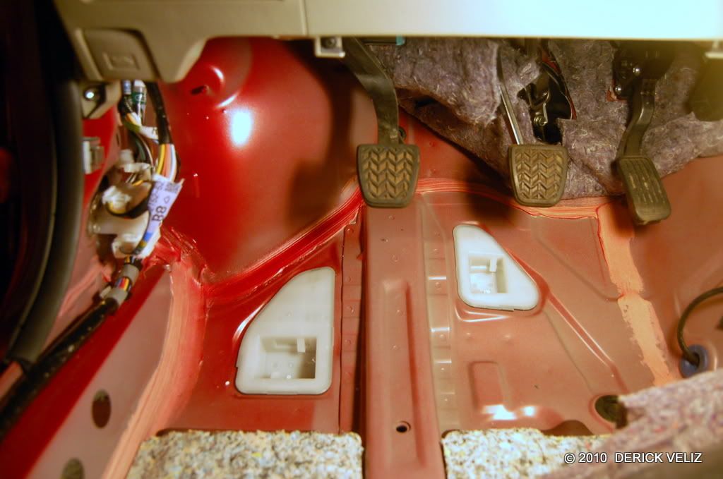

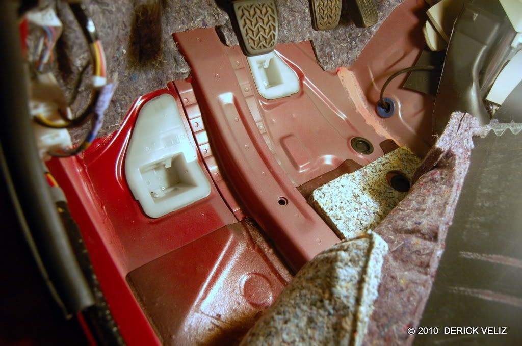

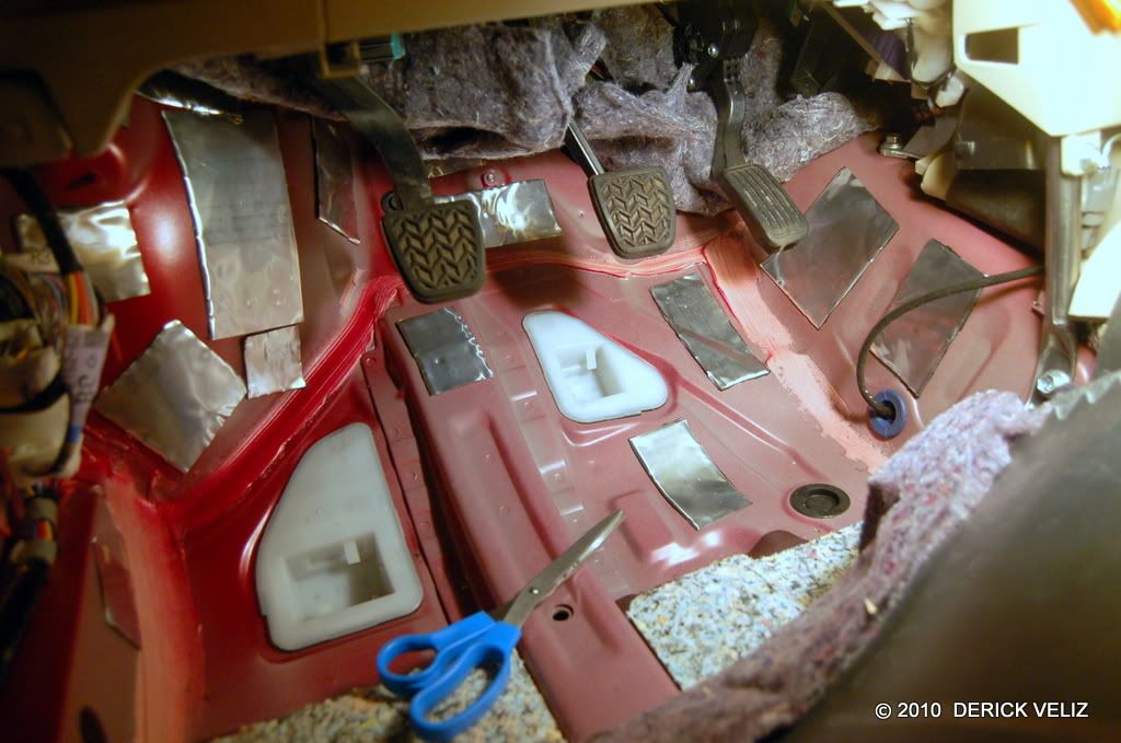

OK, I had to go and look at the fire wall...
Now I know where is all that noise coming from...
I put 2.5 CLD Tiles in the flat areas to control resonance, and for now I lay down a layer of CCF 1/4" and covered back with the OEM carpet, I need to spend more time in this area so I can lay down the MLV.
Even with only the CLD Tiles and Foam, I can tell the difference, the MLV will really quiet things around in this area, but it's going to be very hard.

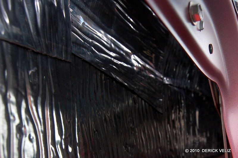

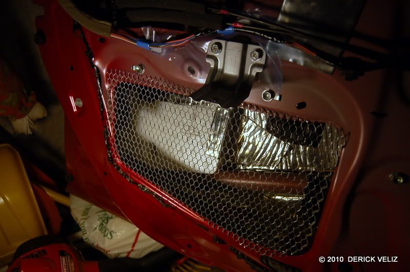

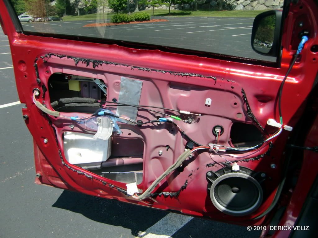

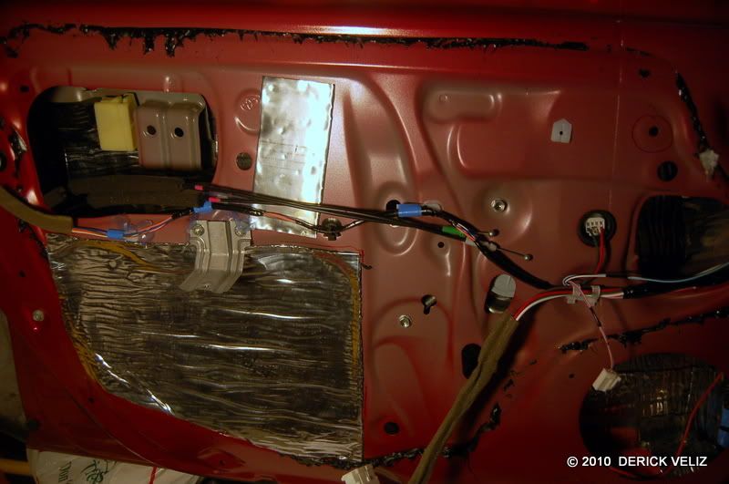

At lunch time I removed the panel from the left front door, and put some butyl rope inside and 2 CLD Tiles, this time I'm putting most of it inside of the inner wall (where the speaker is), on the right door I had to trim the MLV a lot to get the panel back in place, so this time I'm taking my precautions.

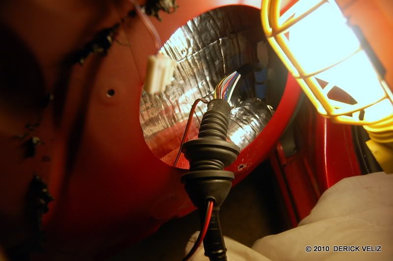

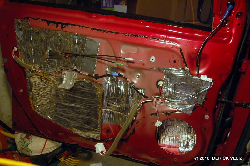

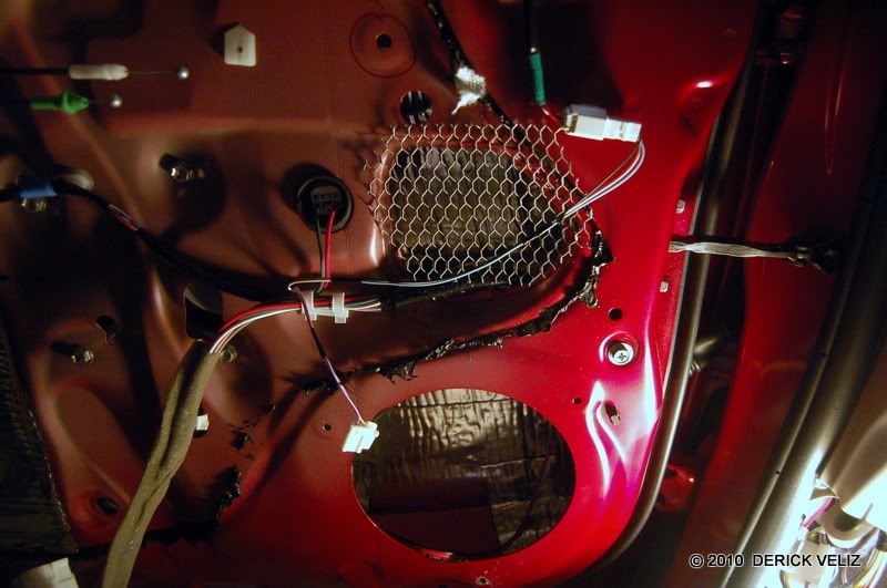

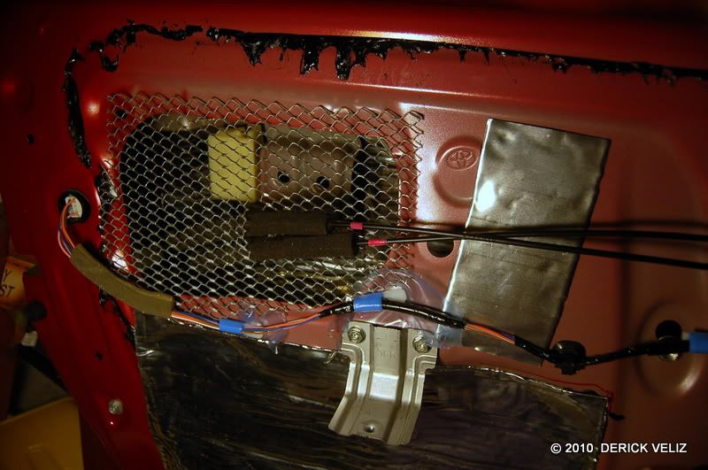

Wires for 6.5 driver, I dislike this task, it's not easy. ..

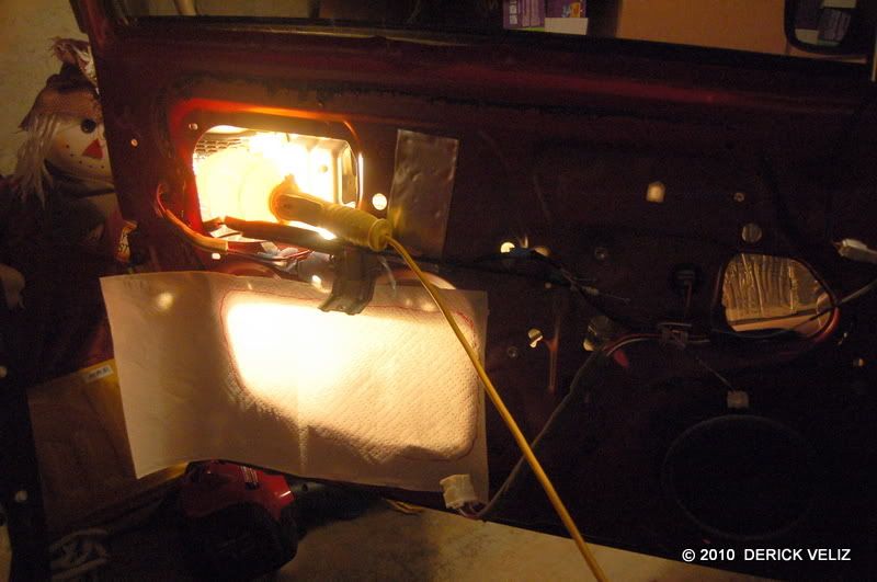

Mat over CLD Tiles inside door...
A quick way to make a template to cut the mesh...
I'm running out of Mat; there is a layer of Mat + some CLD Tiles behind the inner wall that we don't see here, I'm trying to save the extra thickness that all these layers make so putting back the panel will not be as painful. And 3 layers of Mat behind where the speaker goes, remember these doors become speaker boxex now for the Mid-bass speakers (I still have to go back to the right door and finish it similar to this door).
It's nice to have the opportunity to drive with the door in different stages, naked is LOUD, and as I progress it tends to be less LOUD, but as it is right now there is a deafening noise that really bothers my left ear after 1 hour of commute.
I don't really need to cover everything, just covering and filling openings. A layer of MLV will go on top after some Ensolite and some CCF over the MLV.

Excellent job! Aren't the holes in the doors just HUGE?!?! So you pulled the whole wire harness out of the door and body? I didn't even attempt that! Pulled my new wires through the rubber loom with a coathanger, tape and lube. Maybe 10 minutes of cussing (per door) to get it done.
Thanks,
I did try that too, but I had no success, it was easier for me just to pull everything out.
