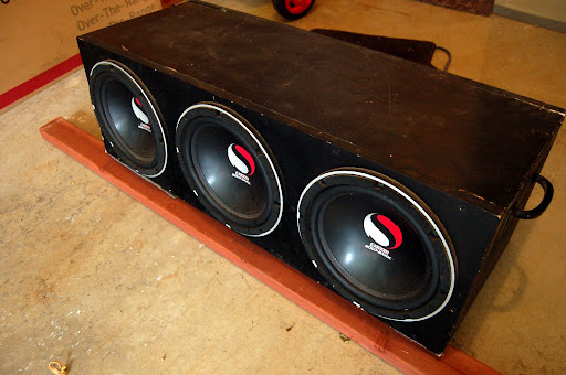

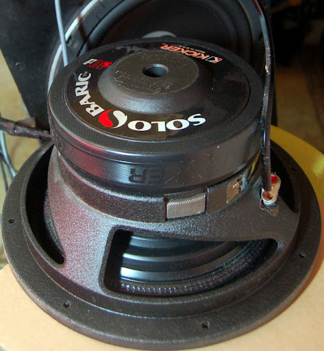

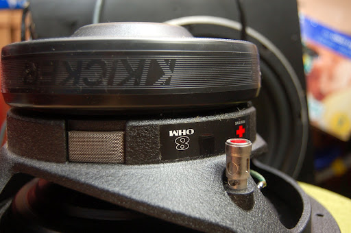

Ah-HA!
Now you know what you are dealing with.
You have three "single voice-coil subs", 8ohm each.
Wired in parallel, they give you 2.6 ohms total load.
That Kenwood amp I recommended would push them nicely.
( Or any other subwoofer monoblock amp that has around 1,000 watts RMS @ 2ohm load )
