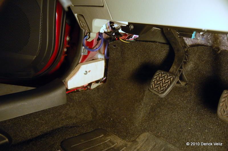

Ok, I made two 12 inch wire extensions for ground and relocated the wires where the kick panels will go.

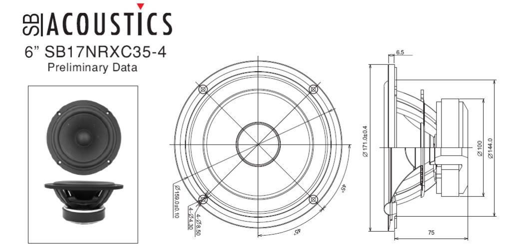

Thanks, here are the specs for "SB Acoustics SB17NRXC35-4"
LINK
Dimensions:
Flange diameter: 171mm
Cut out diameter: 144mm
Depth: 75mm
Flange thickness: 6.5mm
Screw mounting diameter: 159mm
Screw hole size: 4.3mm
I'm realizing how important is to have a good Mid-Bass up front for 40 Hz to 3.5 Hz Band, so I really want to try these with kick panels.

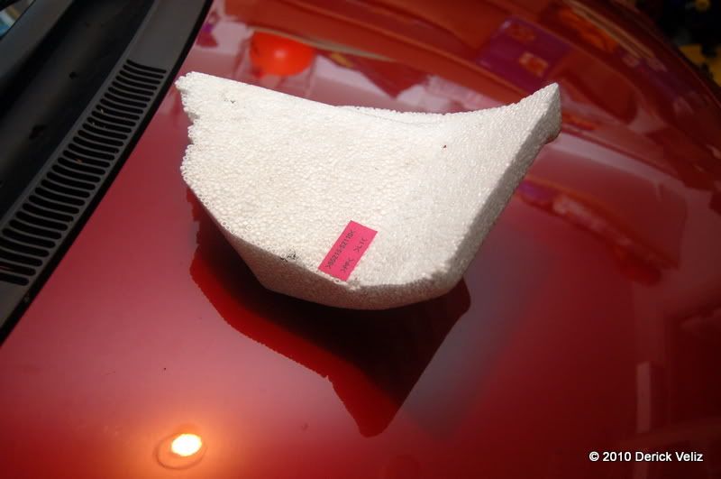

This is the piece of foam I'm taking out, foot rest area for pilot. I'm not going to take the foam on the passenger's side.

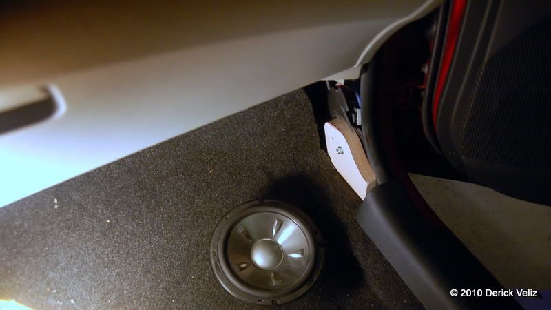

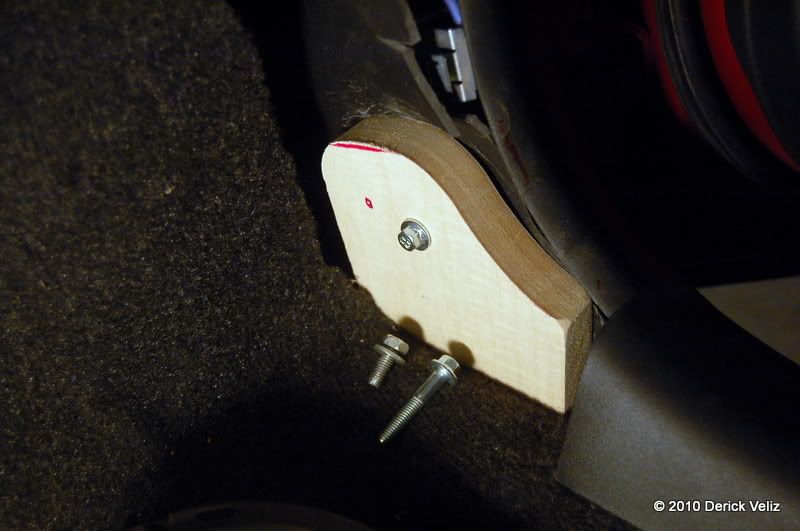

Here is where I'm starting the kickpanels and how to hold them in place. 3/4" MDF cut in to shape where an OEM bolt used to hold a ground cable (relocated). In one of the pictures you can see the OEM bold and the new long bolt.
Next step would be to prepare the surface and place Fleece under the MDF then cover it with resin. But fist I'm going to do the Pilot's side (MDF piece) I feel that if I do one side first I'm not going to finish the other side any soon. Also to work with the Resin all at once. (this is my first build up so, I'm prepare for failure). any tips or tricks are welcome.
Here are the pictures (Premier 6.5 component speaker shown just for reference)...

That area looks VERY familiar! Derick, I wouldn't put fleece down first. Tape the area off then lay down hand torn strips of glass matt. Resin those and then add thickness with several more layers of matting. When you've reached the desired thickness, remove and trim the edges. Fleece doesn't conform as well as glass mat. I'd use the fleece on the front baffle over the trim ring.

Here is the base for the kickpanel on the Pilot's side!
I desided to remove some CCFoam and leave a layer of MLV behind the Kickpanels; gain some volume but keep the road noise out. mmm I should order a little big more of MLV
