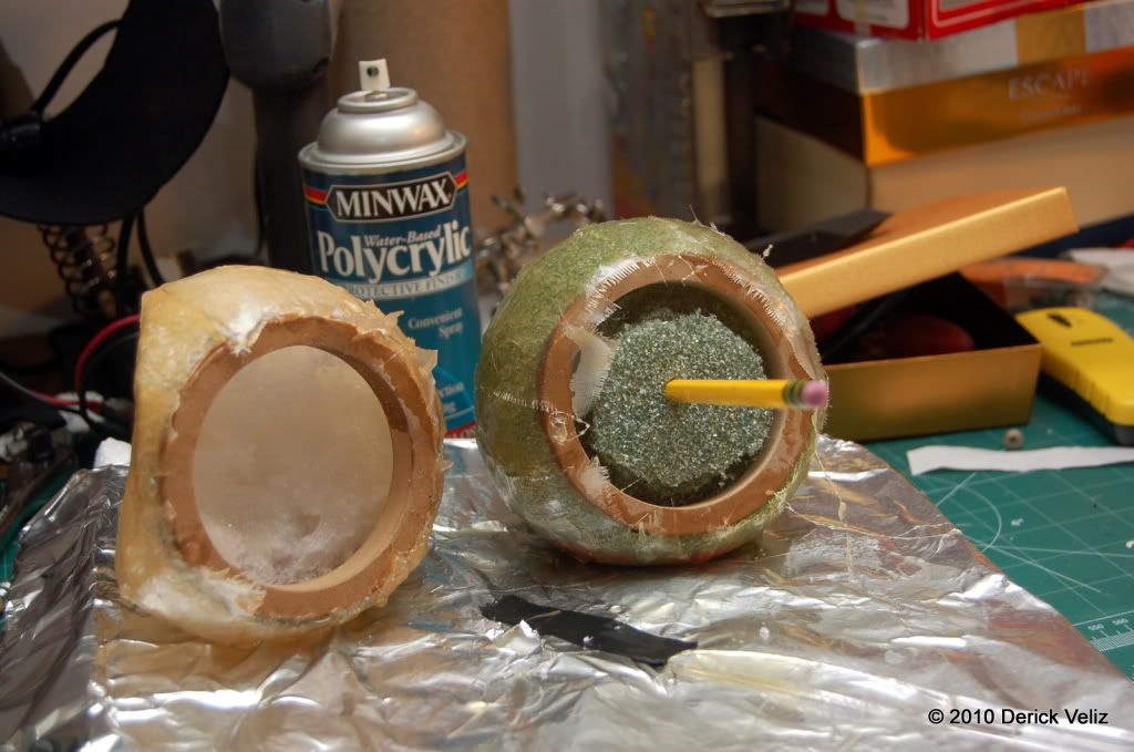

OK,
I got my self some Resin and did some testing on the foam balls, one did kind of melt a little bit, we'll see how they look tomorrow.
This stuff smells funny!

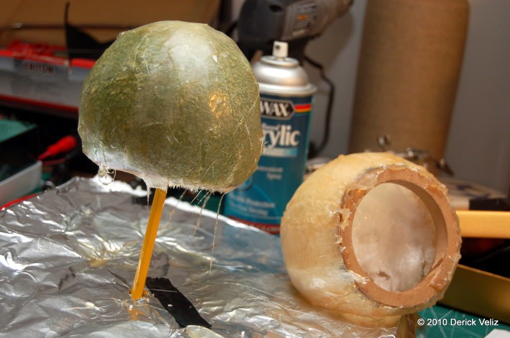

So I end up using some water-based Polycrylic on the foam balls to prevent melting...
I did work once with resin and fiberglass about 20 years ago, I remember the smell (it was a little patch for a small speaker box I made).
I cut the fiberglass in 1" stripes, I mixed 2oz of resin with 20 drops of ???? I don't know what is the proper name in Spanish is "catalytic"? I'll read the bottle tomorrow and edit this post. Yeah it's MEKP!
The mix proportions was less than the instructions 1oz = 10 drops Instructions require 1oz=12 drops. I did this just to aloud me more time, they way I look at it is more drops... less time to work!
I applied a little bit of resin and a stripe of fiberglass at a time, until the ball was all covered, tomorrow I'll try to do the second one (green ball) then I'll start sanding and applying some bondo and then sand again. We'll see how it goes!

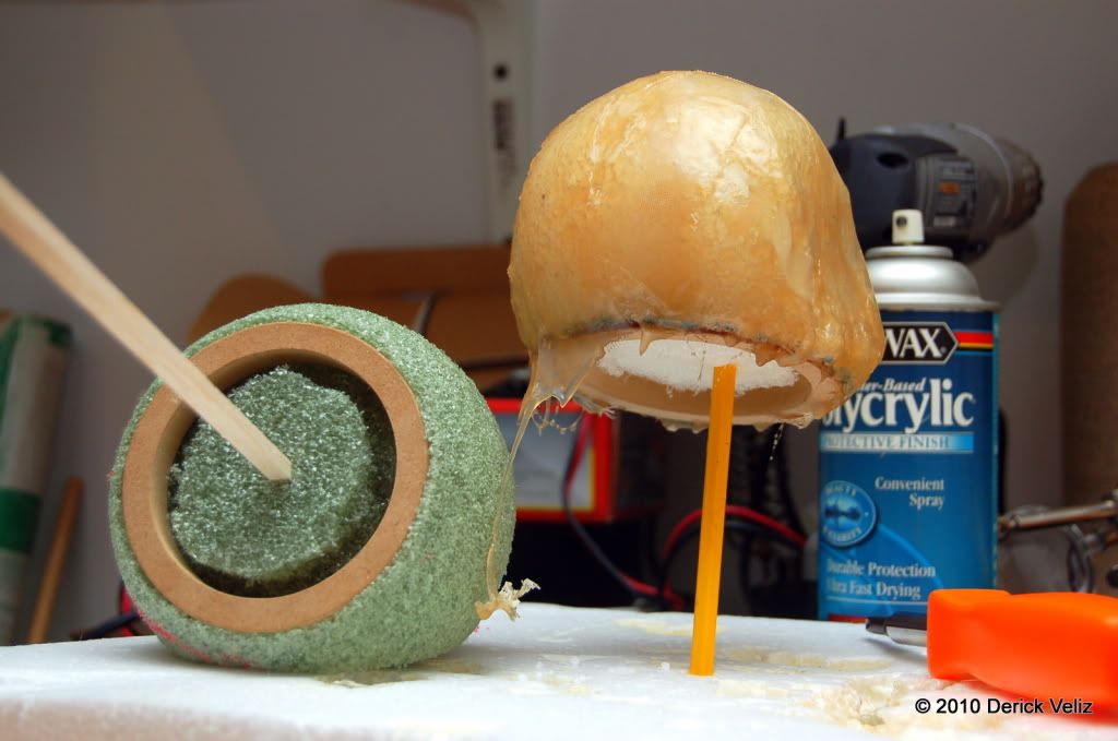

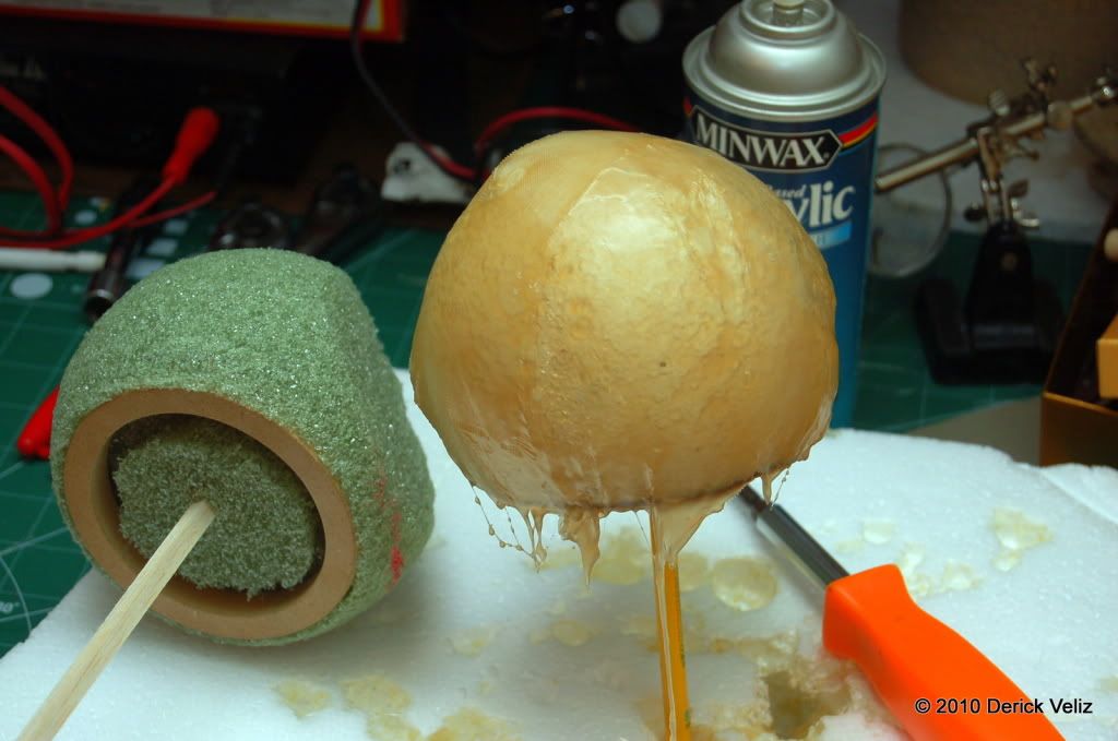

Here is the other ball after applying fiber glass.
Now lets get the foam out and reinforce the MDF ring to the fiber glass sphere. I'm starting to like the funny smell!

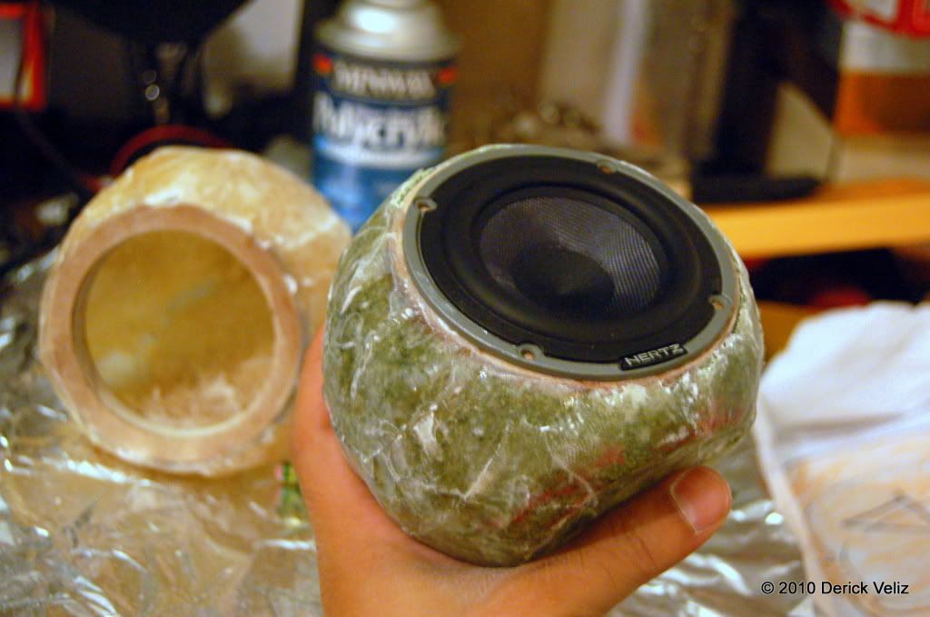

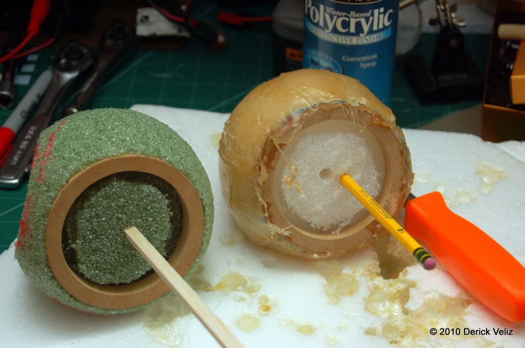

A little bit of ACETONE to melt the foam, it was actually a sad moment...
After 5 or 10 minutes with the Dremel and a little sanding I did a test fit! Yeah!!! Can I use 5 minutes Epoxy to reinforce the spheres to the MDF ring? would the BONDO work ok over the Epoxy?
After some structural reinforcements to the spheres I should start looking for a mechanical system to attach the spheres to the A-Pillars
