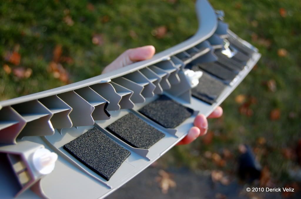

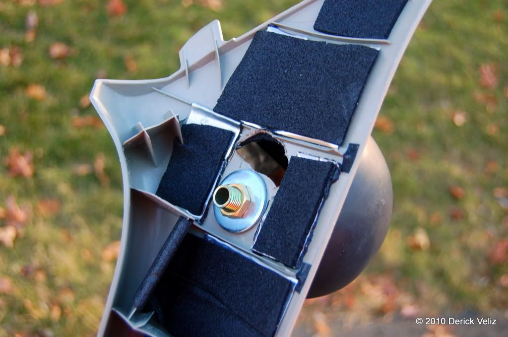

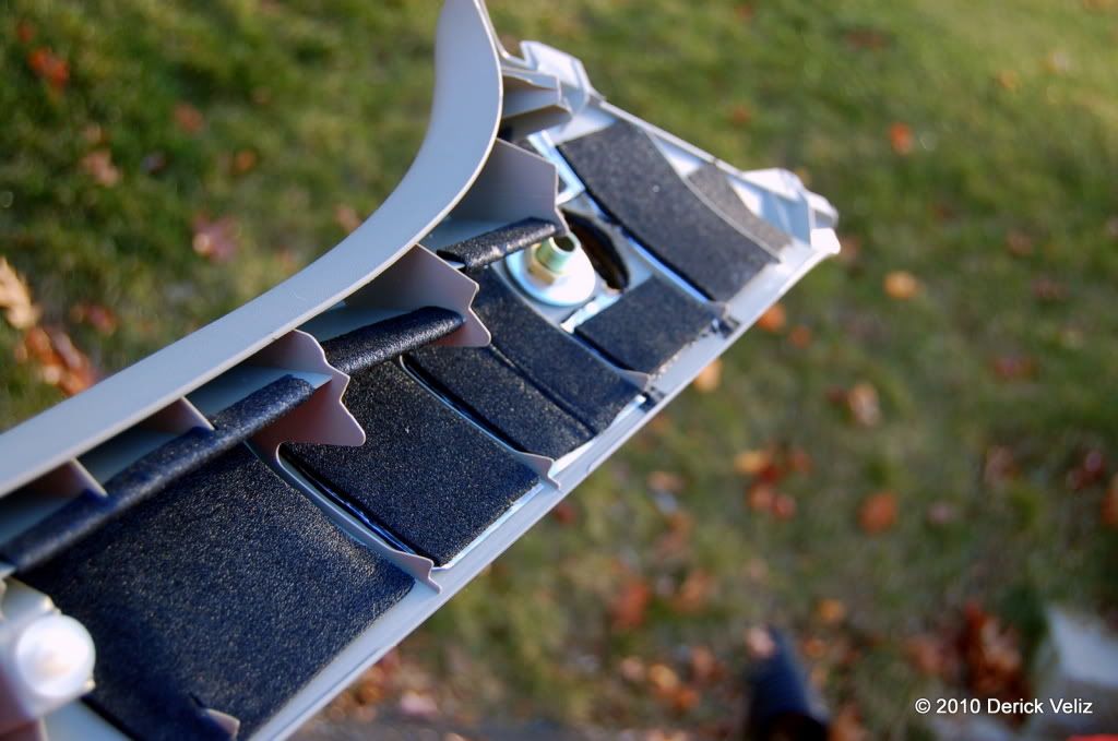

I finished the spheres on the a-pillars tomorrow they are going back to the car.
I put some pieces of CLD Tiles in the back of the a-pillars then covered with ensolite (ccf-peal and stick)
Next would be wire and connect the speakers.

I did make a hole to the spheres and a-pillars to let the drivers breath, the HL-70 are "Free Air"

Some pictures at the a-pillars behind the scenes...
D.

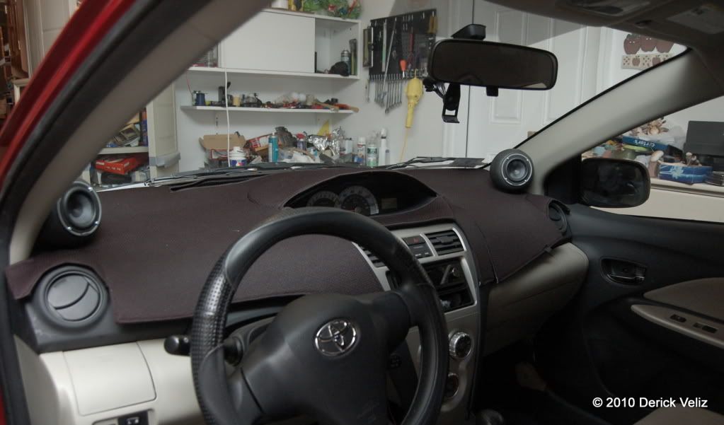

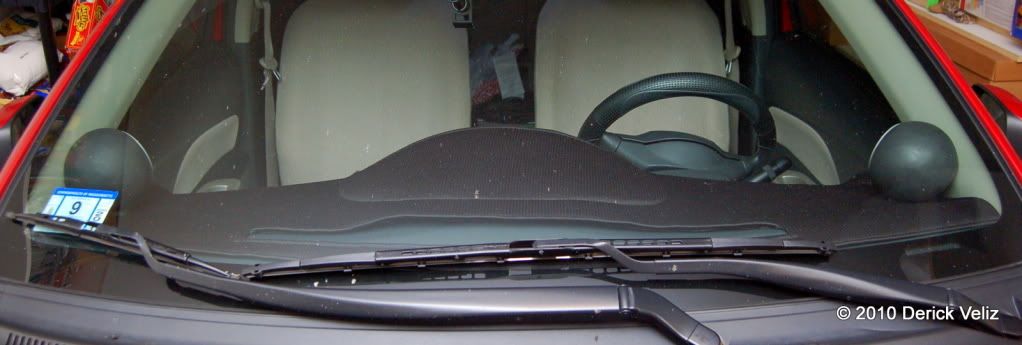

Thumbs up
Some progress shots, the spheres are ready to fire in the a-pillars...
D.

Yes the spheres are about 4 to 5 inches in diameter, the second set of spheres that I'm going to build for my car will be smaller and will host the tweeters, these in particular are the ones that will get a benefit of the spheres controlling diffractions in a better way.
