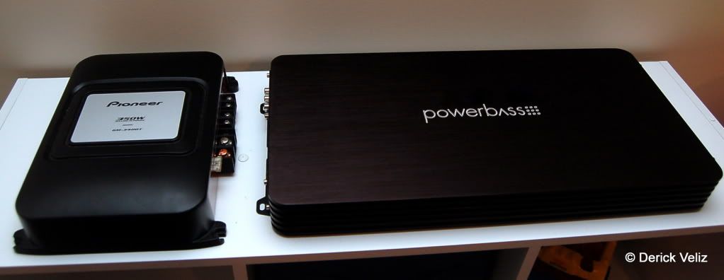

A couple of shots of the PB amp next to the small Pioneer amp...
D.
