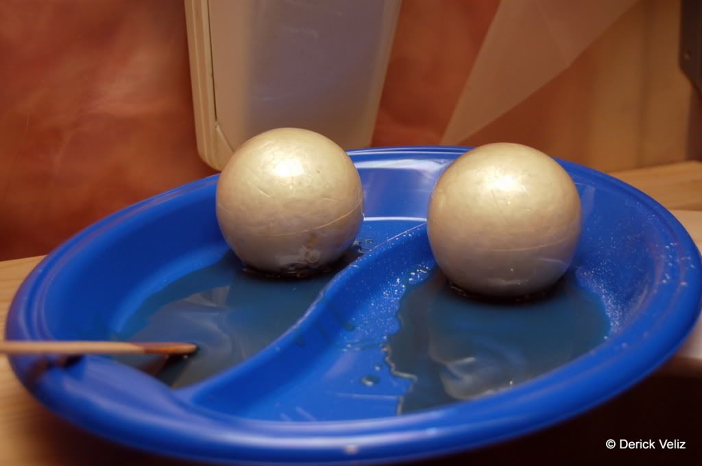

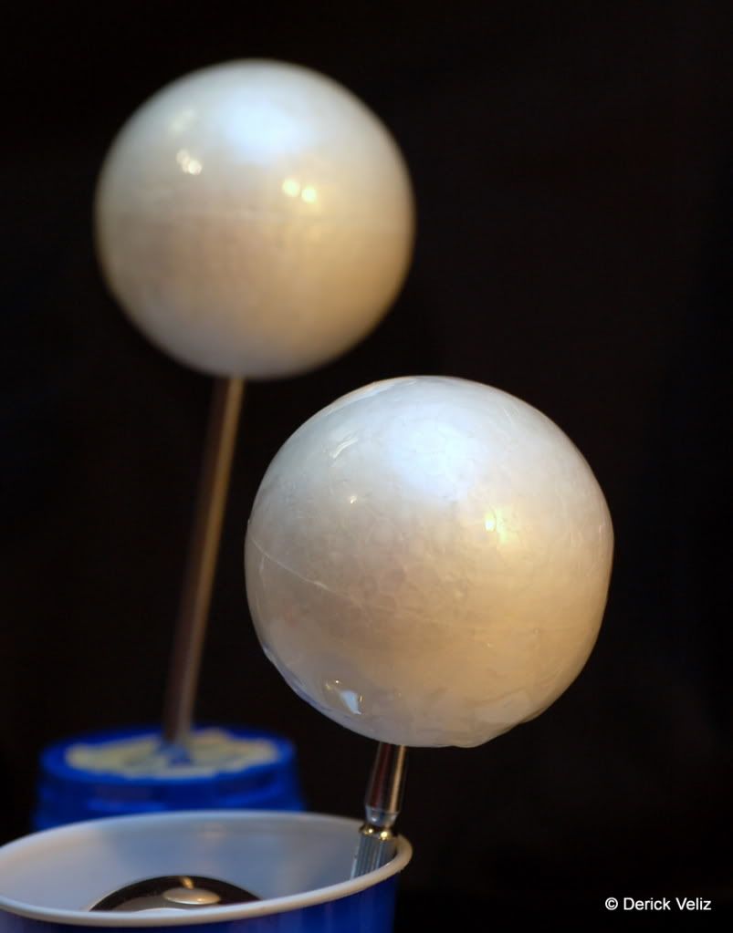

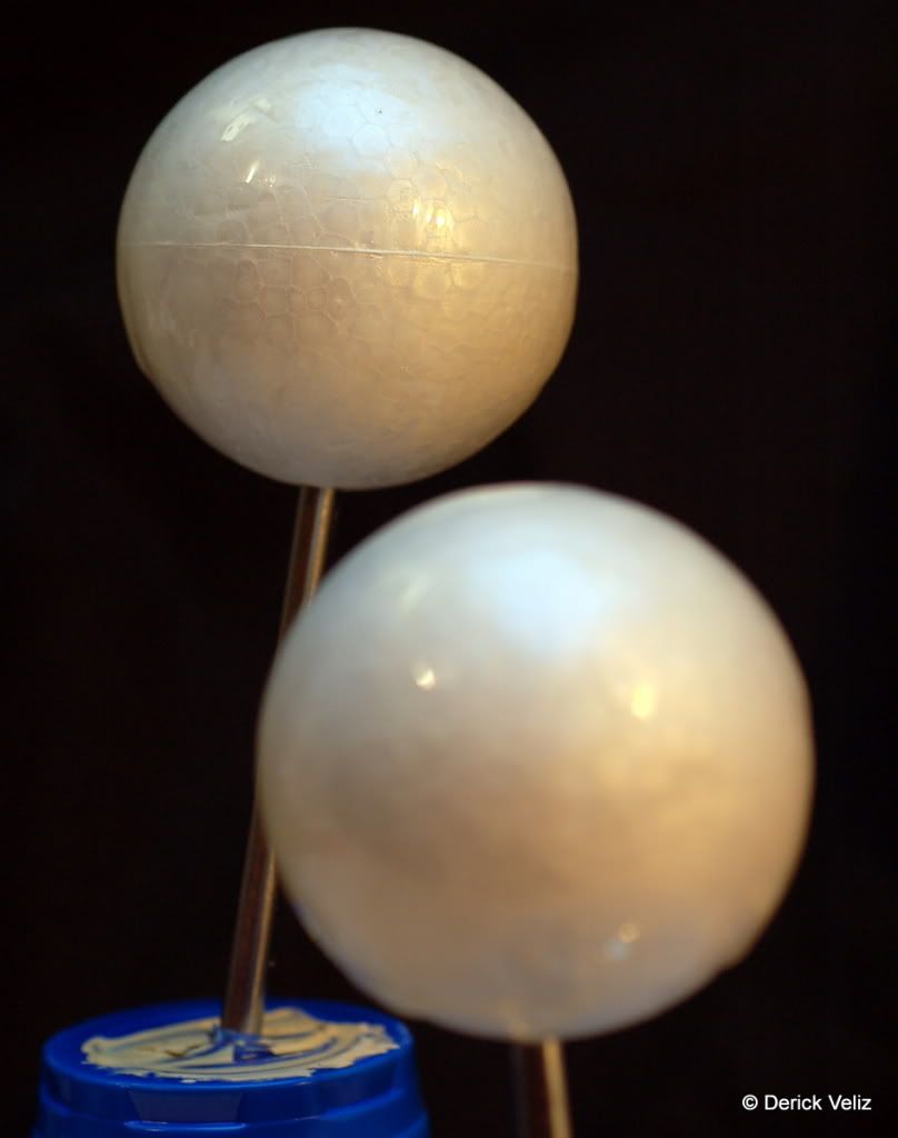

So we all know that resin aka MEK would melt the foam, so I added a layer of 5 minute epoxy to the foam spheres...
CLA 250, 4MATIC

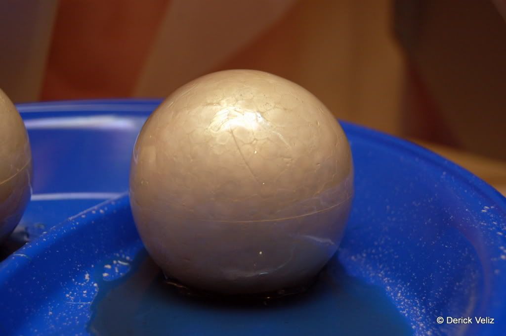

These are the spheres after the first layer of 5 minute epoxy...
Tomorrow I'll put a layer of MEK with a some fiberglass...

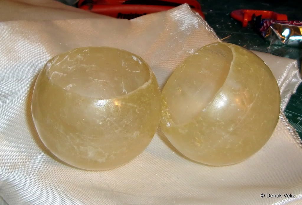

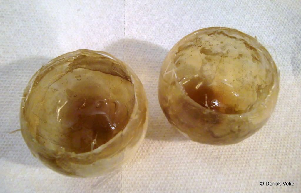

After all these festivities and family, I got a little chance to work on my hobby.
After the layer of 5 minute epoxy I did 2 layers of Resin, if it's stiff enough I'll take out the foam and reinforce the inside with fiberglass.
D.

Got the foam out the spheres (with Acetone)

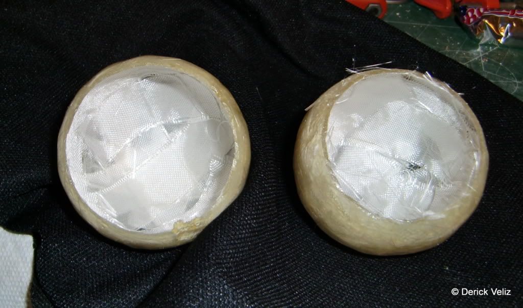

The shell it's not very strong so I cut small strips of fiber glass and paste them inside the sphere with some spray glue, then added resin+MEK to reinforce the structure of the spheres.
I'm sorry my camera ran out of batteries so I used a point and shoot, I'll post the pictures soon...

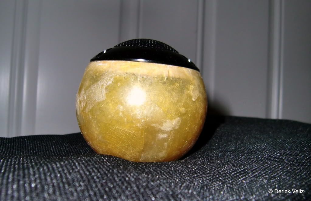

The spheres without foam!
Spheres with some Fiber Glass (I added more fiberglass as I was pouring the resin.
Looks ugly now, but the spheres should be very solid by tomorrow!
Next step is the add a wood baffle for the tweeter and match the spheres.
D.

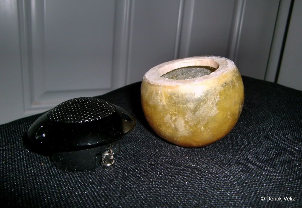

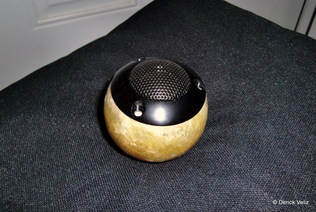

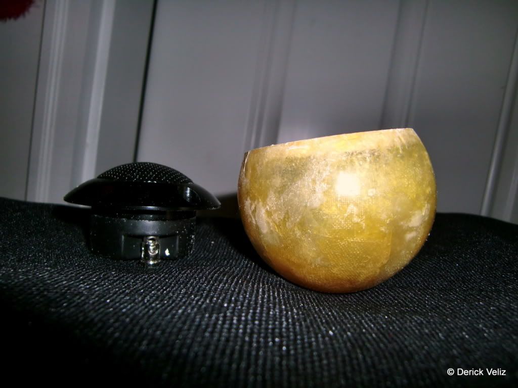

Sanded down the opening in one of the spheres to match the diameter of the Tweeter, glue in place a balsa wood baffle, hardened with CA+ accelerator (this process reminds me my other hobby, r/c model airplanes) and made a hole for tweeter.
Now lets do the other sphere... (soon)
Sorry for crappy pictures, I'm still using the point & shoot camera, and the dust over the tweeter, )o:
