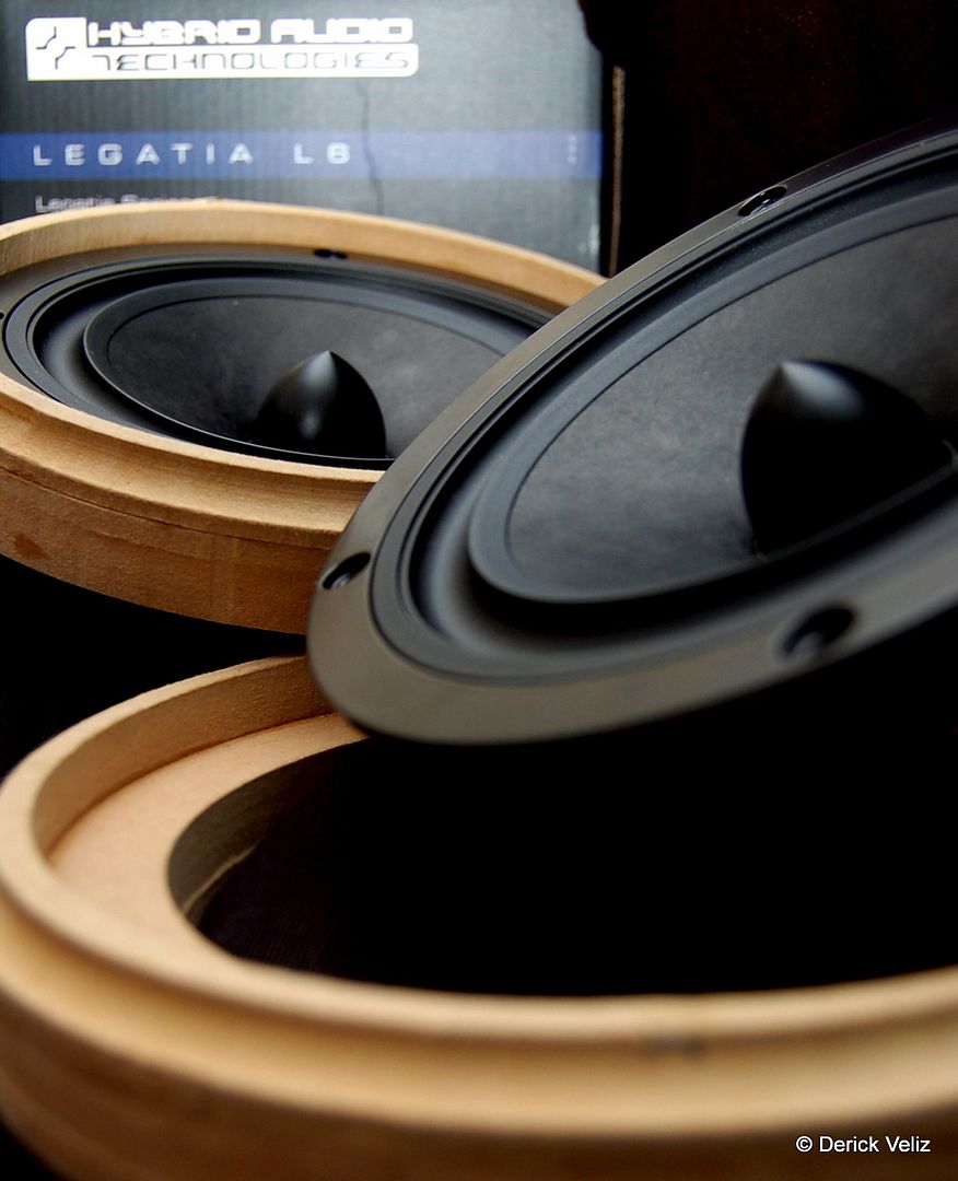

I got the rings for the L6s... time to start building kick panels.

Ok, so here is where we start with the L6s and Kick panels...
I got the rings now and I'm ready to figure out what's the best way to build the enclosure (kick panels)...
Check out the rings! the L6s fit perfectly:

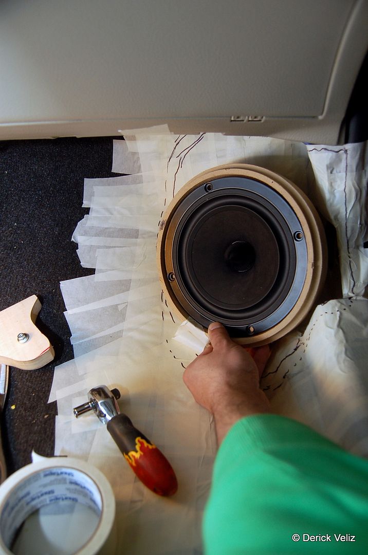

And here is where one of them will go!

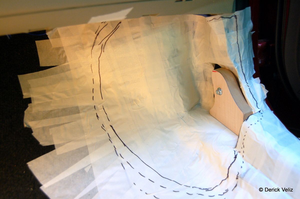

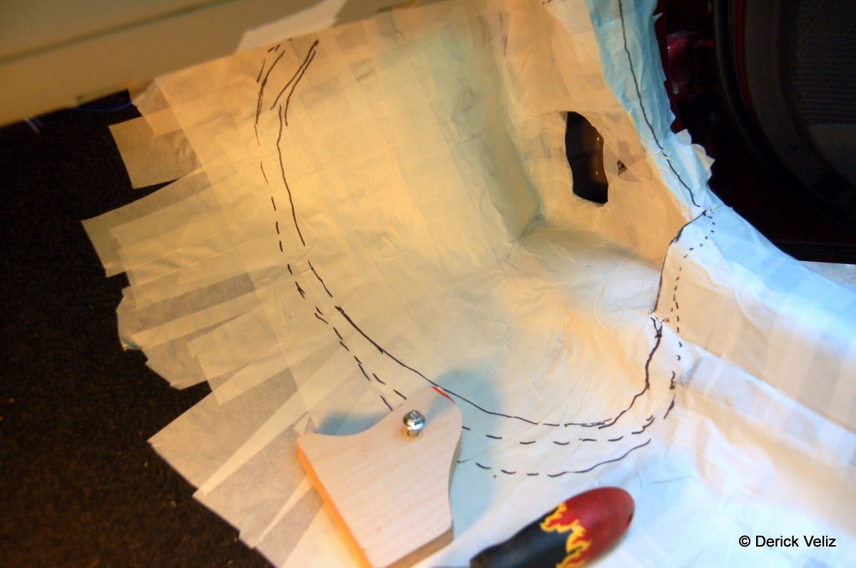

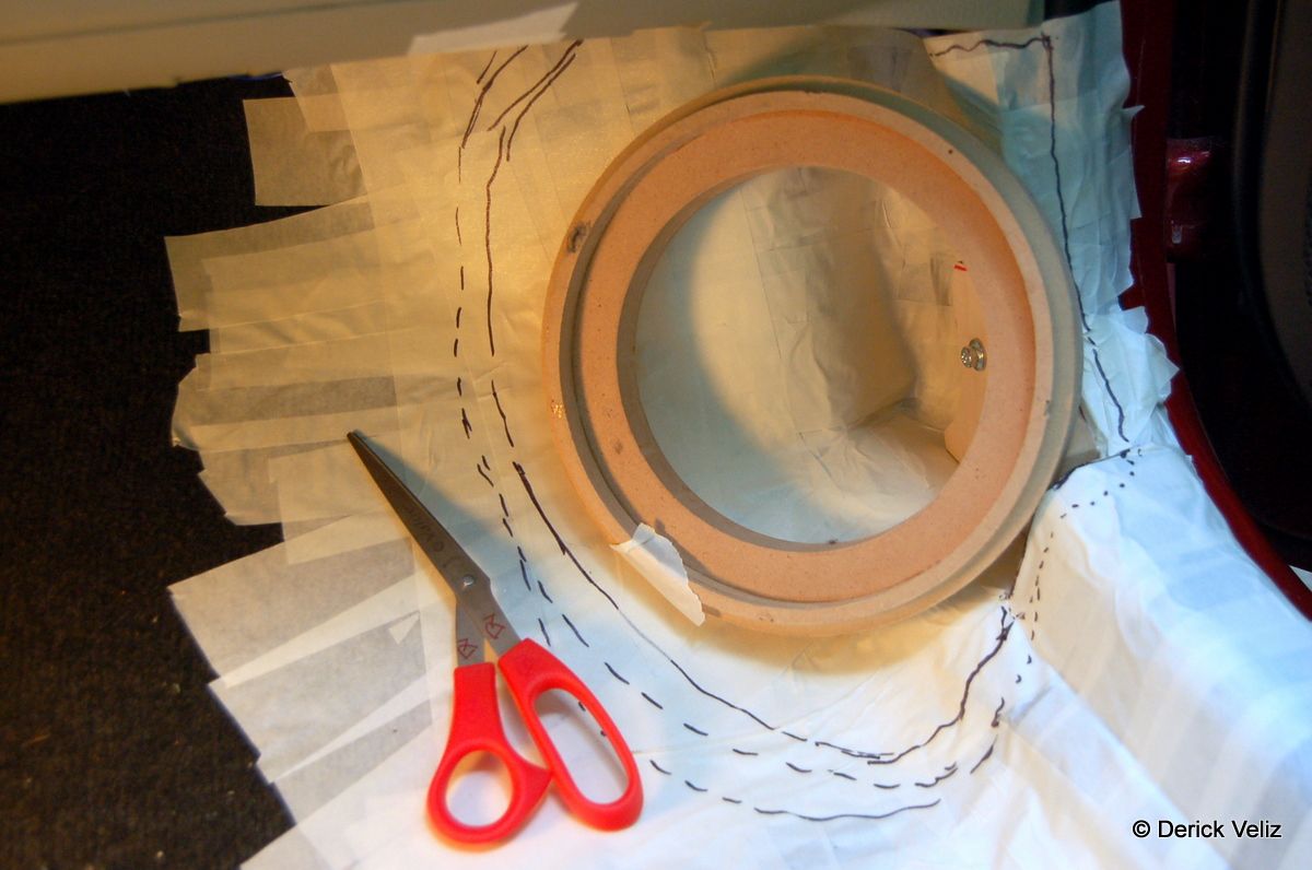

I started the passenger's side, that lets me keep driving and I'll do the pilot's side on a weekend , pull out some MLV and CCFoam from that cavity, the L6s will be able to breath, Then on top of the carpet, MLV, CCFoam, Mat and CLD Tiles I started putting masking tape, 1 hour later and all my body hurts, it's like Yoga. Now I'm wondering if I should include the OEM carpet, the one that says "Yaris" other wise I'm going to have to cut it to make space for the kick panels...
I took pictures will upload later

I think I'm going to put the OEM carpet with "Yaris" logo and tape on top, so I can get the carpet down there with out cutting it!
Here are the pictures of what I did a couple of nights ago...
