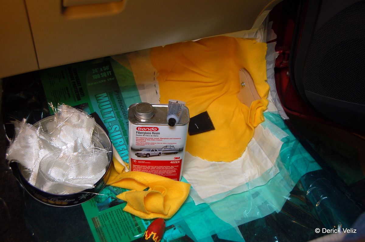

First, what was the most difficult part of the glass laydown?
OK, besides getting down there and doing some Yoga... the most difficult part was applying the resin on the upper section/vertical areas. The fleece just kept sticking everywhere out of place. I guess I need to be more aggressive and not to be afraid to work with more than 6 oz of resin at a time.
D.
CLA 250, 4MATIC

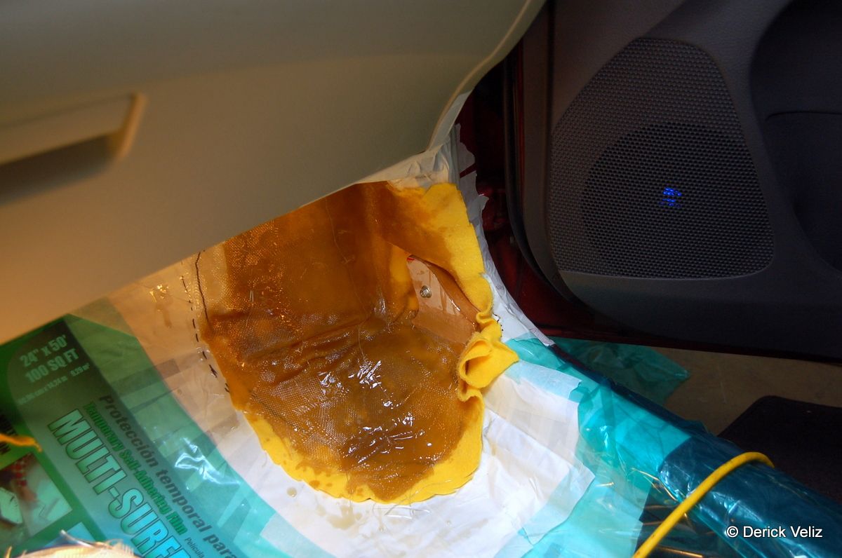

Here are the pictures of the kick panels in wanna be kick panels...
Get set GO!
This morning every thing looked ok, very stiff and rock solid, I don't know if I should pull them out and keep adding layers or do another layer down there?
D.
CLA 250, 4MATIC

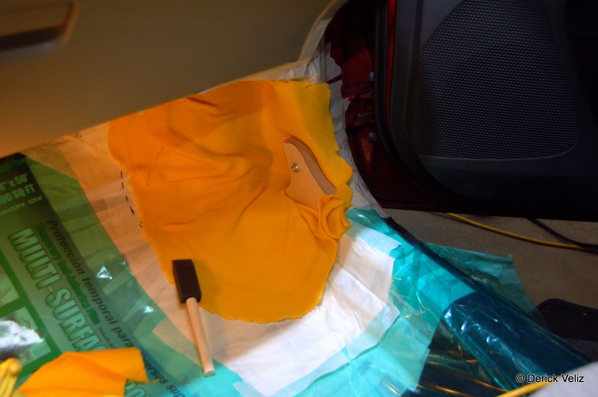

Eeek...it's just me, I wouldn't lay day down fleece as a bottom layer. Butnow that I know you did, we can work with making that fleece straight. Do what you can to make the substrate as flat as possible for a few more layers. I use fleece to wrap the top of the enclosure.
Show me pics of how you lay down glass matting. I may have some suggestions.
― Thomas Paine
Well, the first batch was kind of random, just trying to cover the fleece at least once or twice in some areas, My intention was to place them at 90 degrees overlapping with each other starting from top to bottom, but didn't happen.
It got cold again, Brrrr
D.
CLA 250, 4MATIC

The issue starts here. We need to keep the substrate flat to get the closest fit to the panel. If the base isn't flat it is VERY difficult to get a build up with all those waves that we see. Also, it's probably better to use chop mat versus glass weave in that area. Chop mat is great for build up, which is what you're trying to do.
