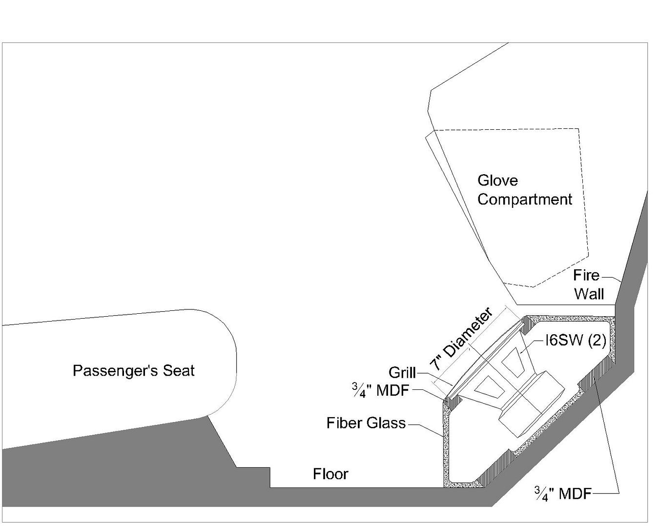

Ok, this is only a sketch (it's a cross section parallel to the car, right in the middle of the passenger's seat) these are my thoughts in paper and it's only an idea, I took some liberal dimensions and I don't know the specs of the I6SW so I'm assuming 7 inches in diameter and about 6 inches depth.
I know I could shrink every thing a little bit more, and/or change the angle of the mini-woofers.
I thought it this way because my wife usually takes her shoes off and she could rest her feet on top, well not in winter until its warm and cozy, but that is once in a while, 99% of the time I drive alone. I'm going to have to make a mock up and sit my self to get a feeling on how bad the space would be!

E-mail to you D. There are possibilities here. it's just about how much we want to put into it. The nice thing about these Imagines is the reverse surround. That allows for excursion without having to worry about the surround rubbing.

We can probably extend the top of the enclosure you have illustrated UP to just under the AC/Heater unit... That may give you the ability to flatten the front of the enclosure out a little.
You may also want to think about making the subs fire onto the firewall area and have an inch or two of space from the firewall and the bottom of the woofer. Still having the woofers in a sealed enclosure of course. Think of it liek a downfiring setup, except aimed to the firewall instead of down.

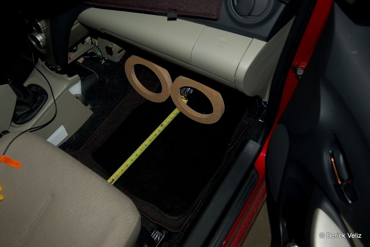

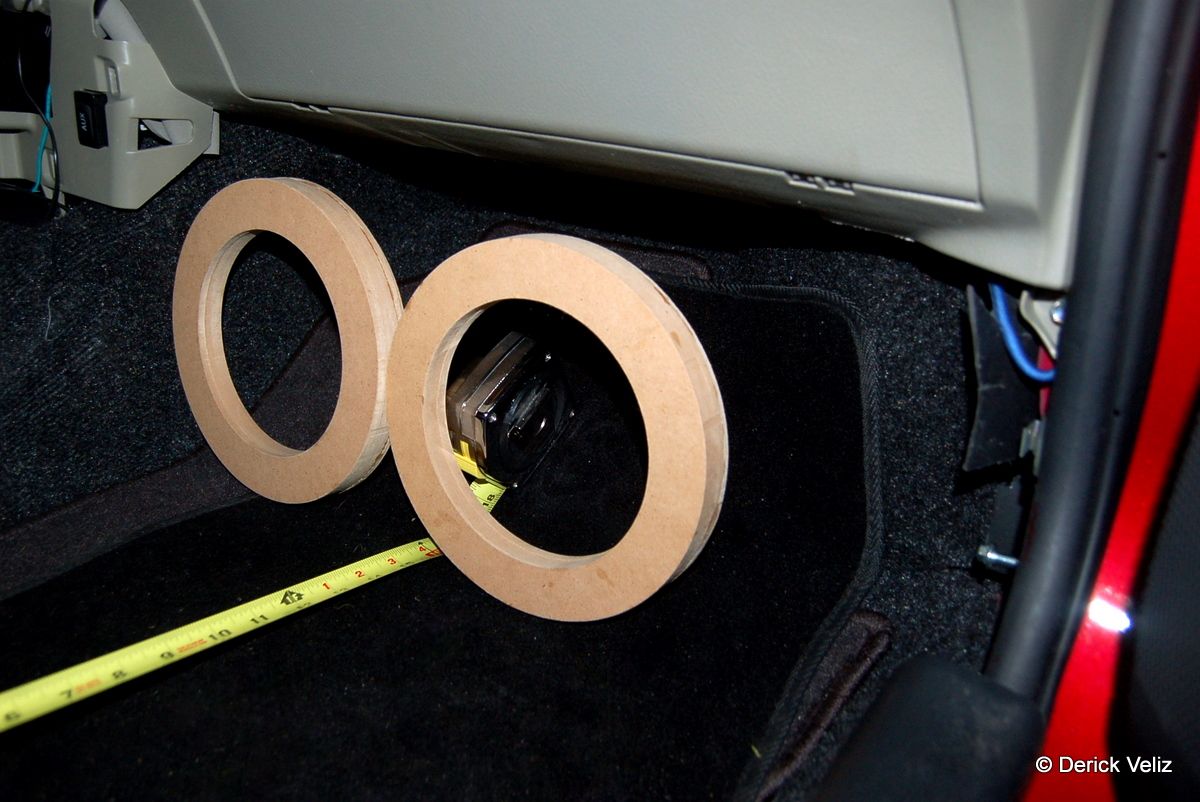

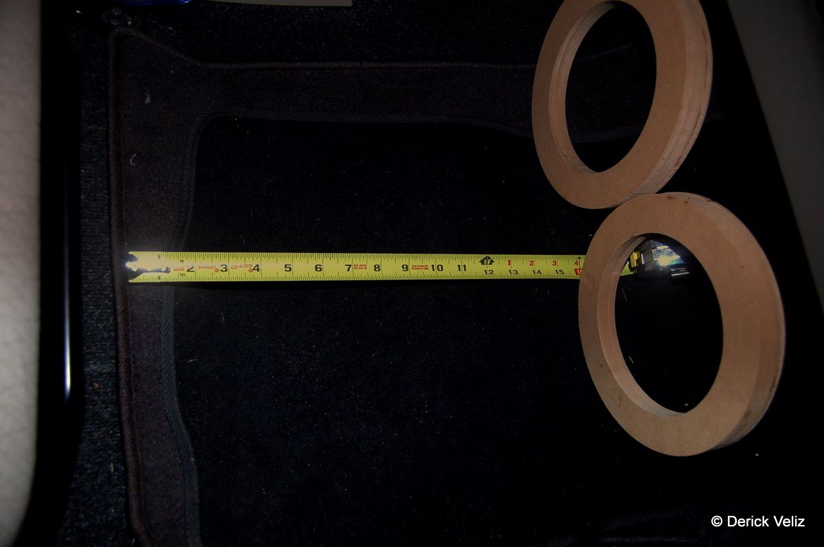

I just couldn't stop thinking about it, here are some pictures with the L6 rings, they are about 8" in diameter. I sit down for a minute to see how bad it is, It's ok as long as you don't want to stretch your legs.
Now I have to calculate how much space is behind there, and take in consideration the thickness of the MDF if any. May have to glass the area and fill it up and check the internal volume.
