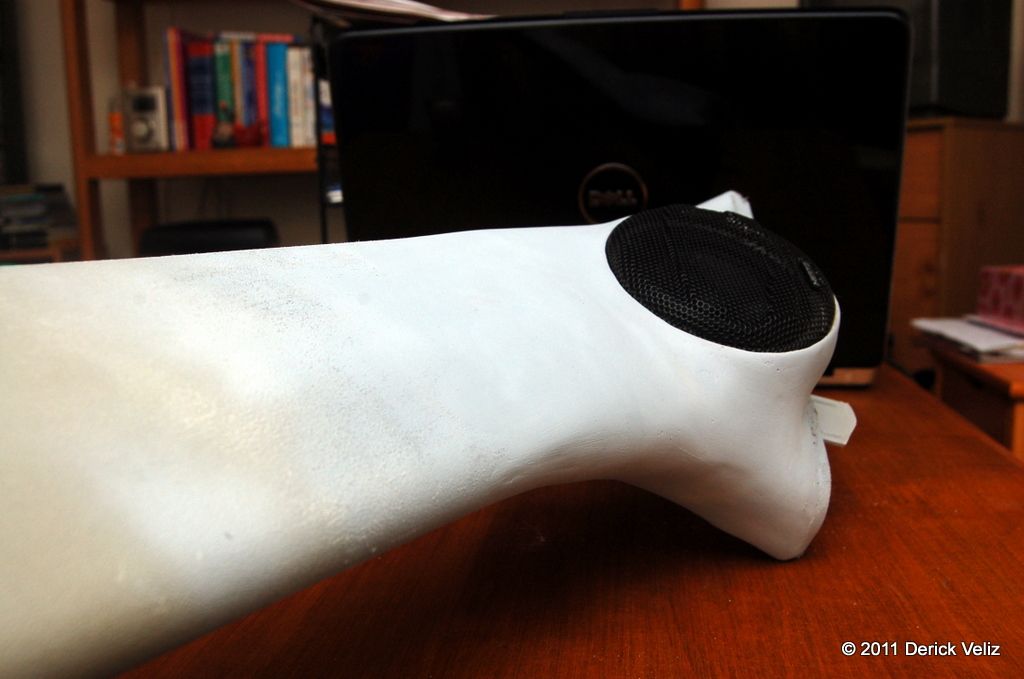

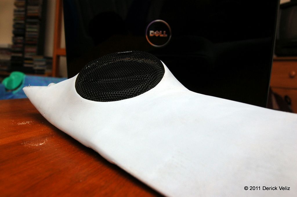

For now, more sanding and a couple of layers of primer, I did open a hole for the L1v2s but the thickness of the glass didn't let me use the plywood baffle behind, but all is good.
I'll upload pictures later for the record.

Pictures... "Work in Progress"

Posts: 2,722
Exclamation

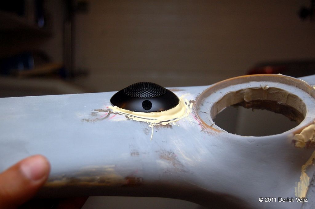

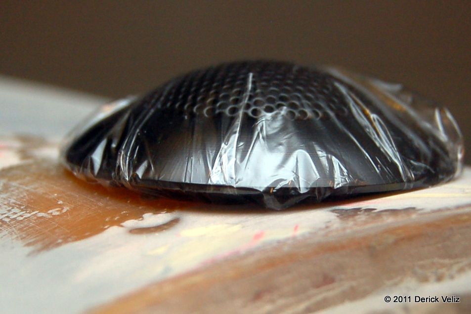

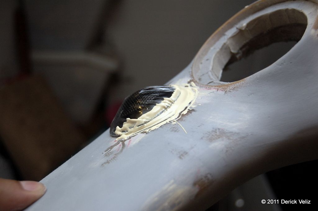

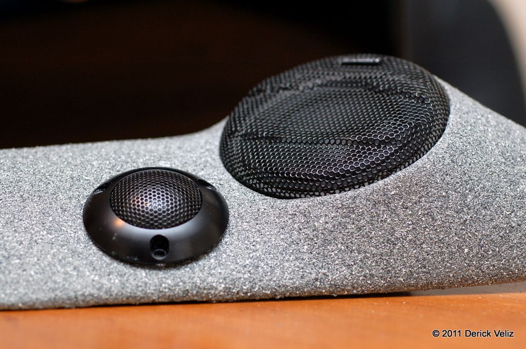

Tweeter Gap...

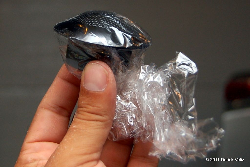

Filling in the space! I learned this Technic securing servos into Foam wings of my r/c airplanes, forgot how we call it, but it's simple and works.
CLA 250, 4MATIC

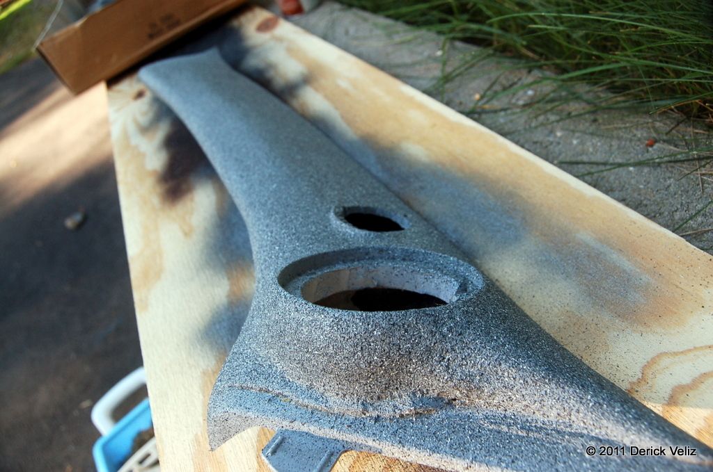

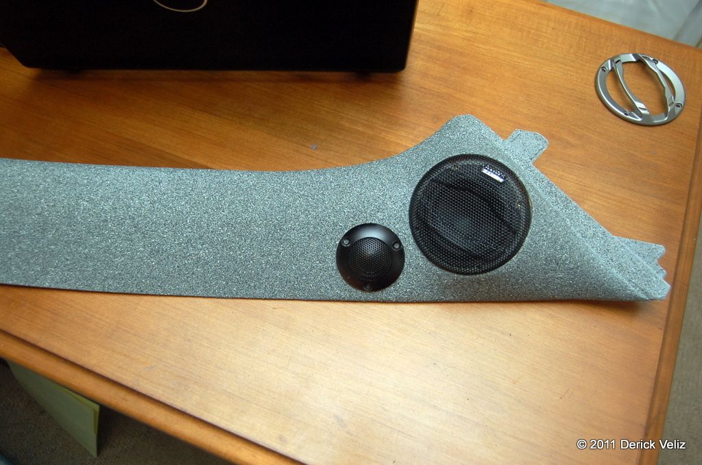

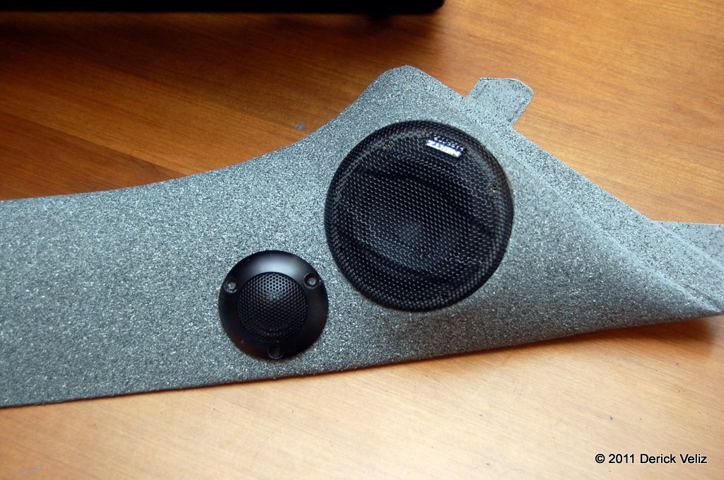

Arrow

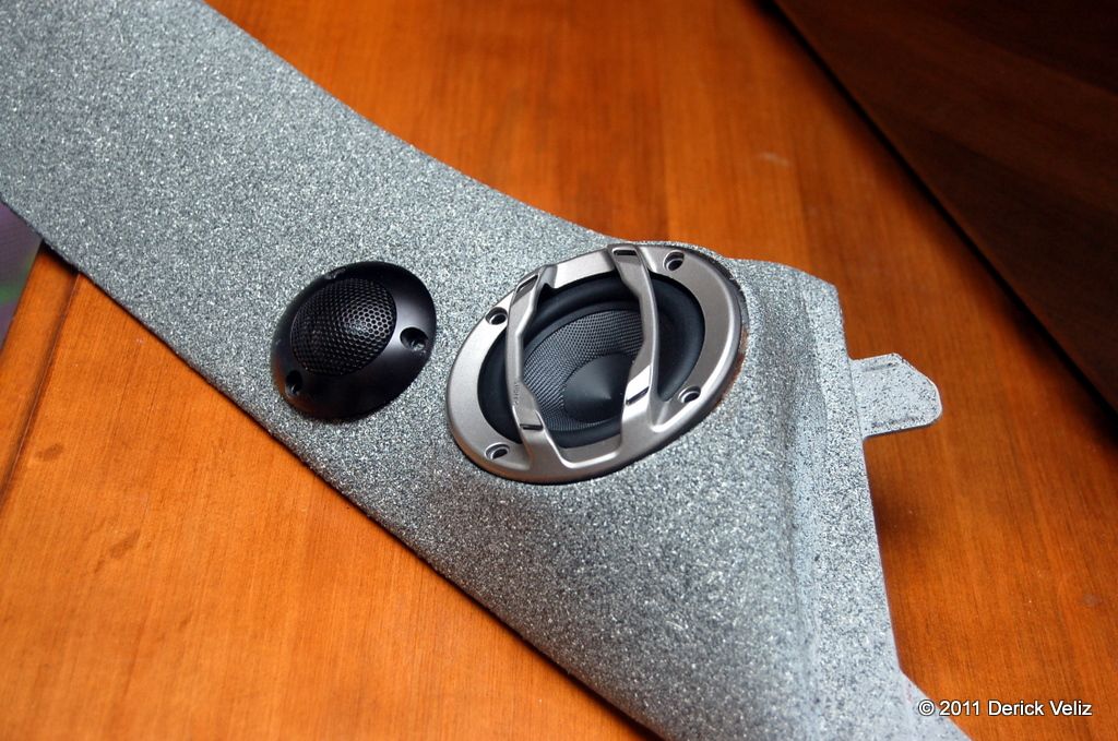

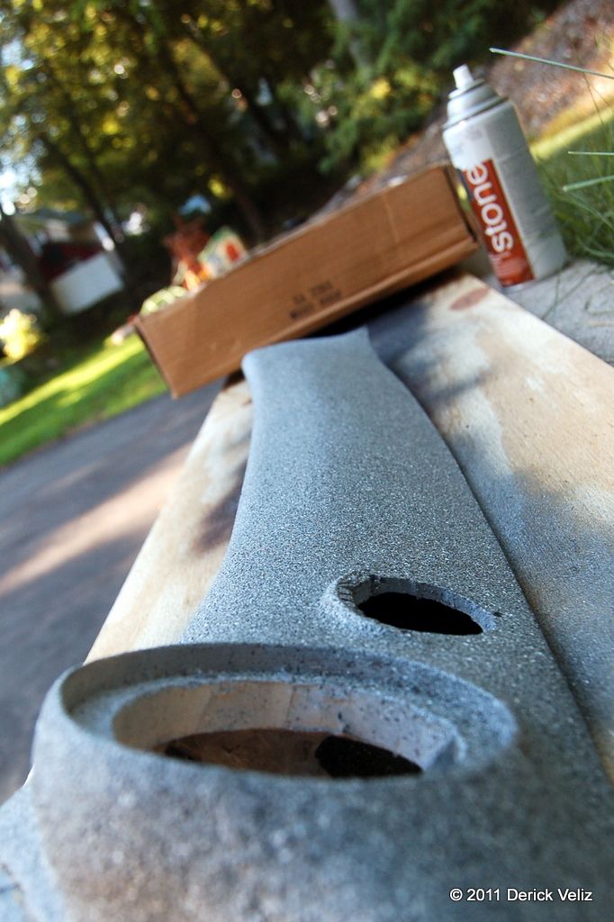

1st attempt to get some texture, final a-pillar finish will be black to hide away speakers. A little stealth factor in my equation!
D.

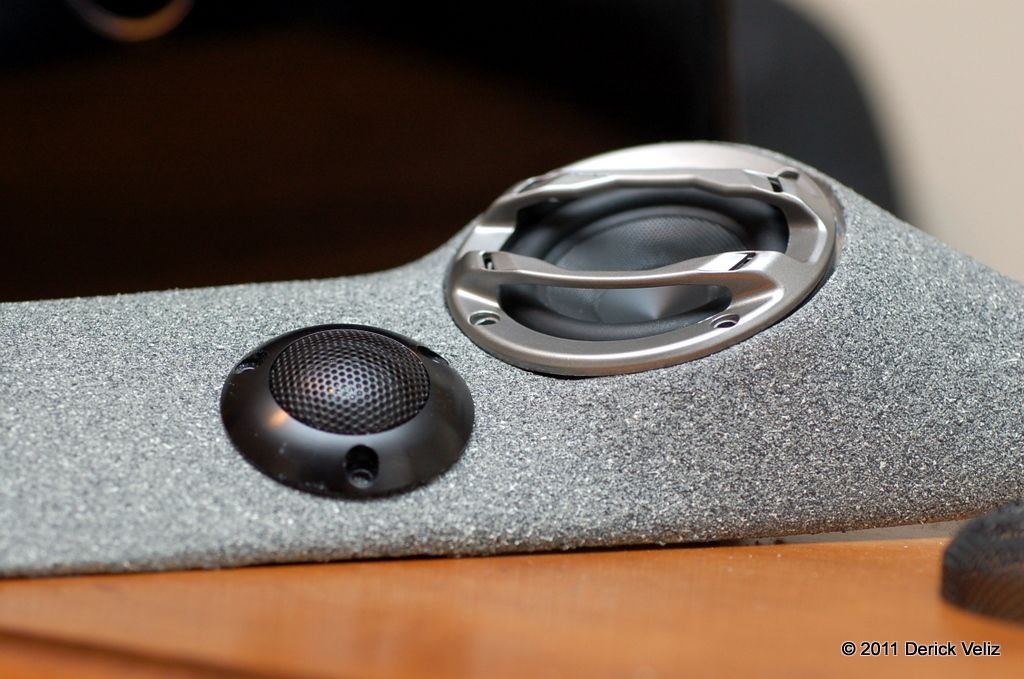

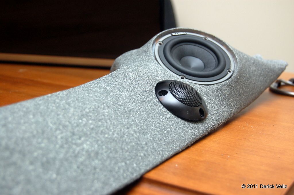

Test fit the elements!...
D.

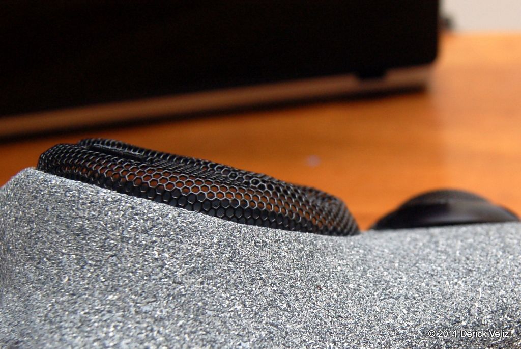

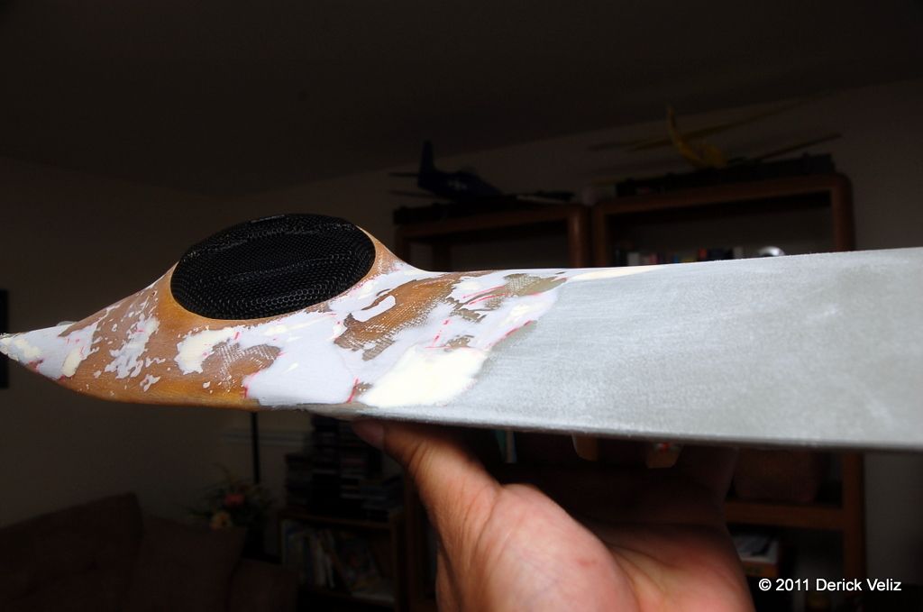

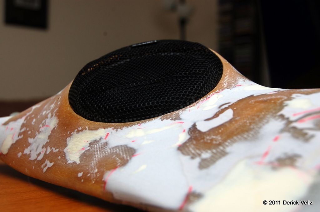

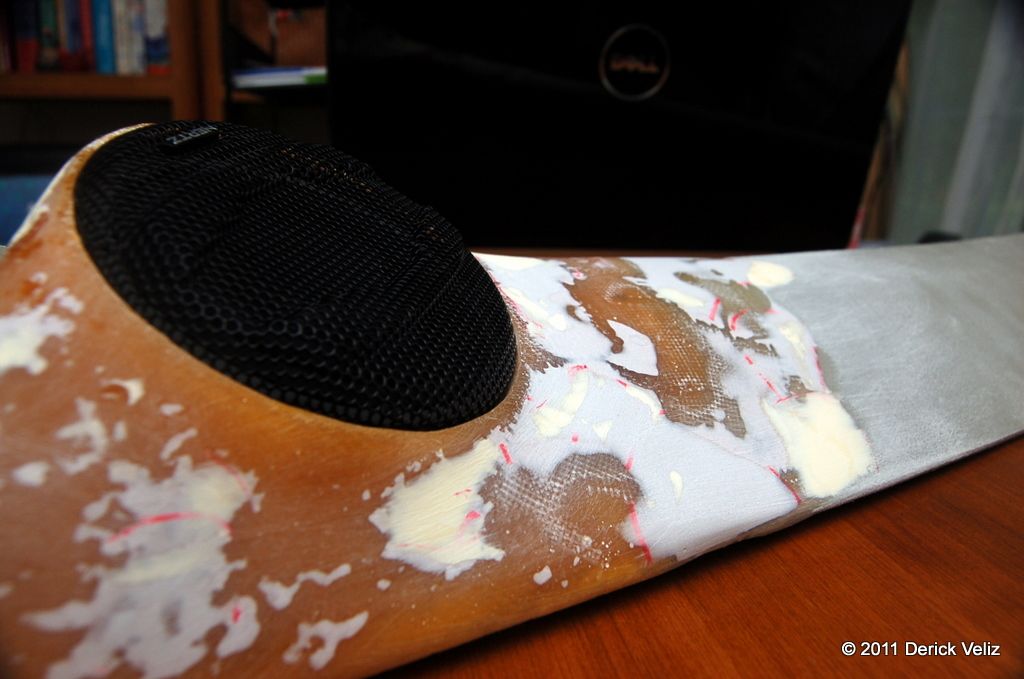

Talk to me about the edge there...
You sanded it down more, correct?
― Thomas Paine
Old 07-25-2011, 03:17 PM   #1419
derickveliz2
derickveliz2's Avatar
Drives: Yaris Sedan "S"
Location: Central, MA
Posts: 2,722
You sanded it down more, correct? YES!
I left on purpose that image, I knew it was going to bring your attention:
- Yes... I did sanded more with this:
- I could have photo-shop the image
-D.

He he! My man! I have learned to love the straight edge sanding block. Tell me about the tweeter...
(yes, I'm being tough on you on purpose)

The right tweeter end up flush but the left one there was a small gap, that I filled in and then sanded out, similar to what you did to the edge of your subwoofer.

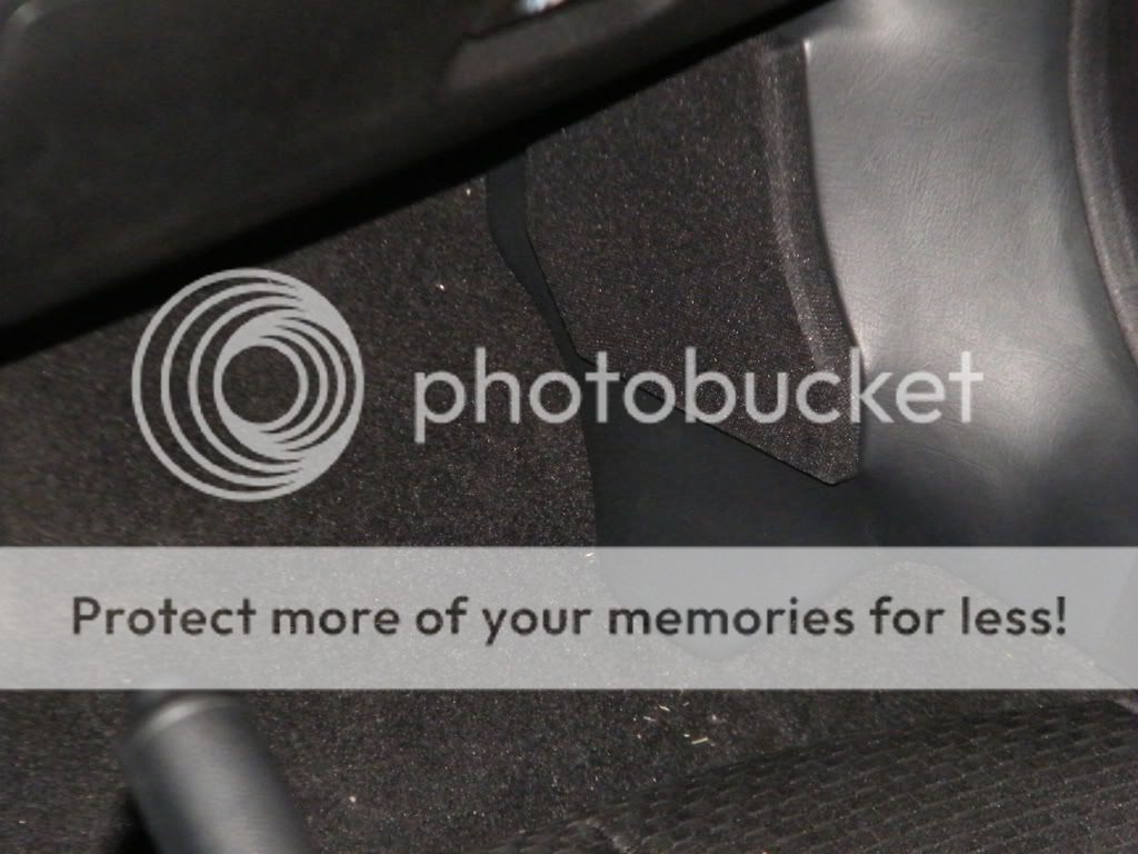

Hey I'm about to try the Mids down in the Kicks, the PLDs turn out to be really good, I want to do this before I plug the Mids on the a-pillars to compare and write my thoughts.
