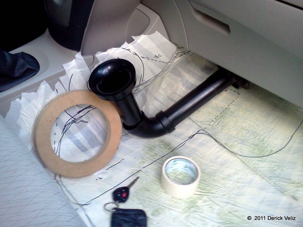

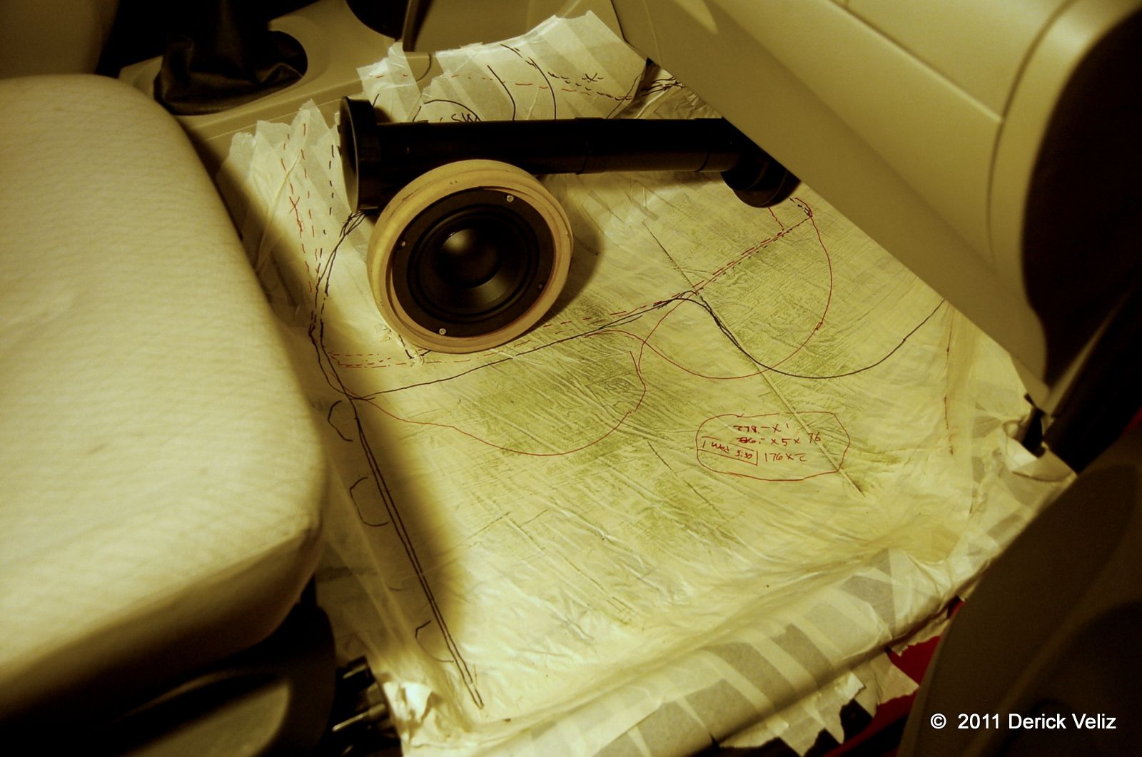

Last week coming back from work I was thinking what if... I had the port in 2 sections using the 90 degree elbow...
The picture below shows what I was thinking, consider the port to be 3" shorter using the elbow. Today I was playing around with it and it's a really good option,
I still have to figure out how much internal volume is, my guess is that it's pretty close!
We'll see:
Sorry for the crappy cellphone picture :(

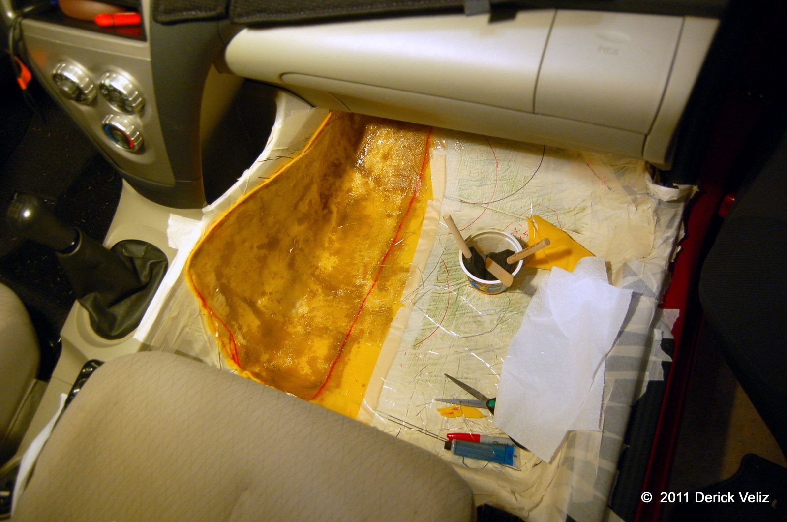

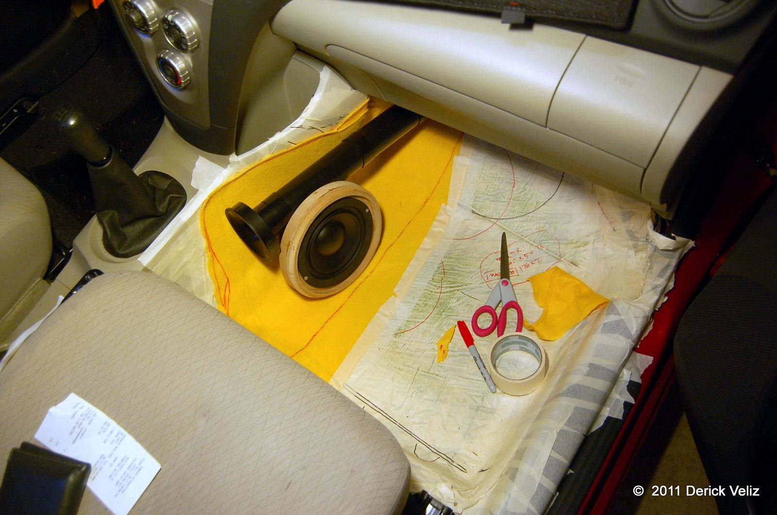

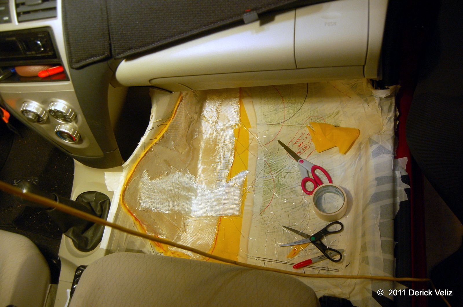

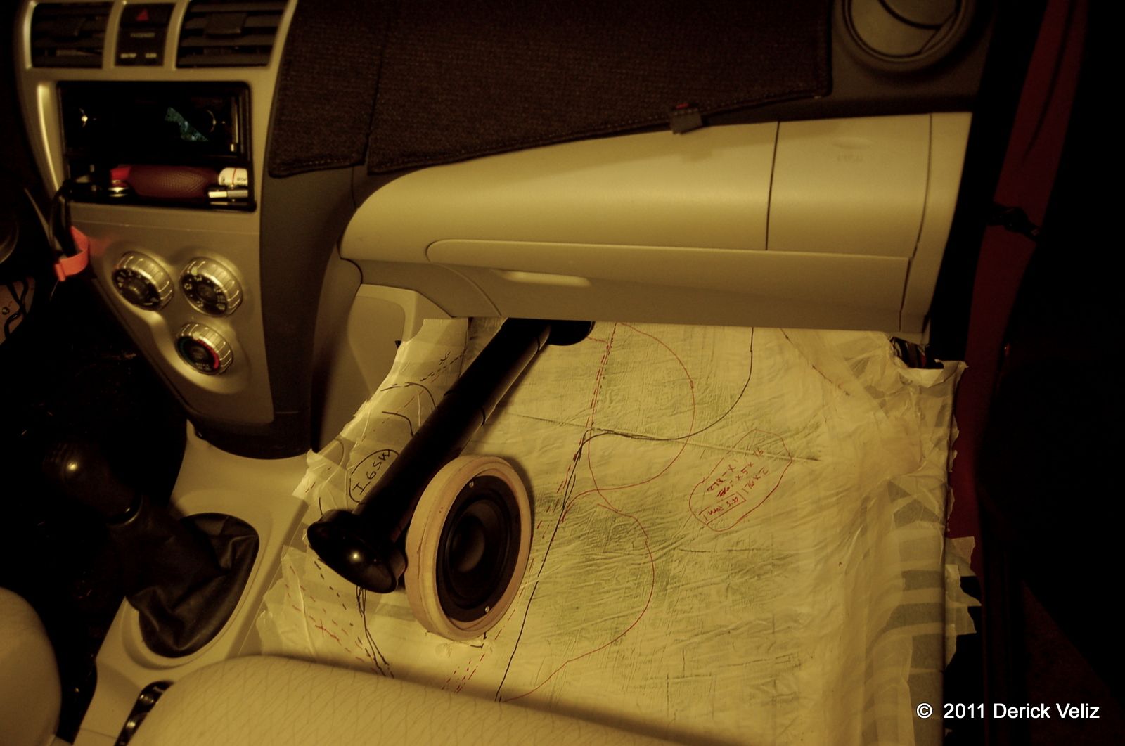

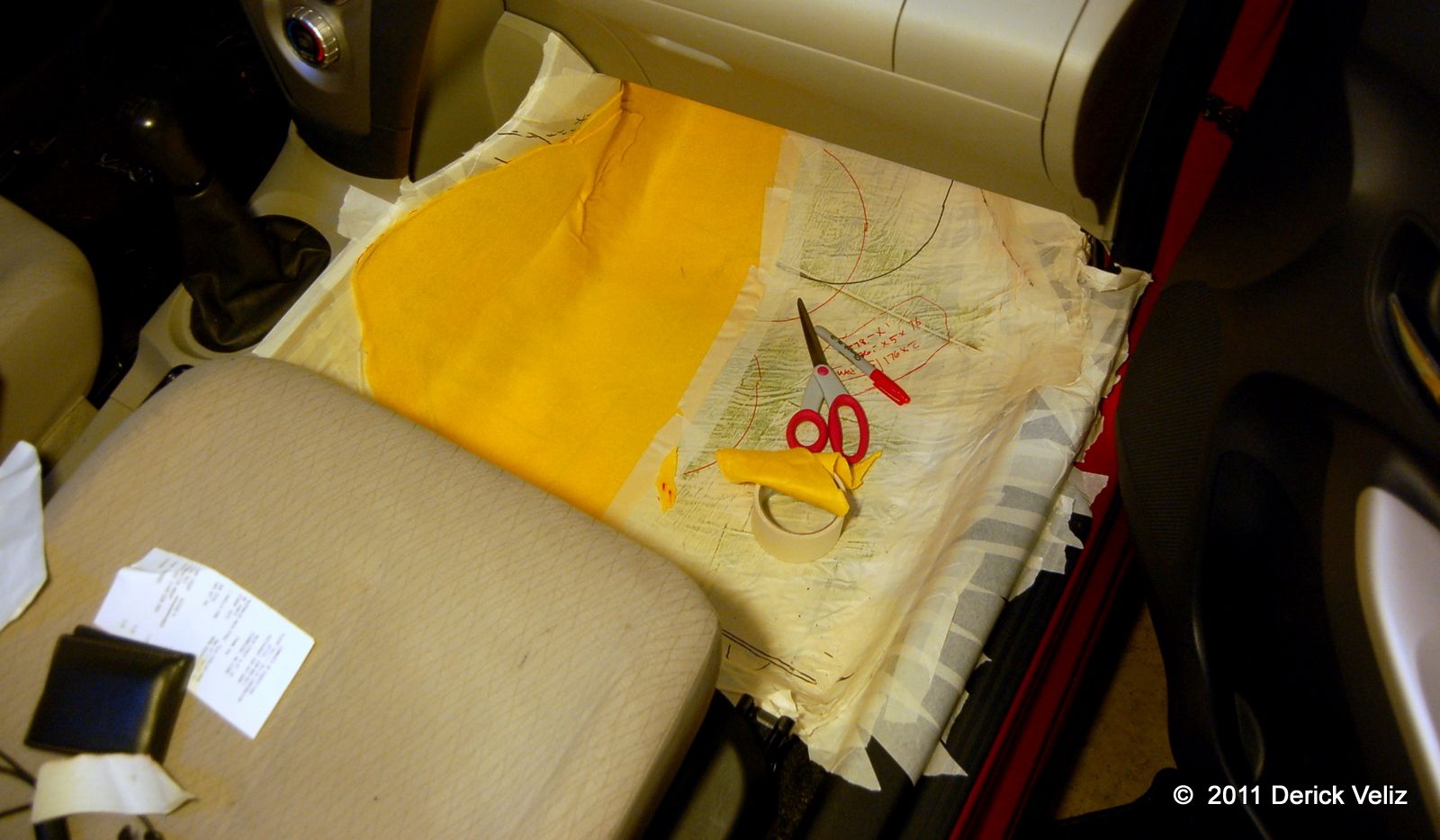

So here is where the I6SW is for now:
This new option, I think it's a keeper with a smaller foot print and just above the 0.35 cubic feet of internal air, the woofer facing the passenger's side and a straight vent towards the fire-wall:
Some spray 3M super 77 and fleece:
Last night I did 2 more layers on the vertical side and trimmed the edges, so far is gaining weight.
D.
