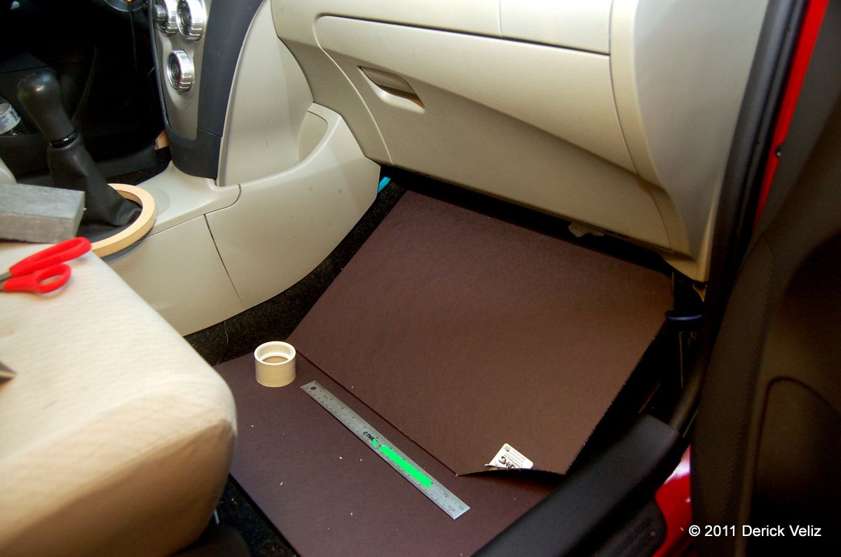

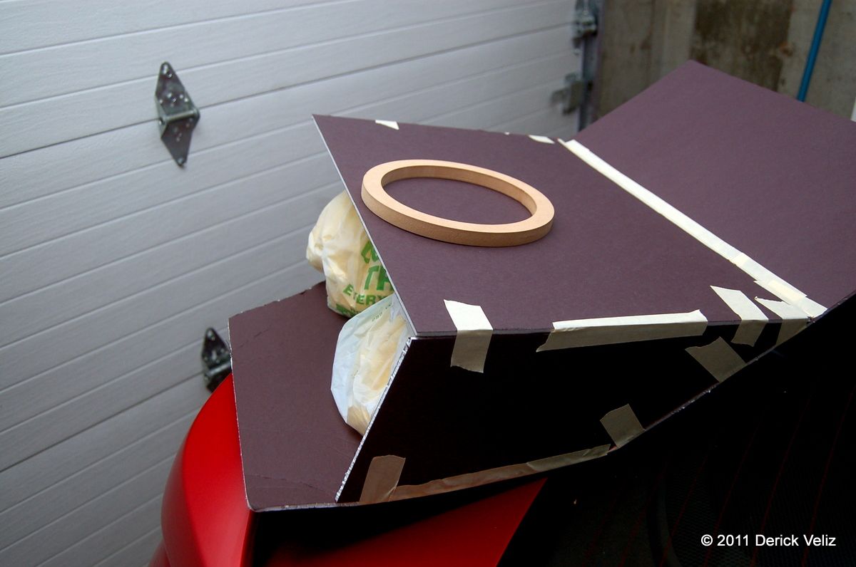

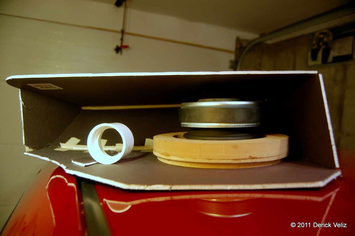

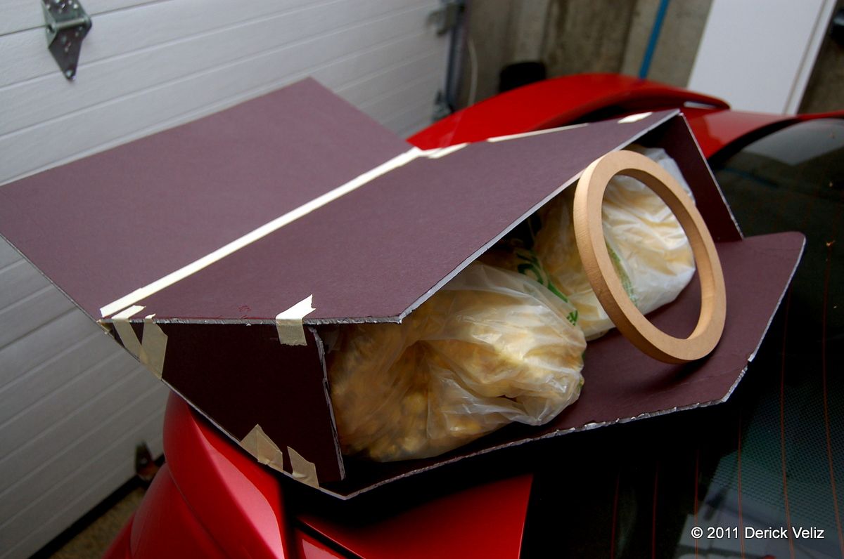

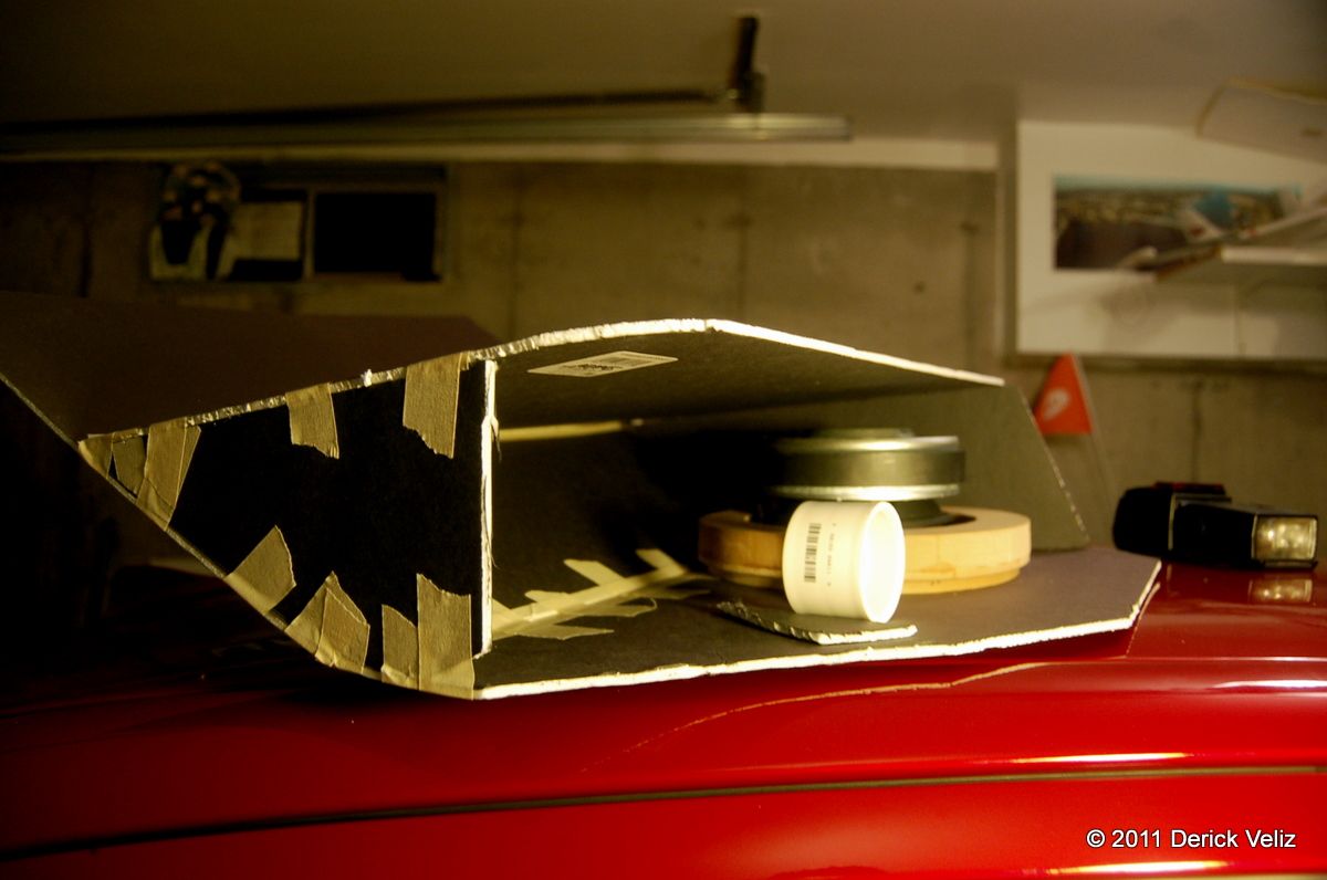

I made a model (mock-up) of the subwoofer enclosure, pictures tonight!
D.

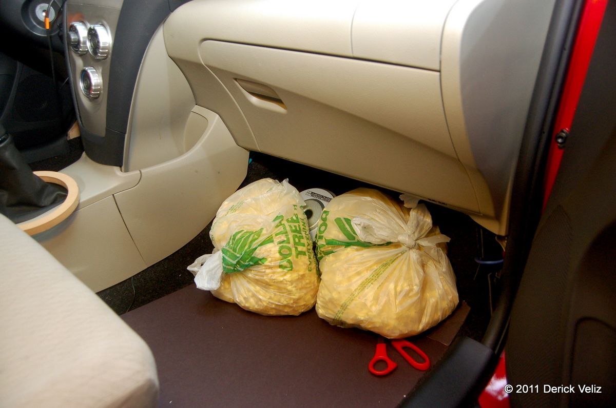

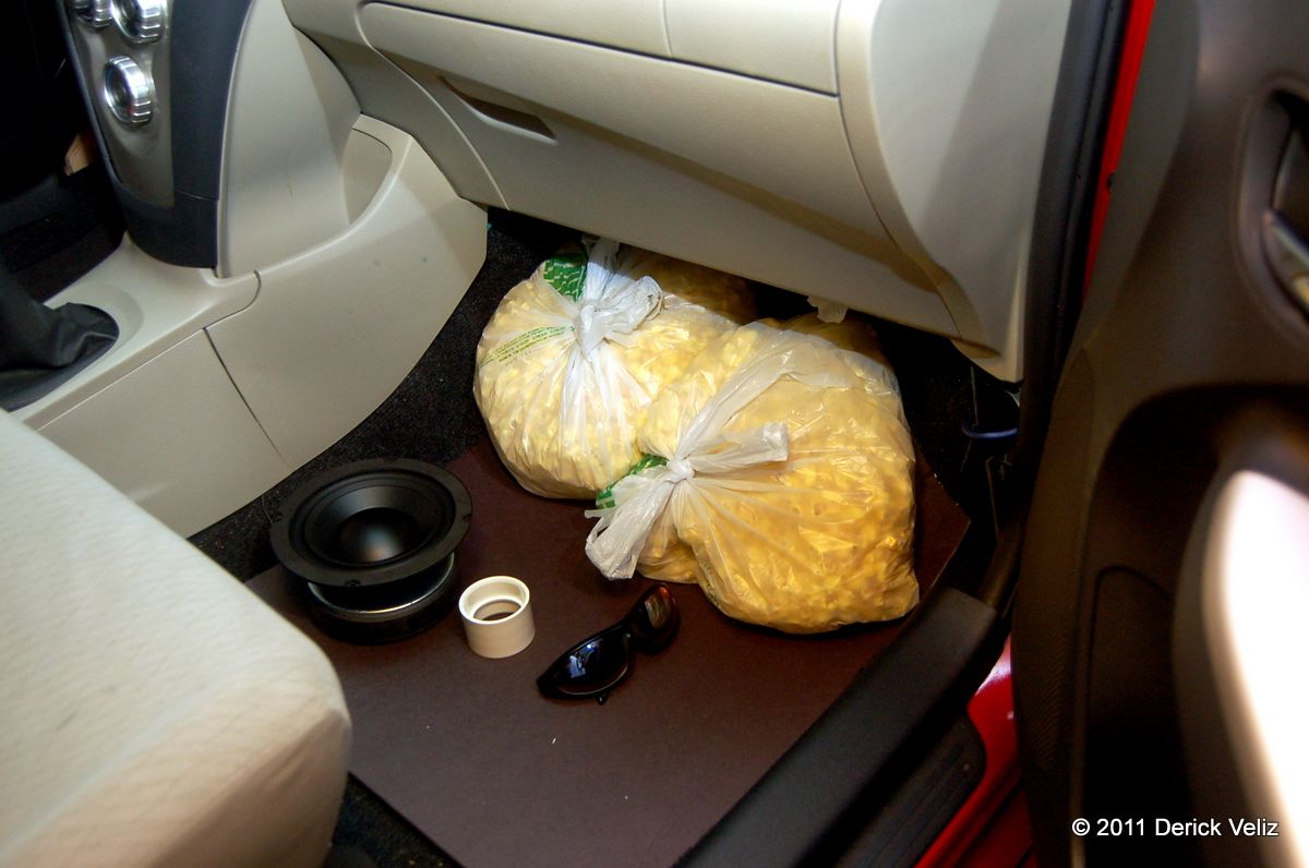

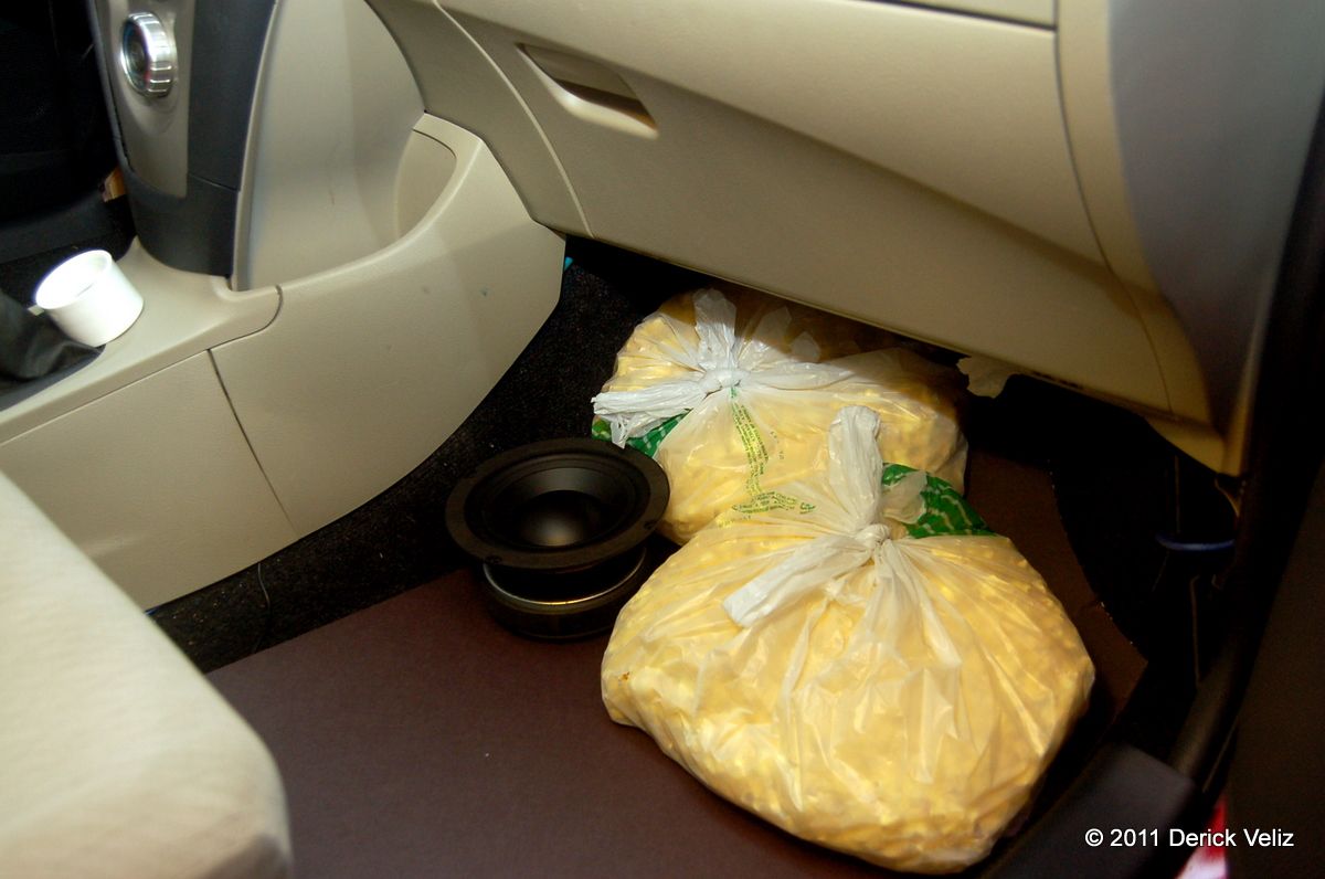

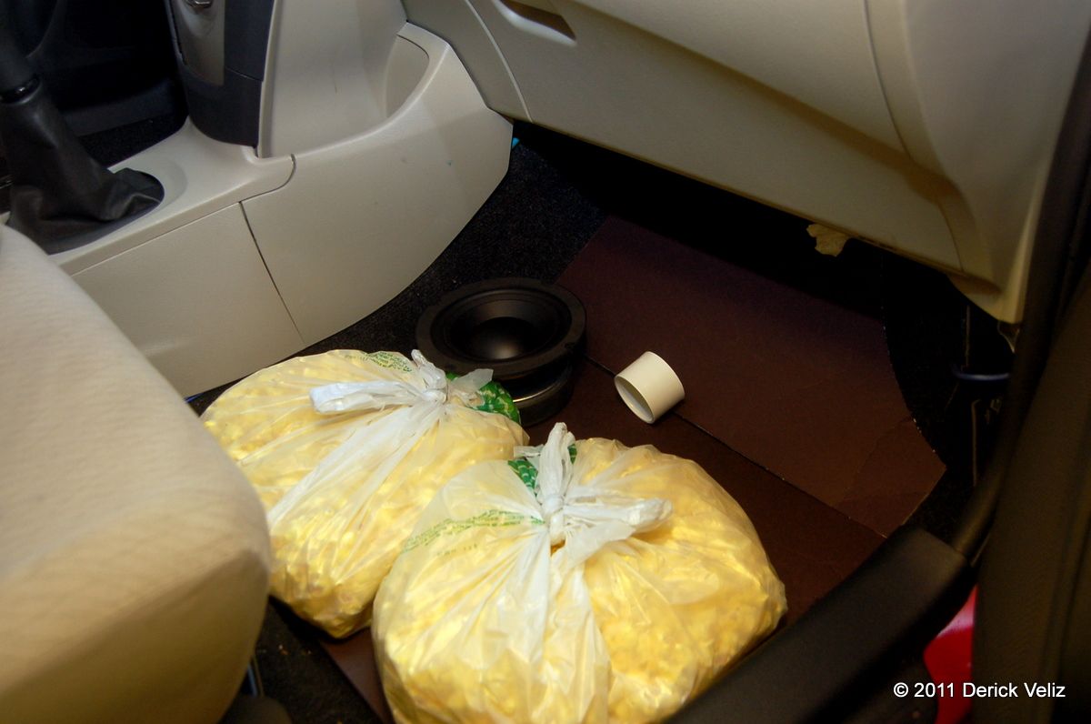

Designing the enclosure for the I6SW:
Ok, space required 0.35 cubic feet = 9.9 liters lets call it 10 liters
So I got some pop-corn and filled a couple of bags with 10 litters of pop-corn and ready to go:
D.

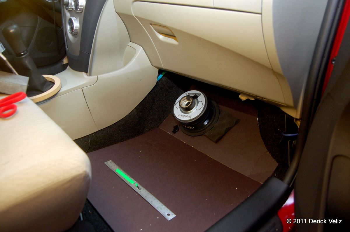

I wanted to see the woofer in the original designs but for many reasons will go facing down. I'm providing extra space for the cone to "move" (o:

Posts: 871
Why would you face it down into the carpet, vs facing up into the cabin? I realize there's a protective/ hidden factor, just seems it would muffle the sound badly?

Exclamation
Besides many factors like protective, away from heat vent, easier installation, etc. It's a ported box so all the bass will come out of the 2" vent that will face towards the fire wall!

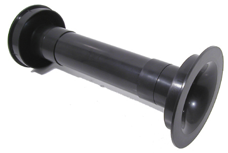

I'm waiting for the 2" port...
From Precision Sound Products
I also need to get a 2" PVC-90 degrees elbow, from Lowes, the port needs to be almost 16" long.

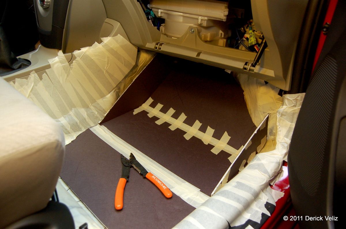

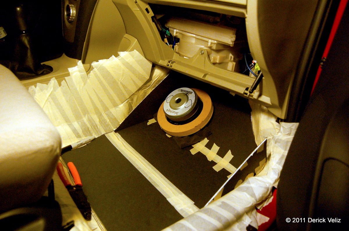

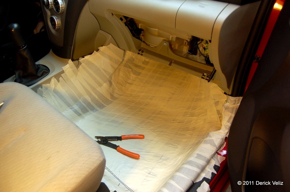

OK, 2 a.m. again
Tape night! there is something about this that I have no patience...
So the floor is not flat, there are some curves and bumps, to mold the cardboard I spray cleaner to the back and then let it sit with lots of weights on top, a day under the sun and will evaporate the liquid and hopefully the cardboard will hold it's shape. (and stay clean lol)
Next would be start glazing!
Any clues about integrating MLV to the subwoofer enclosure build up? or I'm just acting stupid?
D.
CLA 250, 4MATIC

Now, to you Derick.
Why don't you simply glass the floor? You've got everything taped...
Also to those who don't understand about the aiming of the woofer, as with mine:
The sound is omnidirectional. That being said, there is a feeling difference between a standard forward or up-firing woofer and one that is downfiring. I feel my bass a LOT lower...pretty much from the bottom of the seat and through the body of the car.
The MLV IMHO should be applied to the inside of the enclosure once it's formed.
Also, D...I'm thinking that our resonant frequency is at 42 Hz. See if you can find a 42 Hz tone and run it through. You now combine that frequency and combine it with the tuning frequency for your enclosure of, oh let's say 38 Hz. Then that extends the response of the enclosure to fit your vehicle's response more accurately.
