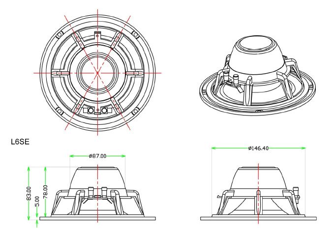

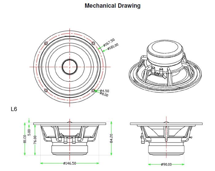

Roadrunner Jr.
sqcomp's Avatar
Location: Back at home
Posts: 2,609
Remember that SE magnet is smaller than the regular L6. Neo magnets rock! I clear the window easily...especially given the 1/2" adapter/spacer I made.
Look closer... L6 are not as deep... it has a bigger diameter magnet though... no doubt the L6SE are better speakers all around and look much cooler.
