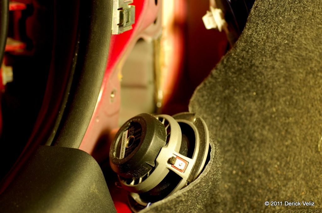

Ok, I just had some fun with my dremel, sparks and every thing else! in the A-frame!!!
I made enough space to get the HL-70 (MIDs) in there, thinking that some day I'll put a L3SE.
Pictures to follow...
D.

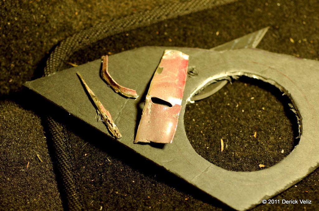

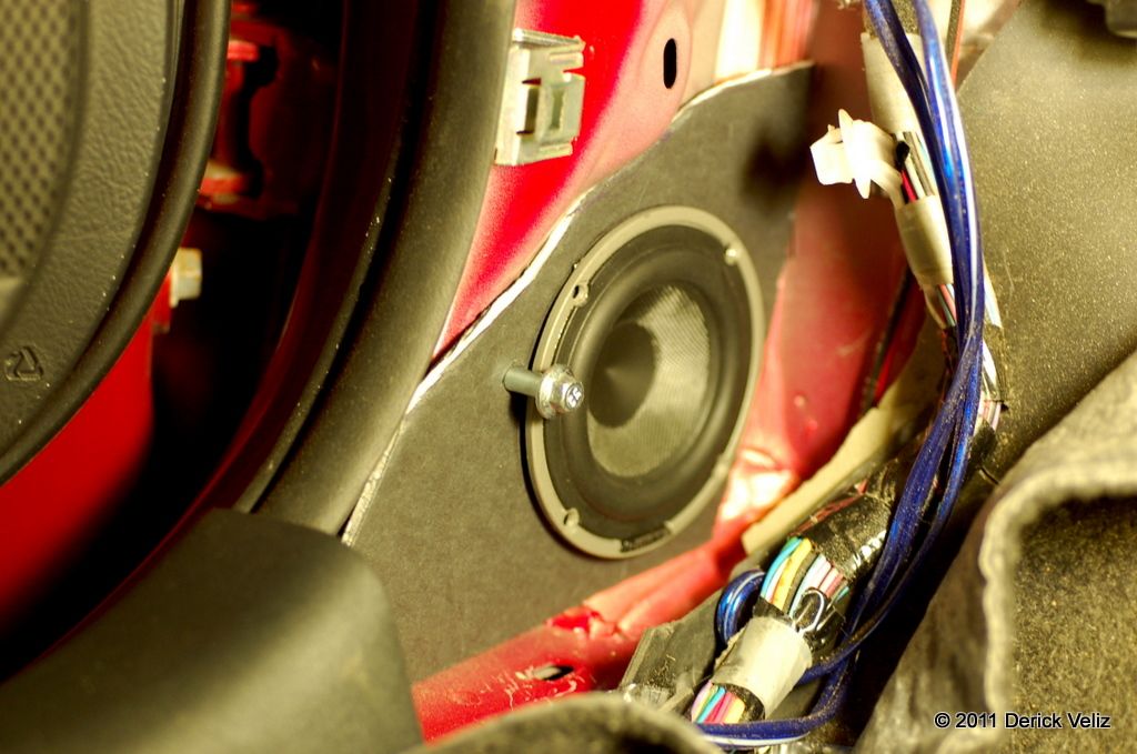

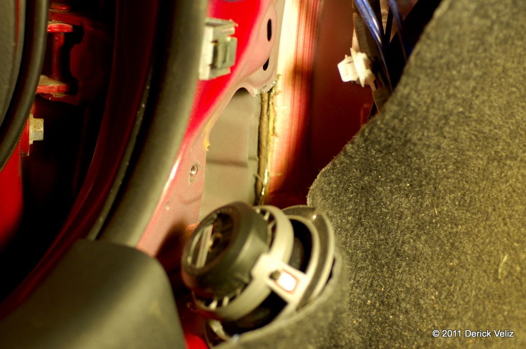

Here is the A-Frame Pilot's side remaining parts over the template I made, this is to build the baffle:
After cutting the metal, I have enough space for my speaker:
The A-frame with the HL-70 all the way in:
The A-frame with the HL-70 with template:
I really don't know how I'm going to manage all the wires, I assume it's "ok" to leave them next to the speaker, because what I really want is the Off-Axis response...
D.

I've produced some glass shells that fit onto the side there in the kicks. I want to change the angle upwards on mine.
When you plugin the crossovers between the mid range and the tweeter, look for somewhere around 3.5 kHz to 5.5 kHz.
I know that my stage is about an inch or two above the dash with the mids down in the kicks. It's lower than with the mids in the pillars...BUT...you have a bit wider of a stage and still get to keep the center image.
If you want to scope out some L3SEs, prowl around the hybrid audio forums and ask. I would imagine a couple of the guys have a pair that they might sell off. It can't hurt to ask. Also, don't hesitate to drop my name with the team guys. They might charge you double though. :)
Why aim up? just curious.
Yes 3.5 kHz that's where I'm right now as a 2 way and works great, the stage is like you have it, and overall sounds much better than with the3 way and the MIDs in the a-pillars.
I did cut the right side, but my dremel needs some spare parts to finish. Jeje can't wait to get the 3 way working again with the MIDs in the a-frame.
