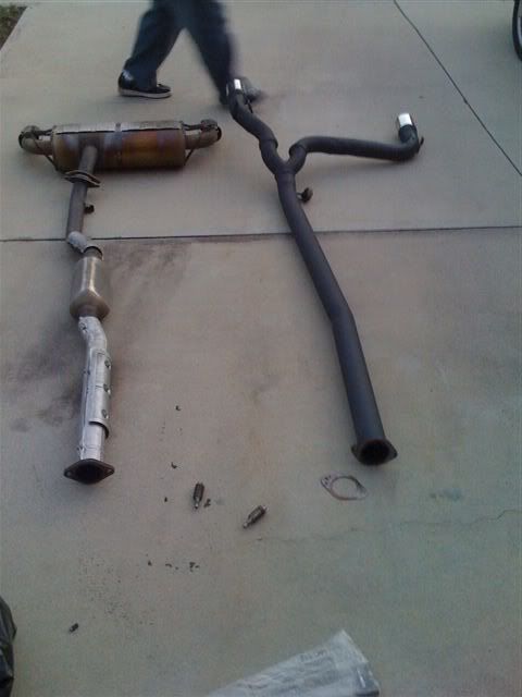

True that. I just helped a buddy out with his Evo X. The shop used aluminized tubing, and about two weeks later we pulled it off to paint it (for him, it was about looks). The welding was showing some surface rust, but the tubing was looking okay. Some prep work, a couple of cans of high temp in flat black, and it looks pretty good.
at3GG / Racerfreak: You can do like this guy. No need to hack up your stock exhaust. He had an entire exhaust made up. He needed to take it to the dealership for reflash, so he swapped the stock exhaust back in. Didn't take long either
