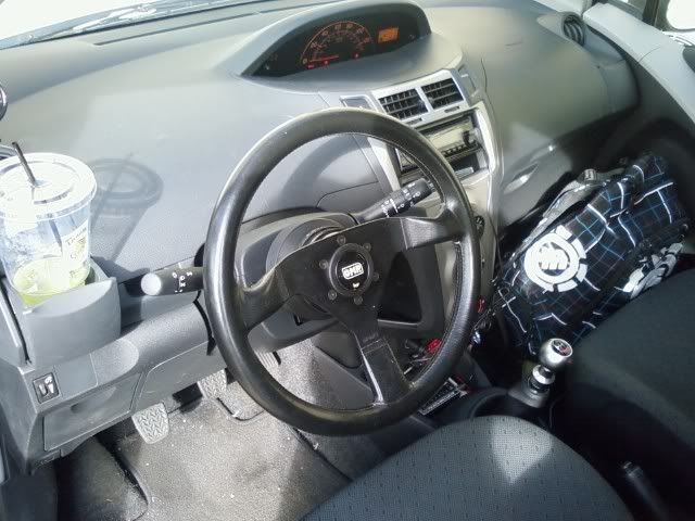

i have a works bell short hub and nrg version 4 quick release as well as a works bell nardi-momo adapter and a momo steering wheel from an 84 ferrari 308. :) works great. may not be as baller as blacksandiegos but it will be eventually.
and cali is correct. the works bell adapter is the only one that bolts directly on and retains the clockspring. just make sure you get an extra male resistor to get rid of the airbag light if it bothers you.
i know it has an omp horn button...i know the wheel is a momo. ill get a new horn button eventually. also, pardon the messy car, i had to drive for work to make a few parts deliveries for a few hours.
