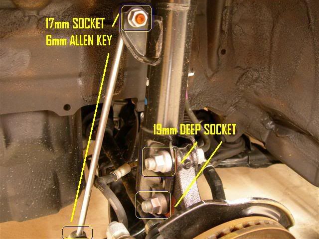

does anyone know how to take off the 19mm strut bolt? I got the top one off by luck, but the bottom is so stubborn that it already broke two 19mm sockets.
Im going to buy some WD-40 and more sockets and try again in 5mins

Drives: Polar White Yaris HB
Location: Honolulu
Posts: 263
fuji is offline   Reply With Quote
Old 06-18-2009, 08:24 PM   #18
Taiyaki
アキバ製
Taiyaki's Avatar
Location: Honolulu, HI
Posts: 524
Yeah~ hahaha or maybe this skinny japanese boy isnt strong enough to loosen it... *sigh* haha hey fuji, how much of the bump stop did you cut?
