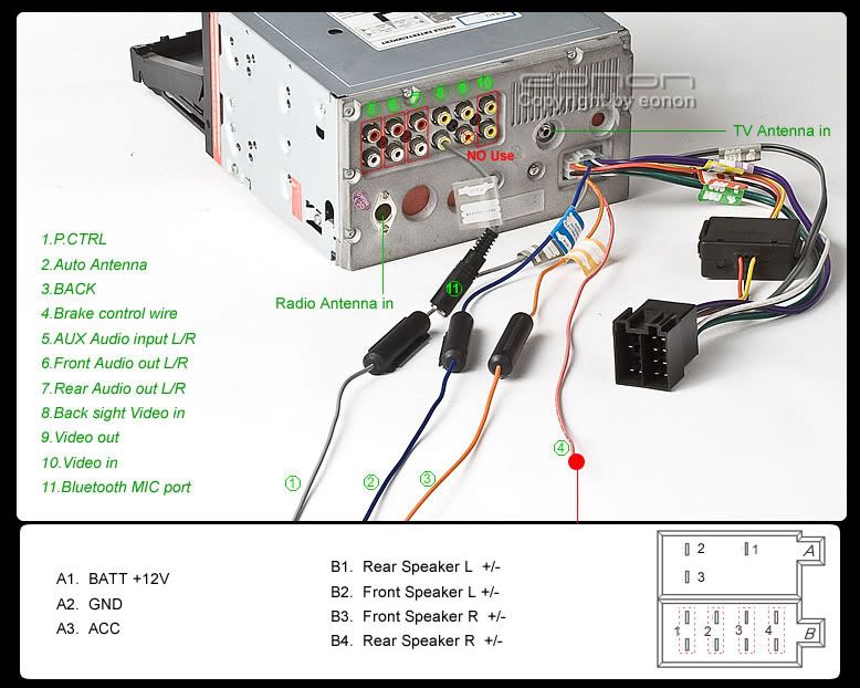

can you post a scan or link to the wiring harness/diagram from the installation guide to your new Head Unit/DVD player?

Posts: 7

Here are the threads w/ DIYs on using the stock aux jack w/ aftermarket HUs.
'09LB:
http://www.yarisworld.com/forums/showthread.php?t=11849
'07/'08LBs:
http://www.yarisworld.com/forums/sho...d.php?p=199347
Hope that helps.
