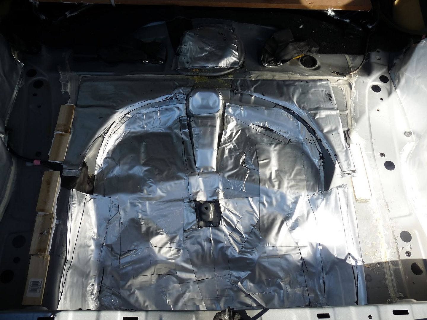

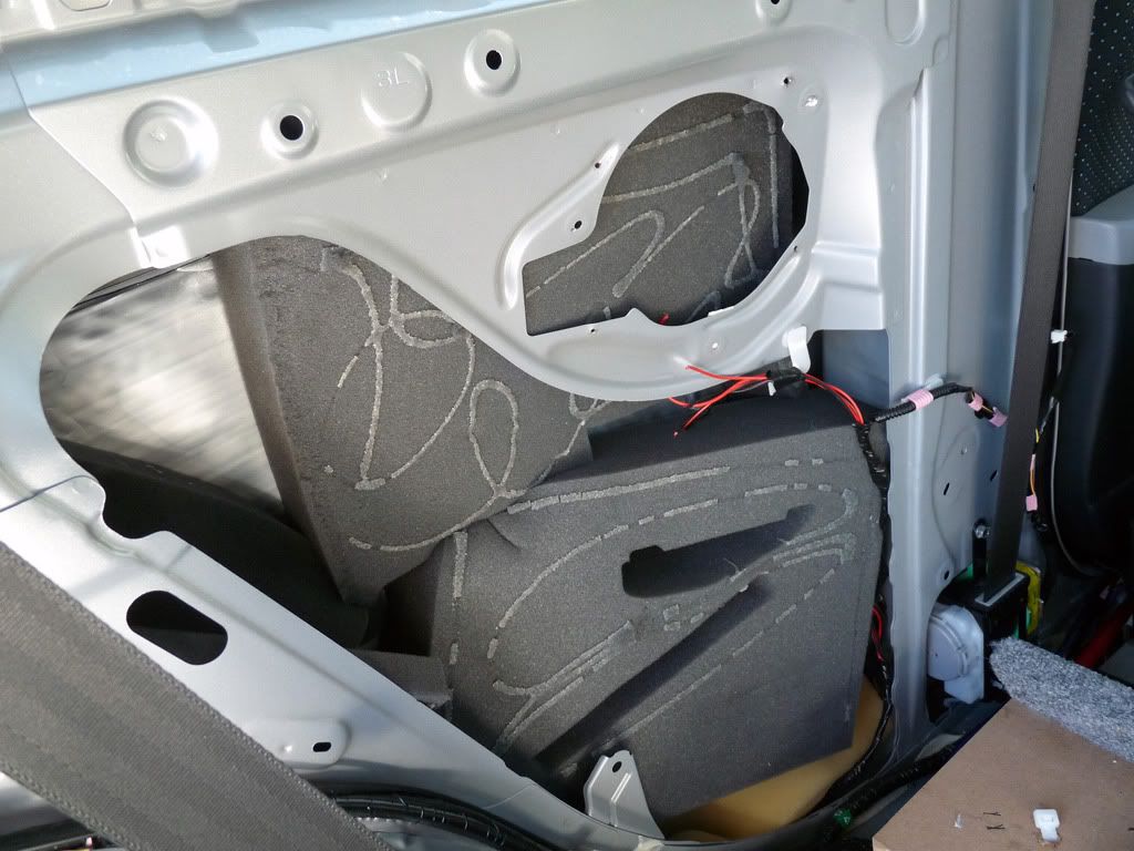

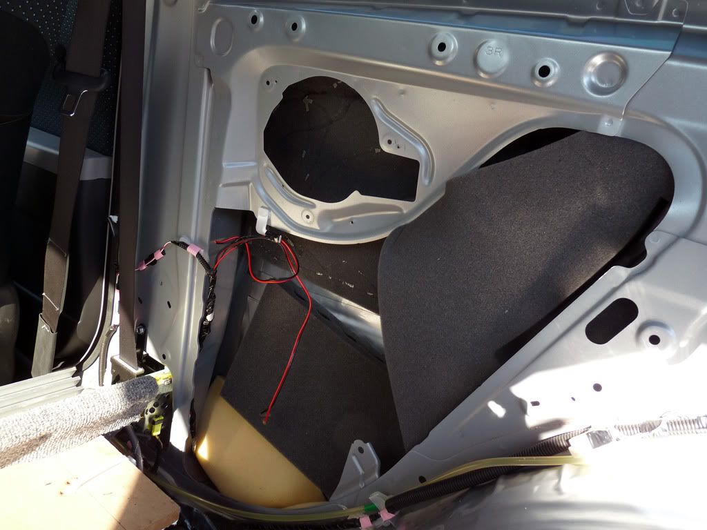

I managed to hijack a bunch of padded foam for shipping from my work. Im going to spray adhesive onto the panels behind the rear speakers that already have 3 layers of edead then put the sides back on and call it done.
I still have to use of the last 1.5 rolls of edead on the floor where the real noise is.

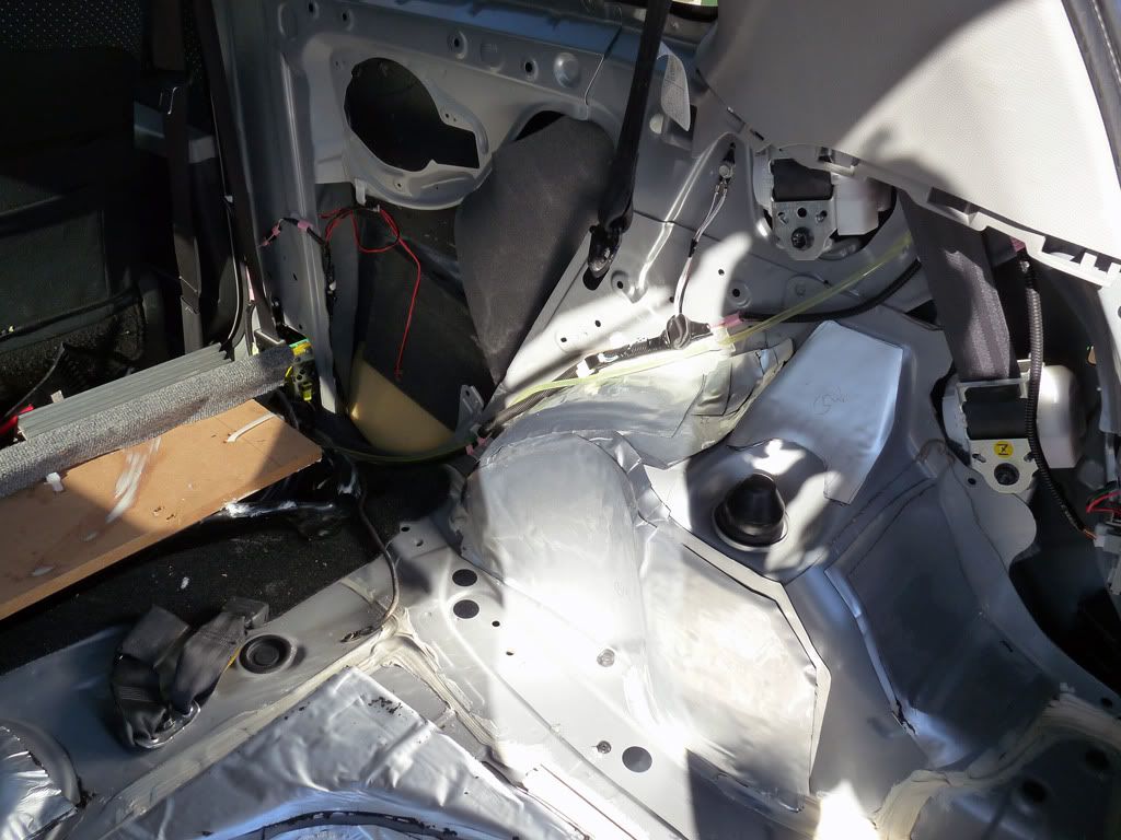

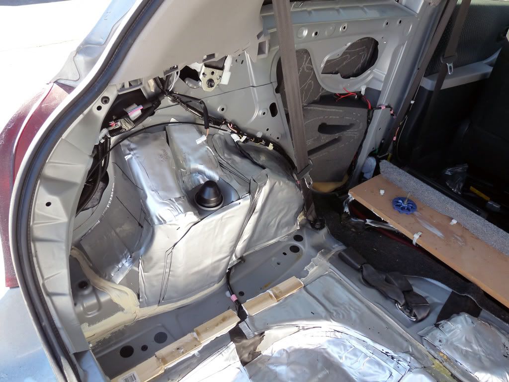

had to take out some of the foam pieces but I instead just stuffed them farther back in the wheel well if I could.
It's definitely a good deal more quiet now and thats without having the 3/4" carpeted MDF deck in place.
Ive also still got like 20 sqft left and everything got at least 3 layers, a fair amount got 4.
