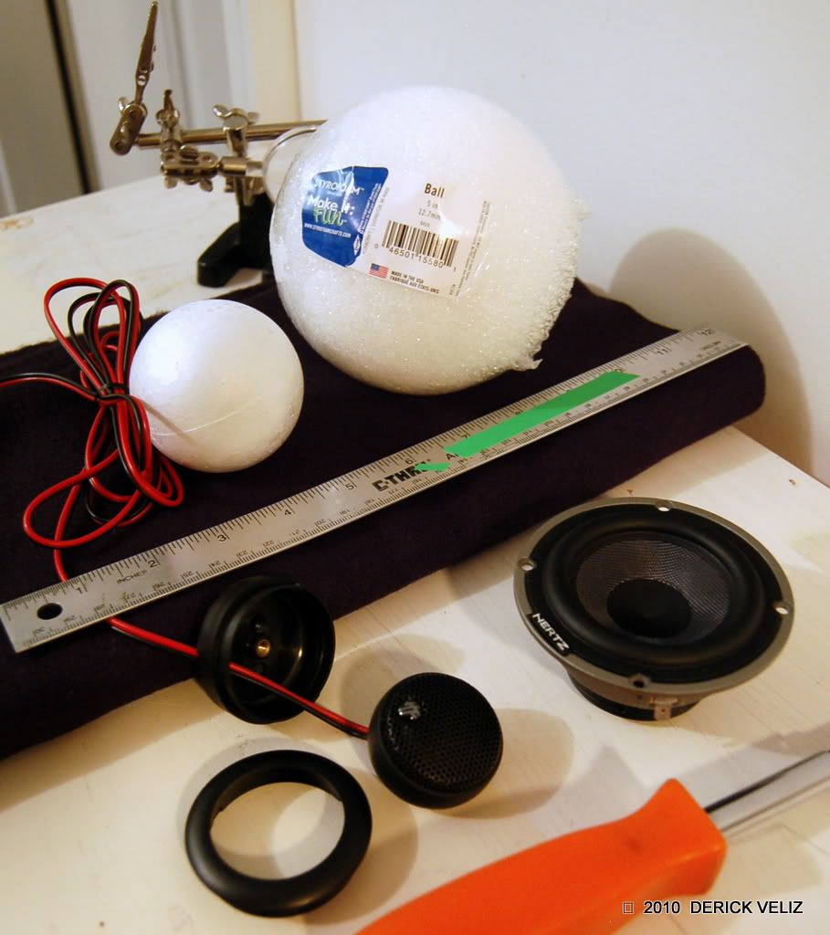

Last night I started a crazy idea!!! crazy because it's unusual, new to most of us, just like deadening a car with MLV as a noise barrier and only applying Mat to 25% of the metal surface to control panel resonance... This new concept or idea it's called...
Diffractions

I'll post pictures of what I did last night! about this crazy idea, and if you would like to read more about diffractions... follow this LINK

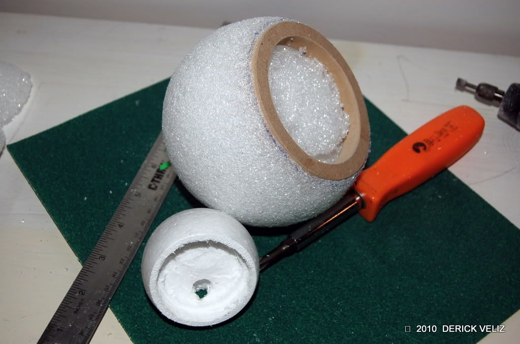

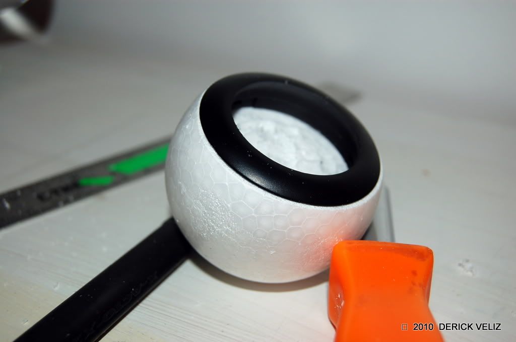

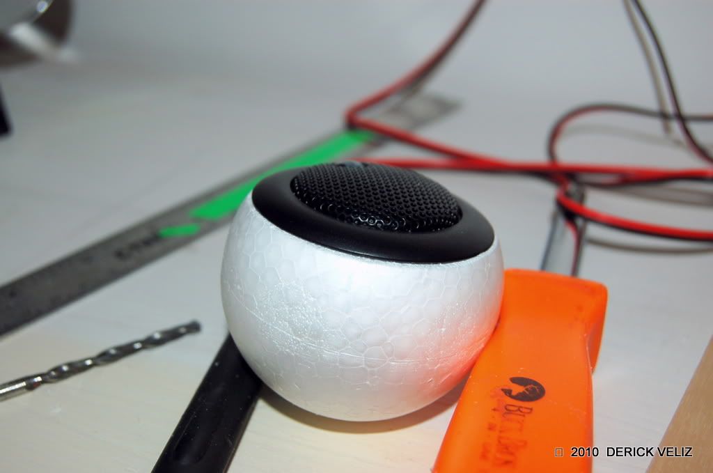

Here are the pictures of my new project...
I tried the left tweeter today and holly cow the tweeter disappears I can't located. And for some reason sounds much clear and crisp without been harsh compare to the one without the sphere, and did a quick test I put the sphere on the right side and I got the same results, I like it.
When I started reading about diffractions I just didn't understand it, but there is some thing there that it's working. It's like the MLV I just didn't get it at the beginning, if this turns to be a very ugly idea I will keep searching for more options, or at least I could say, "my car has big balls!"
