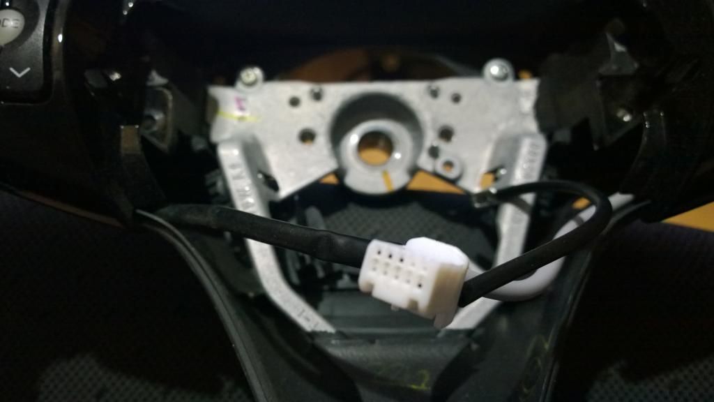

hi scott, i know this is an old thread. but after thorough searching online and in yw, I've come to conclude that if the clockspring connector below the column (white 10-pin/12-pin, the one beside the yellow one for the airbag) only has an X number of wires, then there are also X number of connections you can make with the connector to the steering wheel itself.
Example, if i have only 3 wires there, and since one of them is for the horn, i can only use the other 2 for steering wheel audio controls, bluetooth or cruise control.
Is this accurate? I mean, can we not "pin" the white connector below the column and also pin the connector on the steering wheel? in other words, does the clockspring ribbon have wires inside for this?
Old 10-08-2014, 06:12 PM   #10
Posts: 13,460
That is correct - What you see for pins on the black connector is all that is run through the clockspring.

here's the connector on the JDM audio control for reference.
