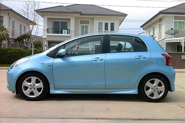

[Fitment Report] 185/65R15 w/ H&R Sport springs (1.25" drop)
SUCCESS!
No rubbing 100%.
More details to follow.

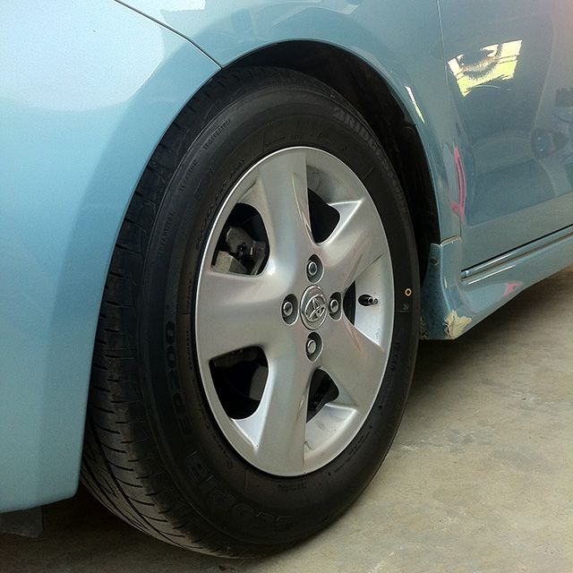

FRONT:
(Right-hand side)
(Left-hand side)
REAR:

The 65 profile offers taller sidewall. (4.7" vs 4.4")
Benefits are much lower noise, vibration, harshness, and better fuel economy.

BTW, your car looks real nice, I have a set of H&R springs and some wheel spacers waiting for spring time. I hope it will look as nice as yours :)

Danke schoen!
I used to ride on 195/55s. Those look and handle definitely better.
But, since I have to work up-country more often,
I should better go with such tire with largest possible sidewall and low rolling resitance.

Your Yaris looks awesome - I love those stock alloy wheels from the mid 2000's - I want a set like that for my 2013 Yaris - Think there is an issue with the tire pressure monitoring sensors and using older rims...not sure but I'm along way off from new rims. Those are beautiful, just fantastic! The blue looks awesome, too - !
