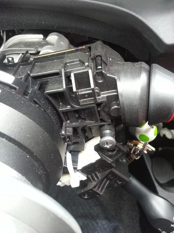

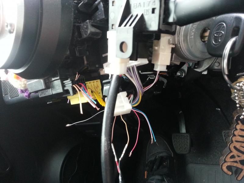

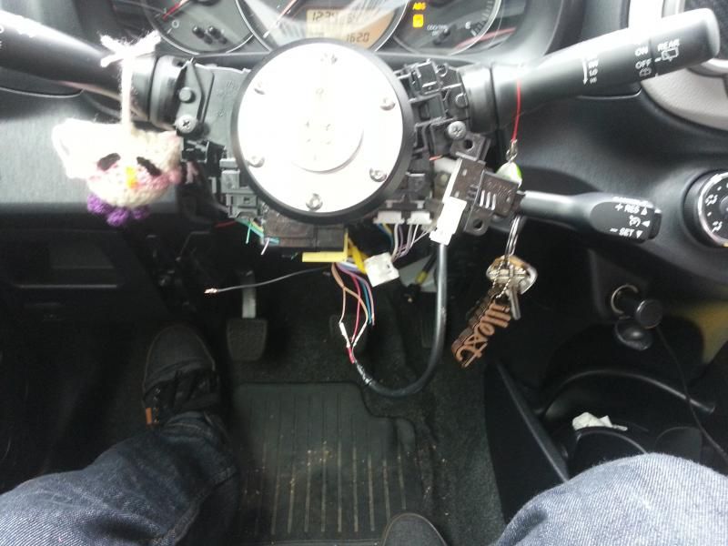

Cruise control: some people are lazy. Like me. Some people also have aftermarket steering wheels so cruise control doesn't work. Like me. But we all know I don't take "Doesn't work" for an answer. lol.
Plastic steering column shroud? DON'T NEED THAT. I screwed the CC into where the shroud screws in for now. I'll modify the column shroud later so that both it and the cc can be used, there seems to be enough space on the bottom right hand side of it for it to fit. I then zip tied the lower portion to hold it still. <3 zip ties.

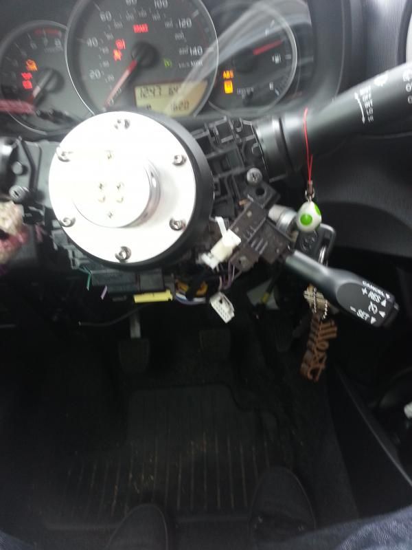

Onto the wiring! There's two plugs that go into the Clockspring from the column: a yellow plug for the airbag, and a black plug, which has the CC, the horn, and the audio controls. Unfortunately it differs from the second gen (according to the walkthrough I found for DIY cruise control, since none of it was the same for me) so I ended up just cutting the entire black plug because I don't have the audio controls, never will. And I can rewire a horn any day, being that it's one wire. so CHOP it goes..I accidentally ripped the horn wire instead of cutting it.

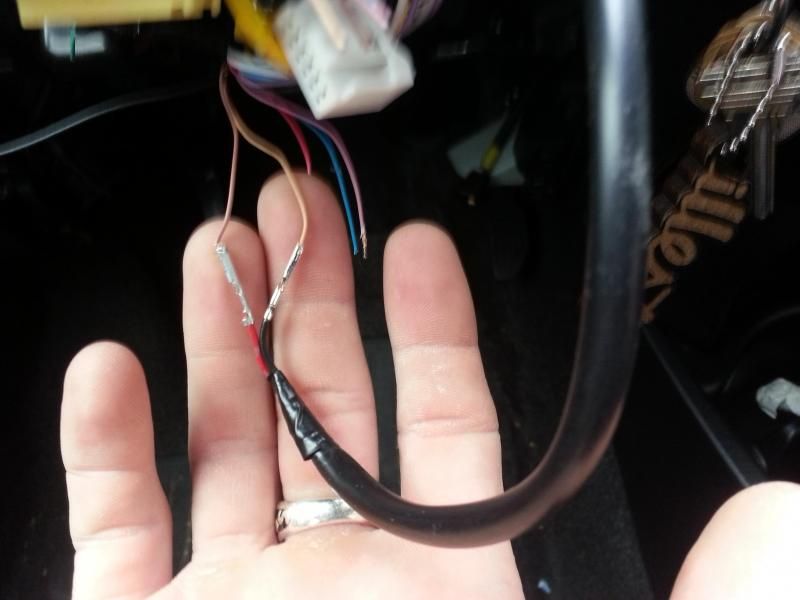

so, since i had no idea at first which wire was what, I started just putting wires into the CC. I removed the plug from the end of the CC wiring harness to get the metal plugs to be exposed, as my first plan was to just plug them into the clockspring harness. that idea failed. Oh well. I started with a blue wire that had a single piece of wire inside. seemed to make sense to me. tried all the other ones, then all of a sudden.....HONK HONNNNK. turns out the thickest wire in there is the horn! I made the cruise control power button a horn. I laughed. I'll just move that wire up out of the way for now. (before all this I found a plug with three wires, and tried that, by pushing the metal ends into it. I found the wiper washer harness. CC sprayed my window. lol. It's not pictured)
So, I kept playing around with the wires. dark bown, and light brown / tan are the correct wires. Dark brown goes to red on CC, tan to Black.
Yay! CC light came on! time to test! slap the steering wheel back on and off I go! It works. after that all I did was clean up the wiring mess and tuck it up all nice and neat. it's not in the exact spot it would be if it was factory, but it's still reachable by your right hand without removing it from the wheel. turned out to be a mini DIY instead of just pics of what I did :p

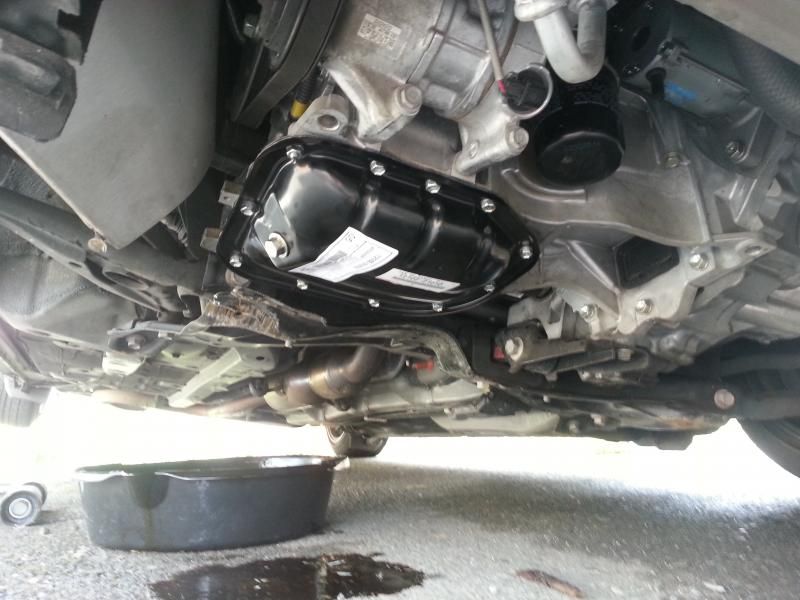

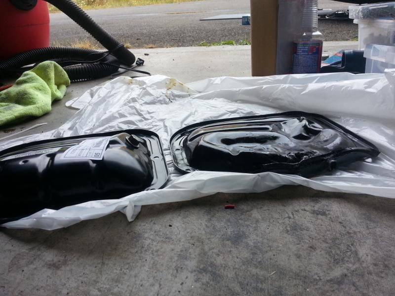

so lets say I put the car on jack stands. I dislike how I was not able to do that, as they're at a friends house.....but that's neither here nor there now :p
Step one: Drain oil. I'll pull the filter off later.
Step two: start removing oil pan bolts. Easy enough, except for one stud (there are two studs with nuts on them, I'm assuming for "make this job easier" when you put a new pan on. that stud had hit the center divider and bent. pulled the whole stud out, replaced with bolt.

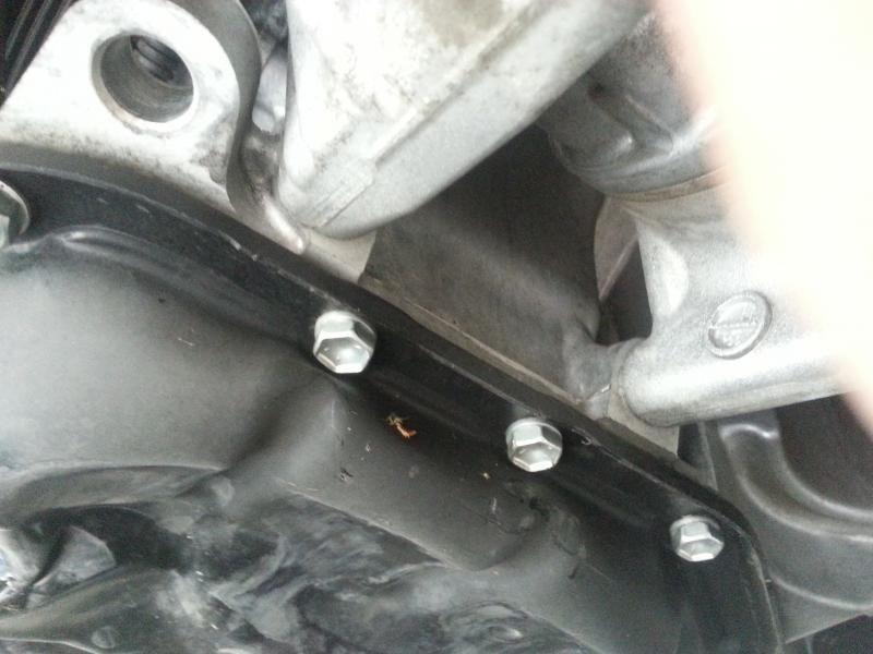

start moving around to the other bolts, easy easy easy....until these two.
Doesn't look so bad...right? How about this angle.

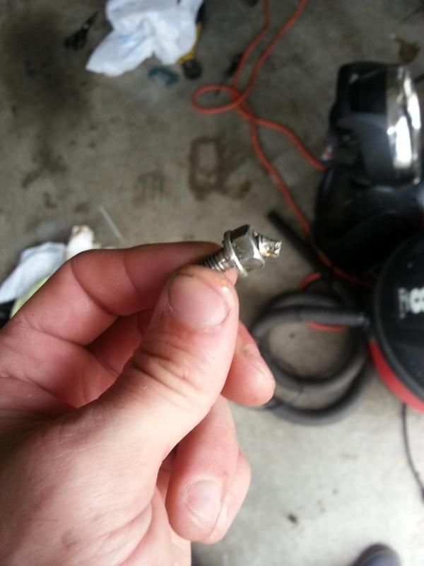

Hmm......Cant get a wrench on it. cant get a socket on it. it's steel, so I cant force the socket on to bend it. My best decided course of action is to try and bend the lip of the pan and then get a wrench on the end. about two hours of that and I gave up on that idea - working upside down on the ground slows me down, okay?!
Hammer mode = engaged. if i cant get a wrench on it the only way to do it is to bend the pan back. All I had was a regular nail hammer, way to light. Luckily I was given a gift card to NAPA, so I ran down there and picked up a 2.5 pound sledge, and some gasket maker while I was there in case I couldn't find my tube I already had.
THOR MODE ENGAGED. Even the almighty hammer of THOR is no match for this dreadful oil pan. I ponder what to do momentarily. tried using a drift to no avail as well. Ponder more.
Drill time. went out on a limb and drilled a few holes around the area that was folded over the bolts to weaken it, still wasnt working to well, tried pliers, more drifts and more Thor, but wasn't working. ended up damaging the bolts so I backed off.
Last ditch effort - bend the entire pan around the bolts. slowly I start pulling on the pan after draining the remaining oil. lucky me, it started bending exactly where I had hoped! In case anyone is wondering why I would do that, if you bend metal back and forth enough it'll crack and tear.
few minutes of that and I heard a scary *POP*. one of the bolt holes an the pan ripped! YAY. then it was easy from there. just spun it to get the last one off. Everything up in the engine looks great. the oil pickup tube didn't get touched. Dry it all off, and put some RTV on the new pan. slapped that beauty back on and tomorrow after it's dry i'll fill it up with oil!
Here's my favorite picture.

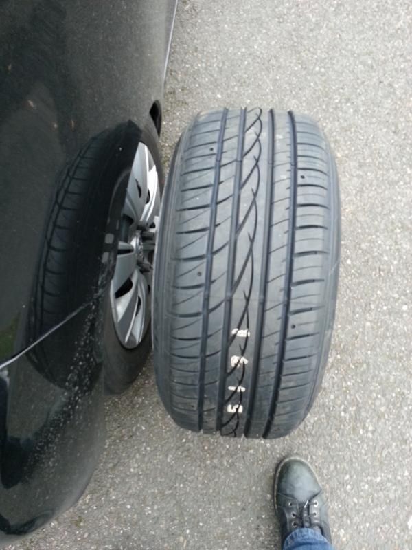

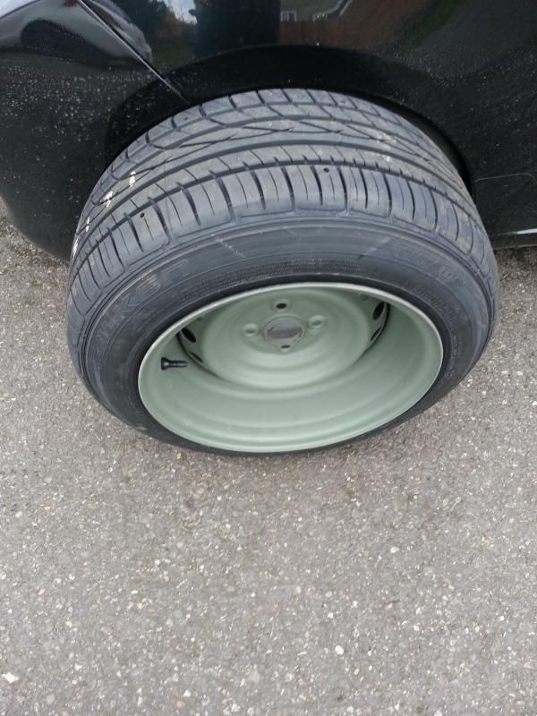

225 50 15. Somehow, this will fit. Somehow. Couldn't do the valve stems on the inside. no matter where I put them they hit something. Sad day lol. These would have been done a while ago but I was trying to paint them when I painted the Z. But the Z is still just primer haha.
