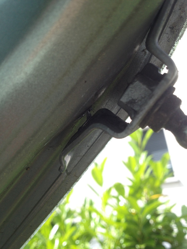

Necroing this thread - I changed the cylinders for new ones that were sold as compatible. Their ejection force didn't seem to be off the charts, at least for a few months the hatch opened *normally* again.
But yesterday, a weld point broke.
The part with the round nipple attaches to the cylinder, and it is welded in two points to the hatch, one of them broke and tore the sheet metal a little.
I'm looking for ways to fix that. I'll call the body shops around here tomorrow, but I fear they'll just tell me to replace the hatch, and that would be a waste.
Any ideas?
sven337 is offline   Reply With Quote
Old 06-14-2020, 06:55 PM   #76
Posts: 5,816
https://www.yarisworld.com/forums/sh...ht=Hatch+strut
Look to the second half of thread where fix was achieved with rivnuts.
