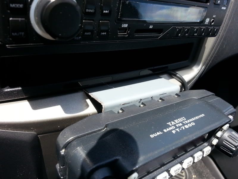

Old thread revived for any other hams looking for a yaesu 7800/8800 install location.
Antenna wire is pulled low in last pic from testing a HT on the antenna and didn't tuck back in. Otherwise a pretty clean setup. Still need to paint the bracket to black or possible silver to match bezel. I debated about putting the main radio box under the seat but it muffled the audio too much for my liking in case storms or tollway use. Knees don't bump the radio either and I'm 6ft. Left storage pocket left of HVAC controls works great for mic holder.
