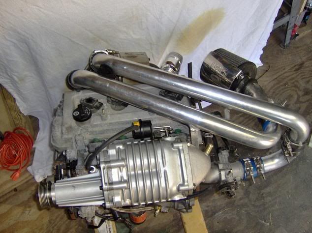

Tamago is officially an
Did you not graduate from Grade School, because you don't read very well.
vettereddie's last post
"Yeah, the intake temp is what I saw was the biggest issue and why the twincharge varient is NOT happening. If a new manifold was done after the supercharger that had a air-to-water intercooler built in, then it could probably work. Alternately, I could have used meth injection, but on a daily driver that would be a pain to keep filled. "
and on page 3 he elaborates on his reason for not twin charging
"Simply put, the incoming pre-pressurized air would be at elevated temperature. The compressor rotor lobes are metal and do undergo thermal expansion. If the intake temp is too high, they will expand out of tolerance and hit instead of mesh, locking the compressor. Also, methanol can not be injected pre-s/c to cool the rotors because it could displace the oil in the sealed bearings and dry them out, damaging the compressor shaft. Elevated temperature could also de-laminate the anti-friction coating on the lobes, creating a FOD issue in the compressor, or worse, get pulled into the cylinder. "
it had nothing to do with whether it was "worth the time/money/weight"
congrats Tamago, you officially made an ass of yourself.

wait wait, so i just read what his reasoning was...
sounds like twin charging was a bad idea.
hmm maybe in your head this:
translates into it being a good idea?

that appears to be a bad idea.
i never thought running the boost from the turbo into the s/c compressor was a good idea in the first place. i was considering a manifold that would allow the boost from the turbo to bypass the compressor altogether.
whatever they did is a good idea, if it wasnt a good idea they wouldnt sell it.
