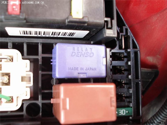

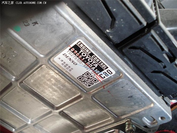

more pics about Chinese Yaris engine:

Look at the first page of this thread for links that show the installation of the OEM cruise stalk. From your pictures, you don't have the 1NZ-FE engine, which as far as I know, is the only one which has the ECM preprogrammed for cruise control.
