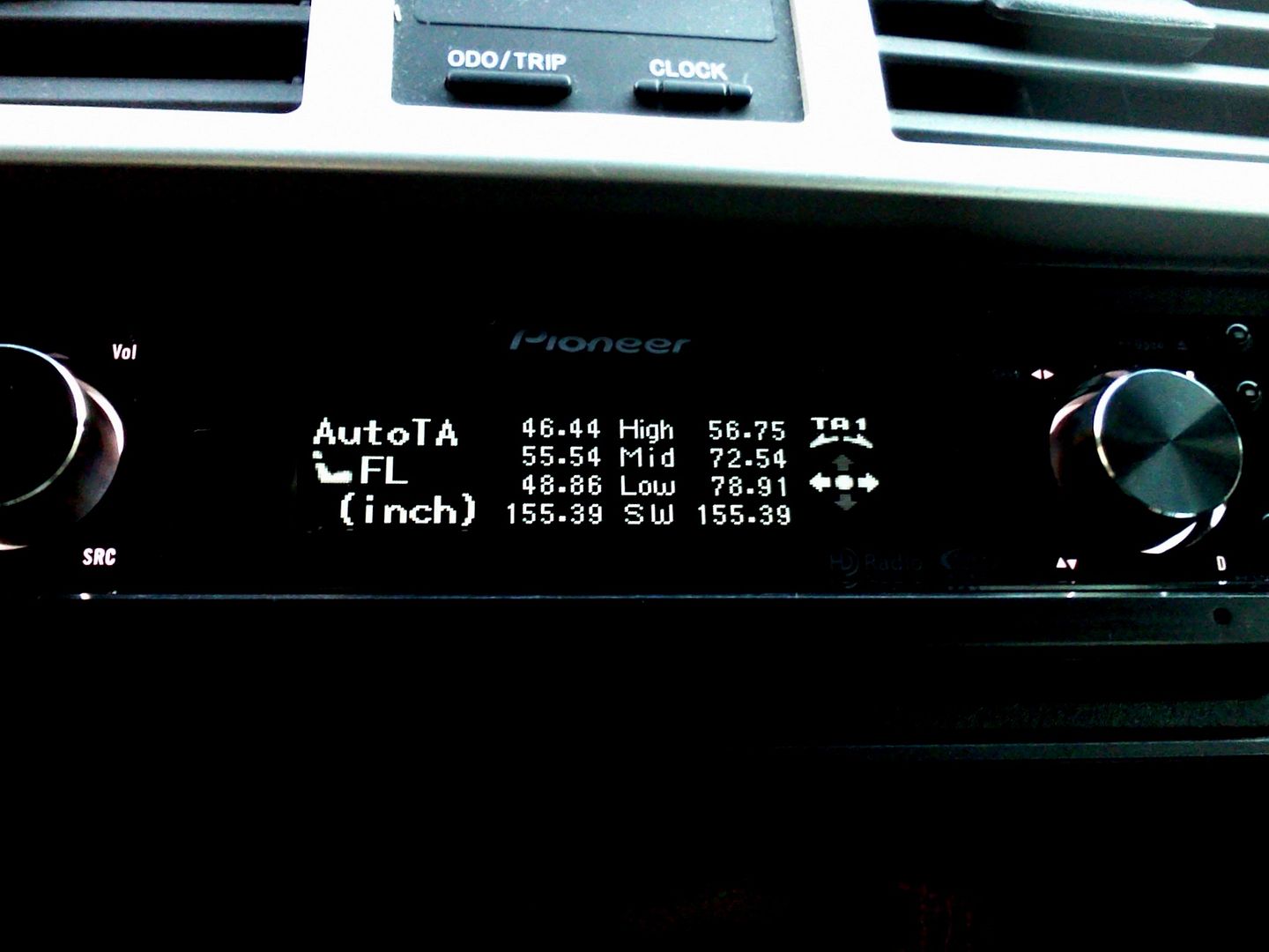

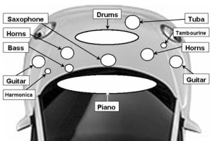

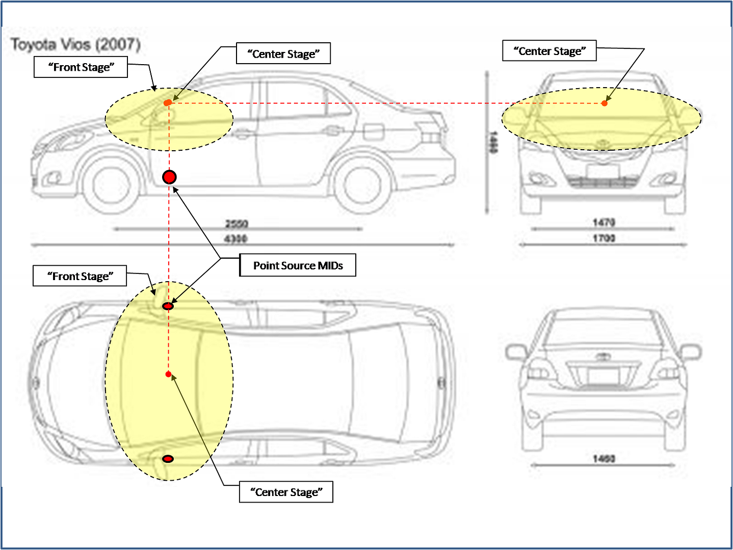

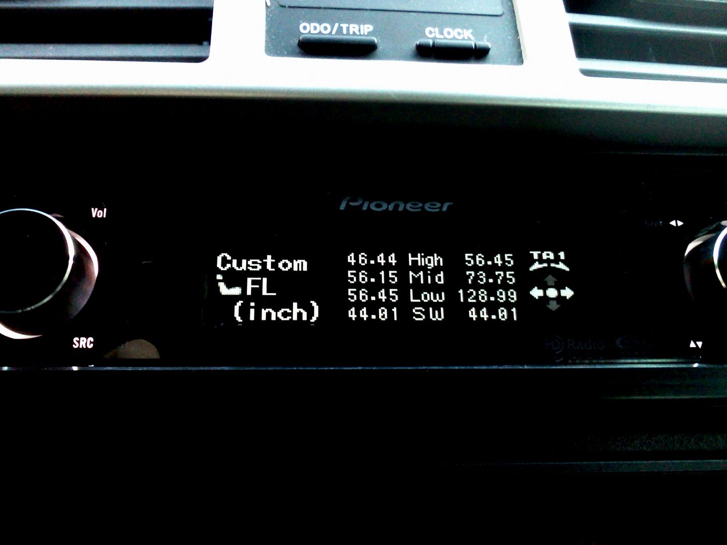

1st image: very narrow stage, image no good
then...
2nd image: better image but still narrow stage
and now...
3rd image: sweet!
1: very narrow stage, image no good
2: better image but still narrow stage
3: sweet! the BEST so far for me.
